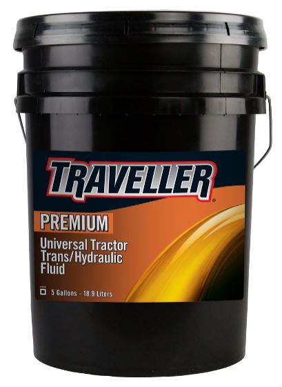

Pulling up an older thread as I prepare to take possession of my new 5220R. When looking for premium tractor fluid, Tractor Supply seems to have an option. Can anyone comment on their fluid?
Traveller Premium Universal Tractor Trans/Hydraulic Fluid at Tractor Supply Co.
Their site doesn't list much about the fluid, but I found a reviewer who posted this:
Recommended for the following applications:
Abex/Dennison HF-0 all pumps, HF-2, HF-1 Agco Power Fluid 821-XL Allison C-2, C-3 and C-4 Allis-Chalmers Power Fluid 821 Belarus Deutz-Allis Power Fluid 821 Case HY-TRAN Ultra (MS-1209) Case HY-TRAN Plus (MS-1207) Case TCH Fluid MS-1210 (JIC 145) International Harvester HY-TRAN B-6 Case TFD Fluid (MS-1204, JIC 185, 144, 143, B-5) Case TFD II Fluid (MS-1205)Case PowerGard PTF Fluid (MS-1206) Caterpillar TO-2 Case MS-1230 (High Pressure Systems) Dresser Construction Equip. Division Fiat John Deere HYGARD Fluid (JDM J20C) John Deere 303 Fluid (JDM-J20A, JDM J14B) Ford New Holland M2C41B, M2C48C, 53A, 86B, 134D, C, B, A Hesston-Fiat Oilofiat Tutela Multi-F AF-87 Grove Manufacturing Hydraulic Fluid International Harvester HY-TRANS Plus (MS-1207) Kubota UDT Fluid Kubota Transhydraulic Fluid Landini Tractor II Hydraulic Fluid Leyland Mahindra Massey Ferguson M-1110, M-1127A, M-1129 Massey Ferguson M-1129A, M-1141 Permatran III New Idea Power Units Steiger Hydraulic Trans. Fluid Sems 17001 Sperry Vickers M-2950-S, I-286-S Sunstrand Hydrostatic Trans. Fluid Valmet Versatile Gear and Hyd. Trans. Fluid Spec. 24-M, 23-M White Q-1705, Q-1826 White(Oliver) Type 55 Fluid (Q-1802) White Farm Universal HTF Fluid (Q-1766, Q-1766B) White Multipurpose Tractor Oil (Q-1722) Yanmar
Does this appear to be a good option for the Branson Transmission/Hydraulic needs?

Thanks Texasmark. It appears the premium fluid at Tractor Supply specifically calls out J20C as a compatible fluid. Good news since I can obtain this locally.
   / Transmission fluid for 4220 #17
That's what I use. Didn't want to opinionate you.....let you make your own unbiased decision. Grin I'm of the opinion that it's blended and packaged by Warren Oil Co, big coast to coast multimarket lubricant supplier. They have a www. I don't remember exactly but some fluids have their name on the back of the container rather than the words "Packaged for xyz company" and not mentioning by whom, like WW for example.
