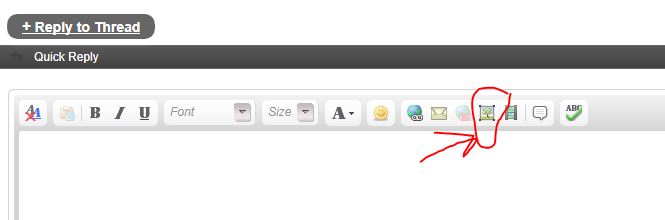

Sorry- I'm really new to this and haven't taken the time to figure out how to send pics etc. Second gear has a missing tooth and I am trying to replace that and several other worn gears. It seems I need to dismantle the entire housing to remove the main shaft of the transmission. I'm stuck at removing the axle housing from the differential, spider gears etc. The axle housing has come out 5/8ths of an inch but the shaft won't come all the way out of the spider gear. I could email a picture or tell me how to attach one...
   / Transmission Gear Removal Jinma 354 #7
Click here and follow instructions

It's an image of the tool bar where you write replies like I'm doing now. The image I showed is the little box on the tool bar that allows one to post images. It wasn't intended to be a point and click.
