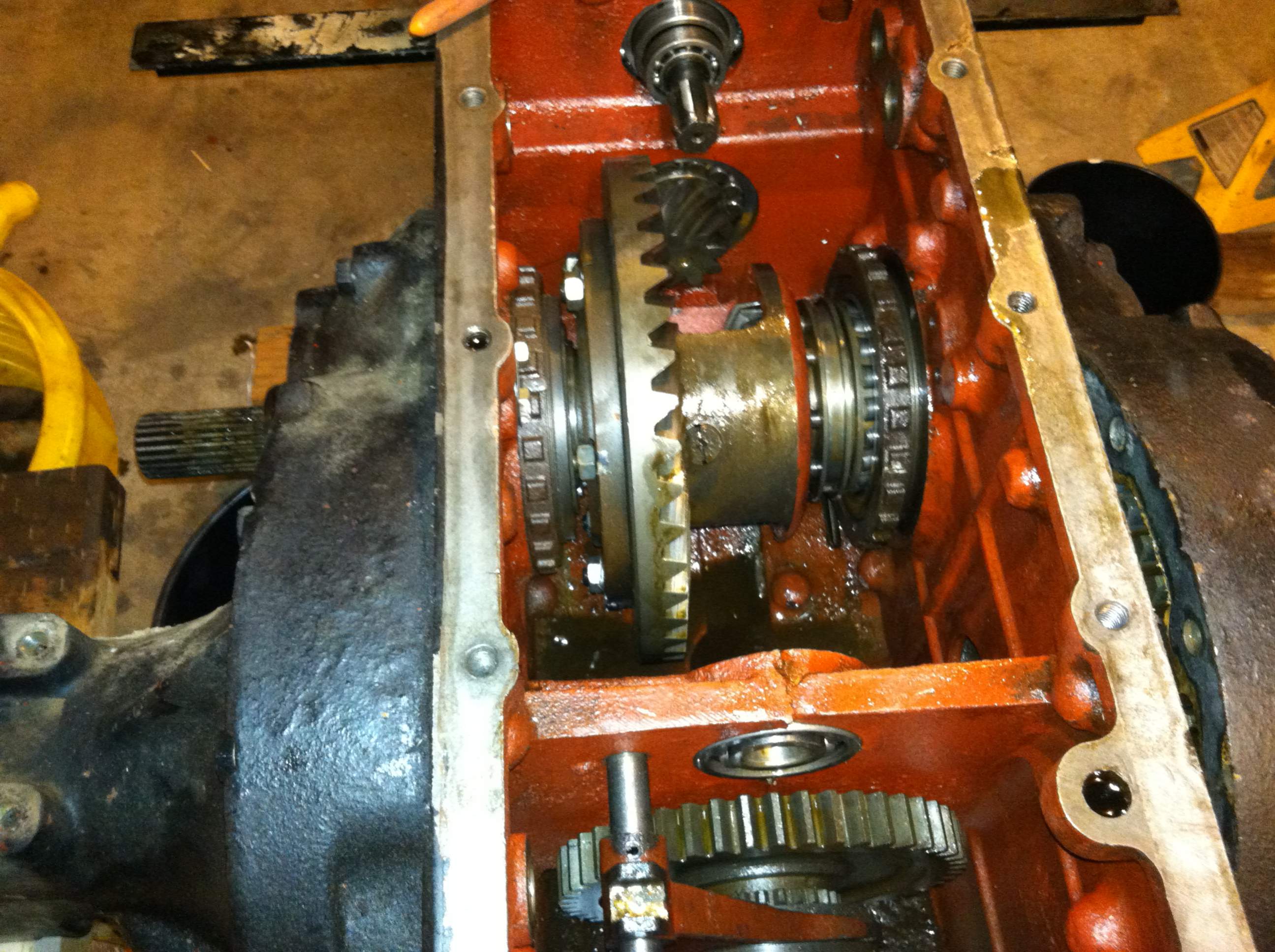

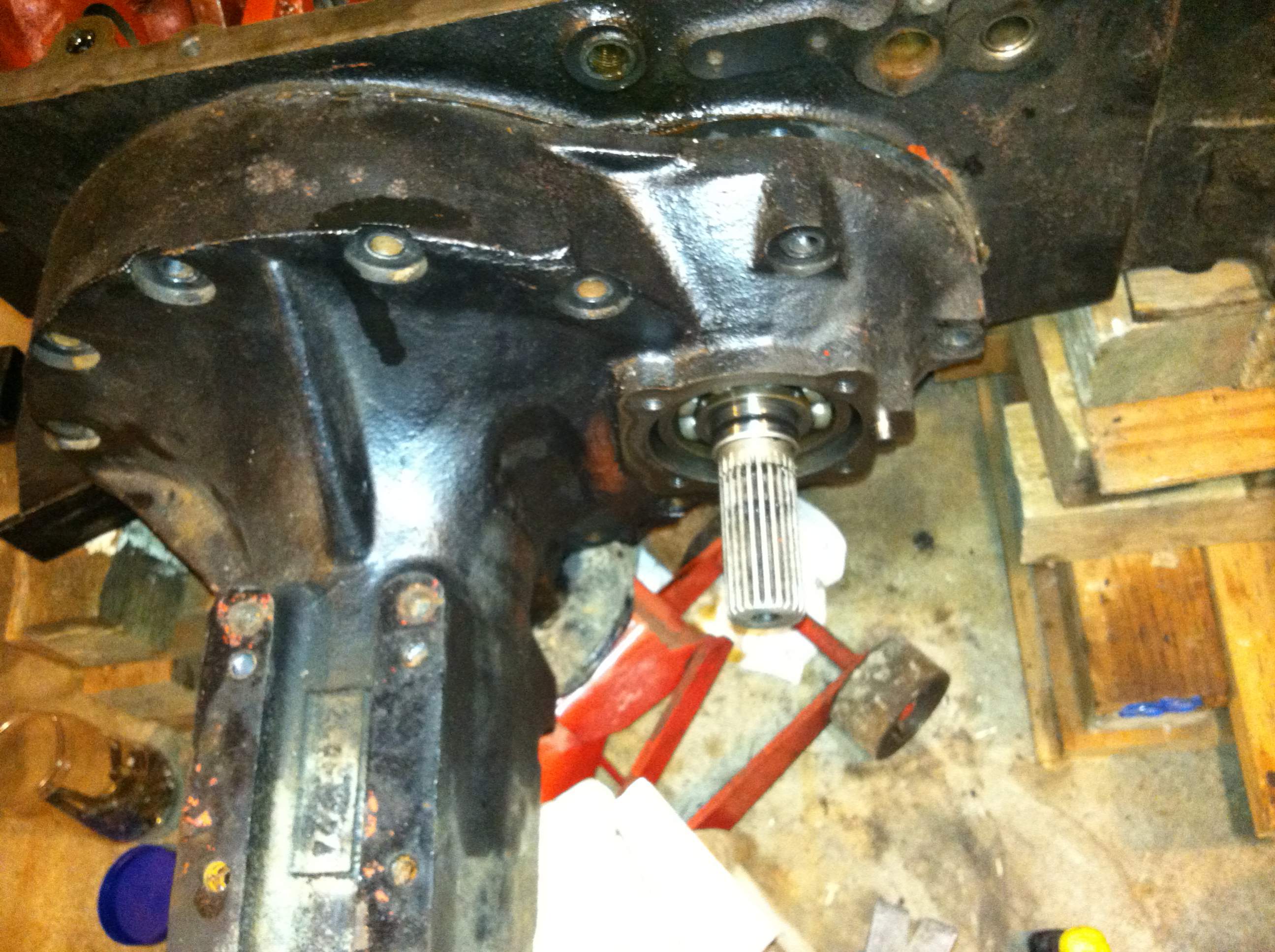

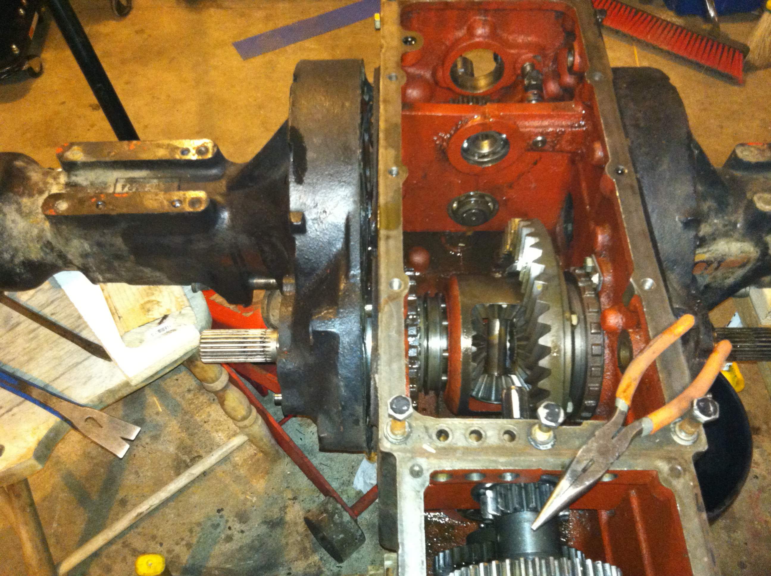

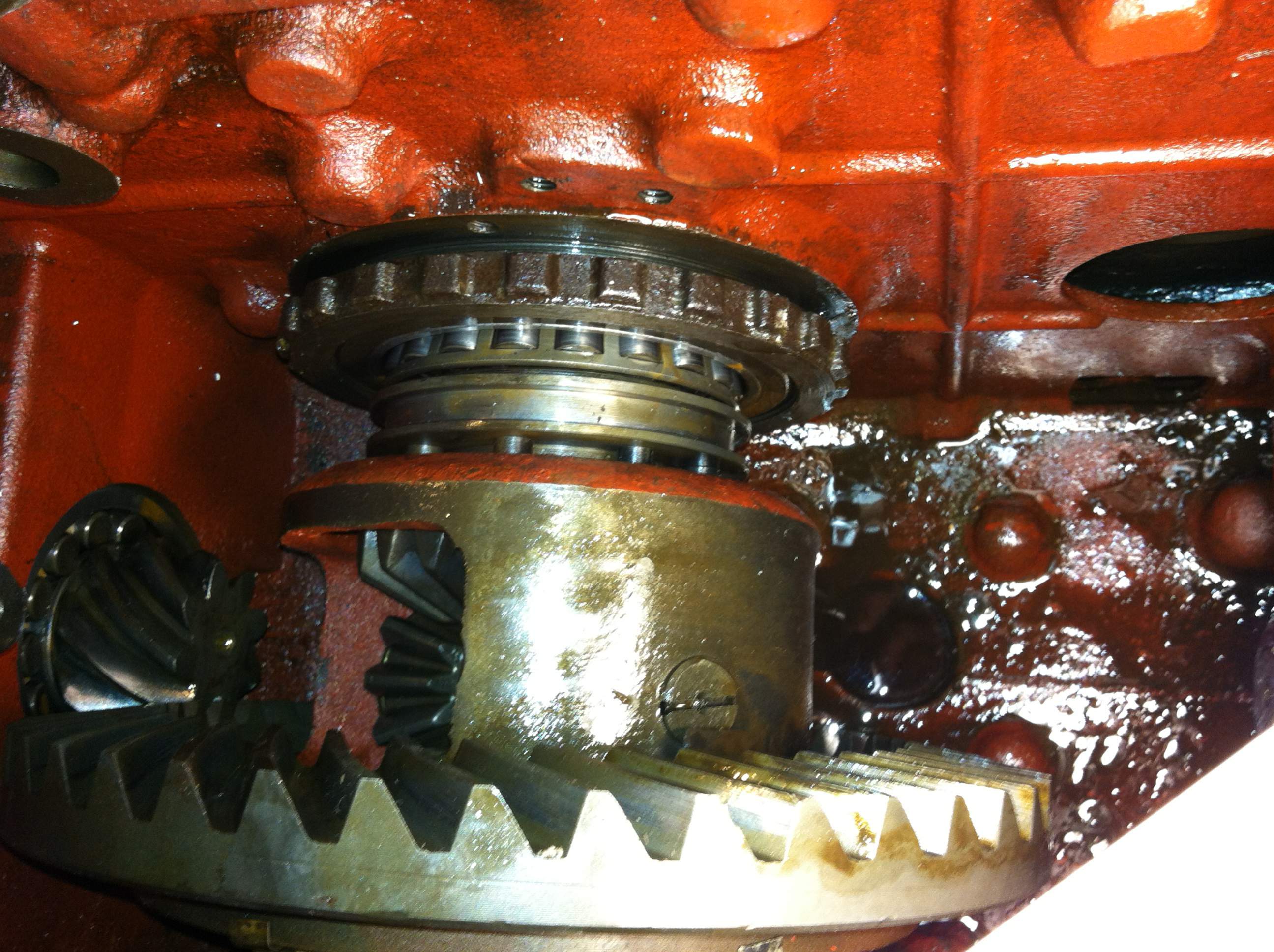

I hopes this works--Here is where I am at- It looks like the axle housing/ shaft should just pull out of the case/ differential gears- came out 5/8th's of an inch but no further. Can't understand why. Since I took the picures I purchased Casing bolts that are 1-1/2" longer to keep everything aligned in case it was binding but that didn't help. Good idea for safety though- it's very heavy and I working alone. I just ordered a parts manual from Circle Tractor- I've gotten pretty far considering and it has been fun- but now I need to get it fixed

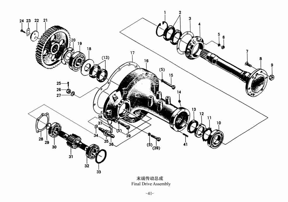

   / Transmission Gear Removal Jinma 354 #16
Thanks for the picture! Trouble is I can't get to that part unless the differential assembly can be removed- Doesn't look like it but I will try. Can you post that blow-up?
