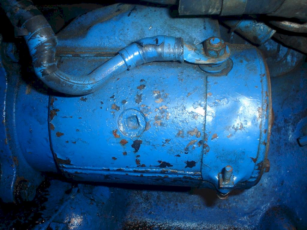

I recently purchased a 1964 Ford 3000 Gas tractor. Had to do some minor repairs to the carburetor and it now runs great. We added some transmission fluid today and when we started it back up a small stream of transmission fluid under moderate pressure streams from behind or under the starter. Upon inspection, there is a small seemingly drilled hole in the starter. Can someone tell me if this is an overflow, missing screw or a bad problem ?

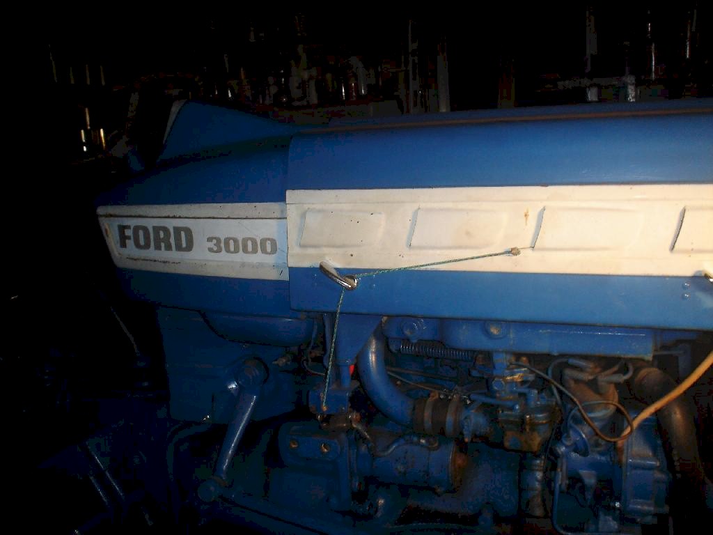

post pics of the machine, the leak, and the starter

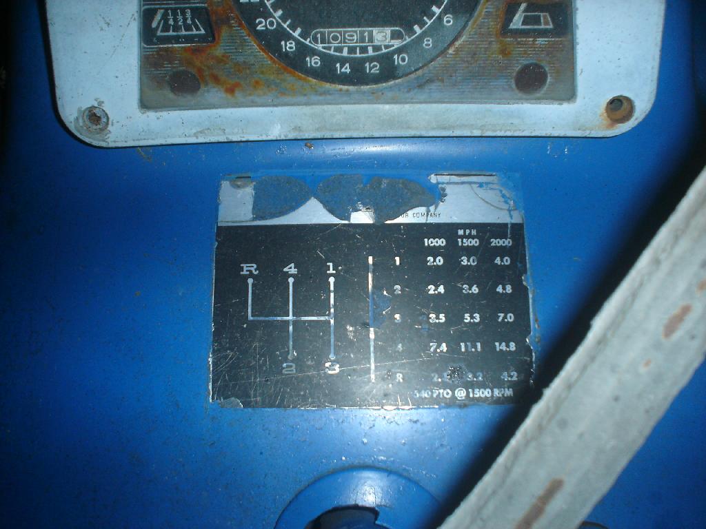

I typo'd the year (sorry) it is a 1966 (6M21B). So it is a 3 cyl gas with a 4 speed transmission.
Here are the pics you requested.

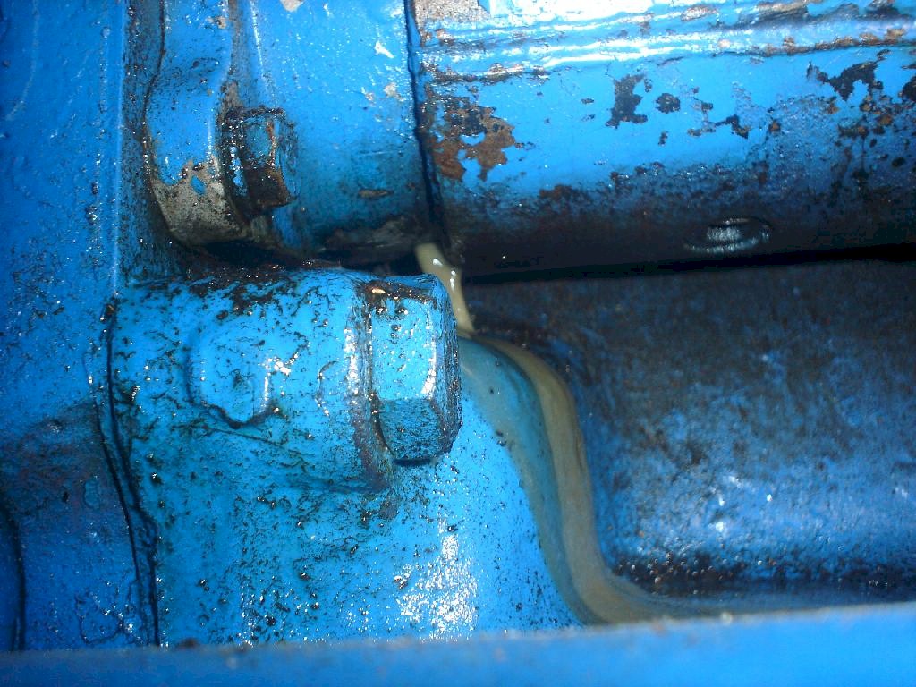

that is some pretty nasty emulsified looking oil you are pumping out the starter mount flange there.
soon the starter will burn out.
first thing you need to do is unclog the bellhousing drain at the bottom of the trans bellhousing.. with oil coming out the starter.. I'd have a bucket ready.. you likely have a gallon in there...
clutch is likely soaked.. it CAN swell and ruin.. but sometimes you get lucky.
not.. if it really is draining trans oil that fast, input shaft seal may be gone.
double check that you are loosing tranny oil and not diffy/hyd oil.

he gotta get it out of the bottom of that housing to save that clutch though.. the flywheel is already pumping it out pretty high!

Thanks so much for the excellent and quick information. We immediately drained all the fluid so the clutch was only soaked a couple of hours. Figuring it was beyond our mechanical skills, we called our local Ford mechanic the next day. He said it was the seal so we took it to him and he is working on it now. Luck was with us, the clutch is ok. Should have our 3000 ready to hog by this weekend !
