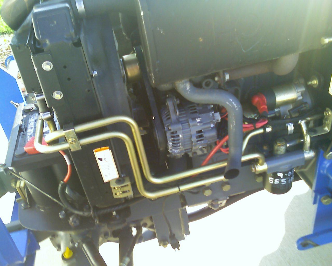

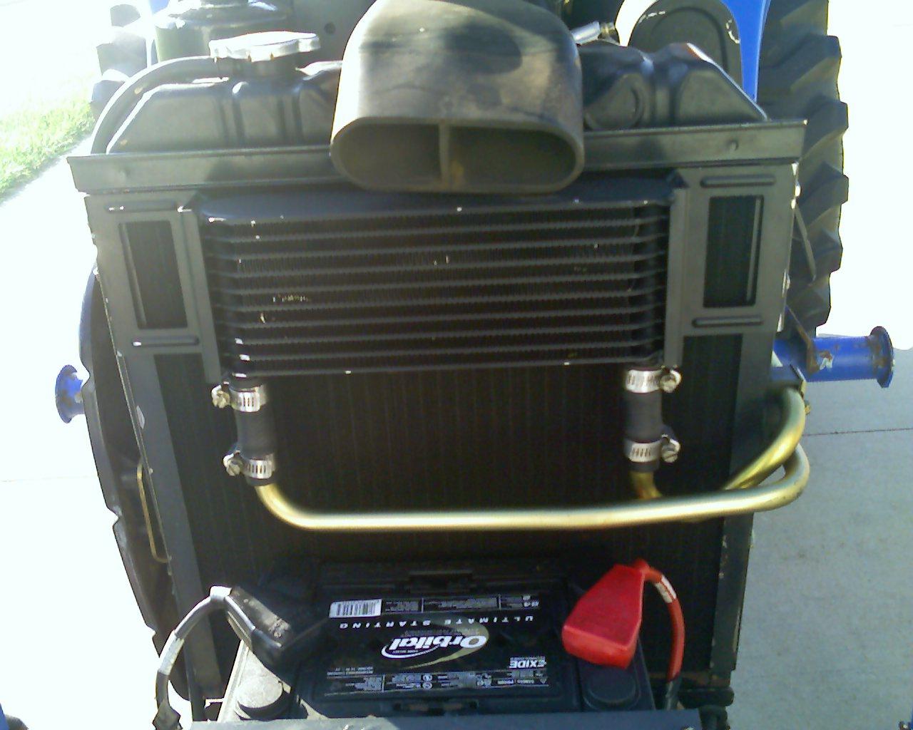

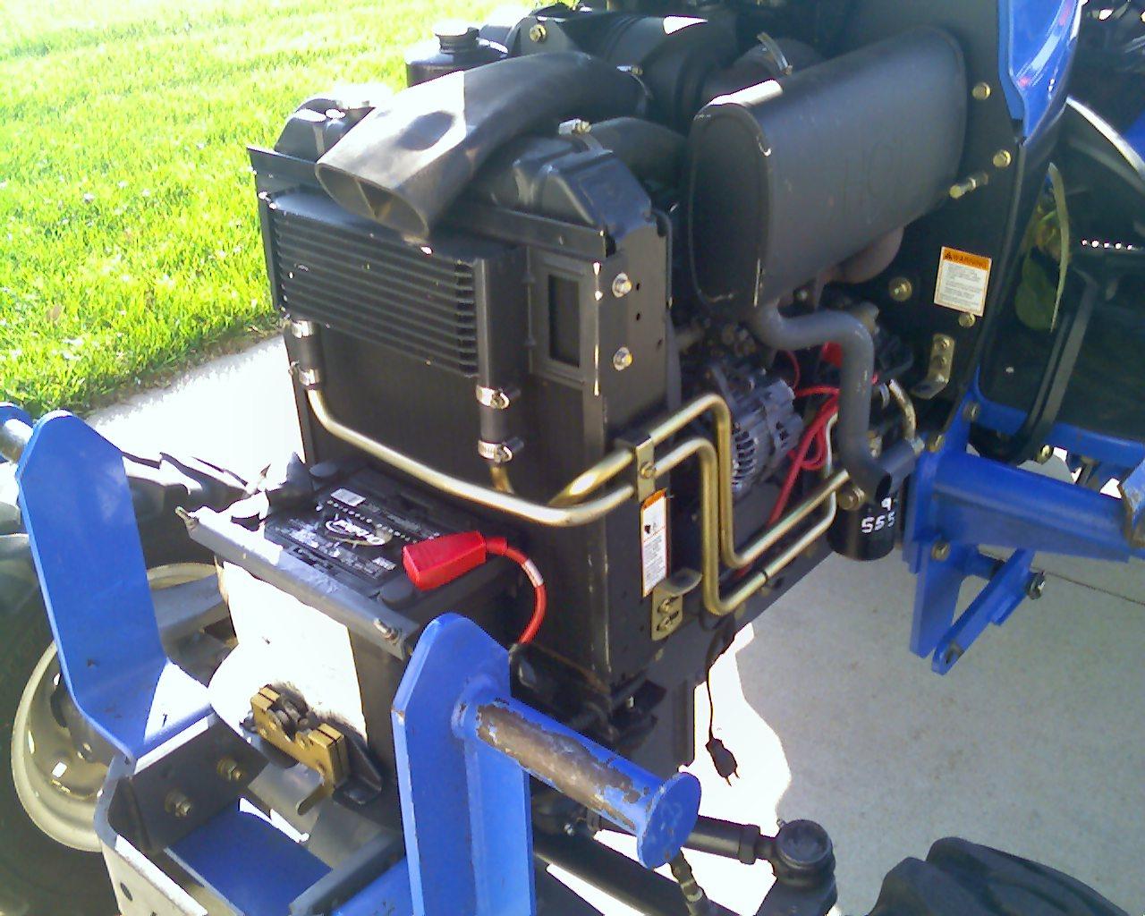

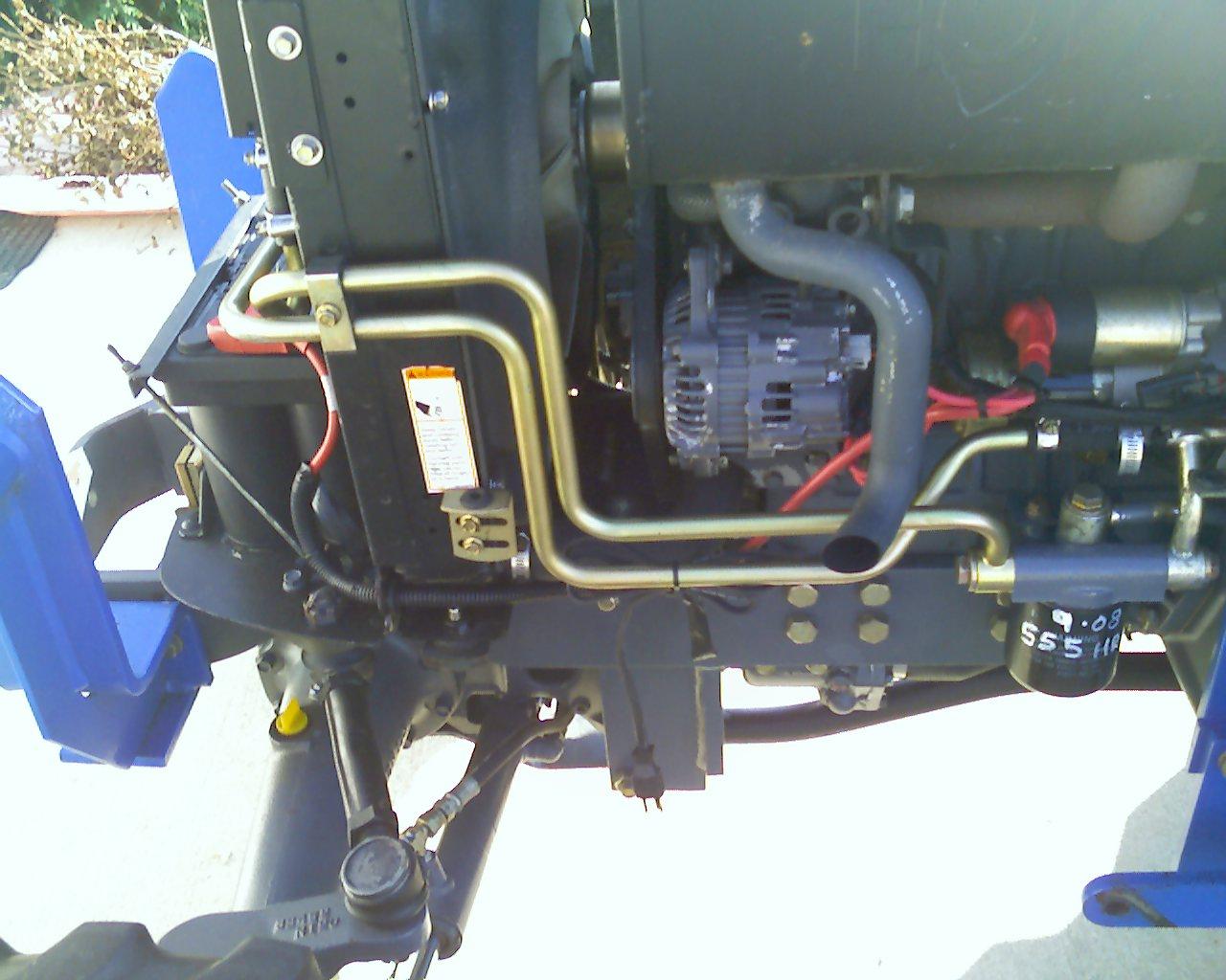

   / transmission oil cooler hose leak #7
I will bump this for those of you wondering what the kit looks like when done. You can buy the kit and do it yourself as it is pretty easy. However since mine was in the shop for other reasons I just had them put it on. They charged me roughly $80.00 installed.
This eliminates the 90 degree bends where the hoses deteriorate.
