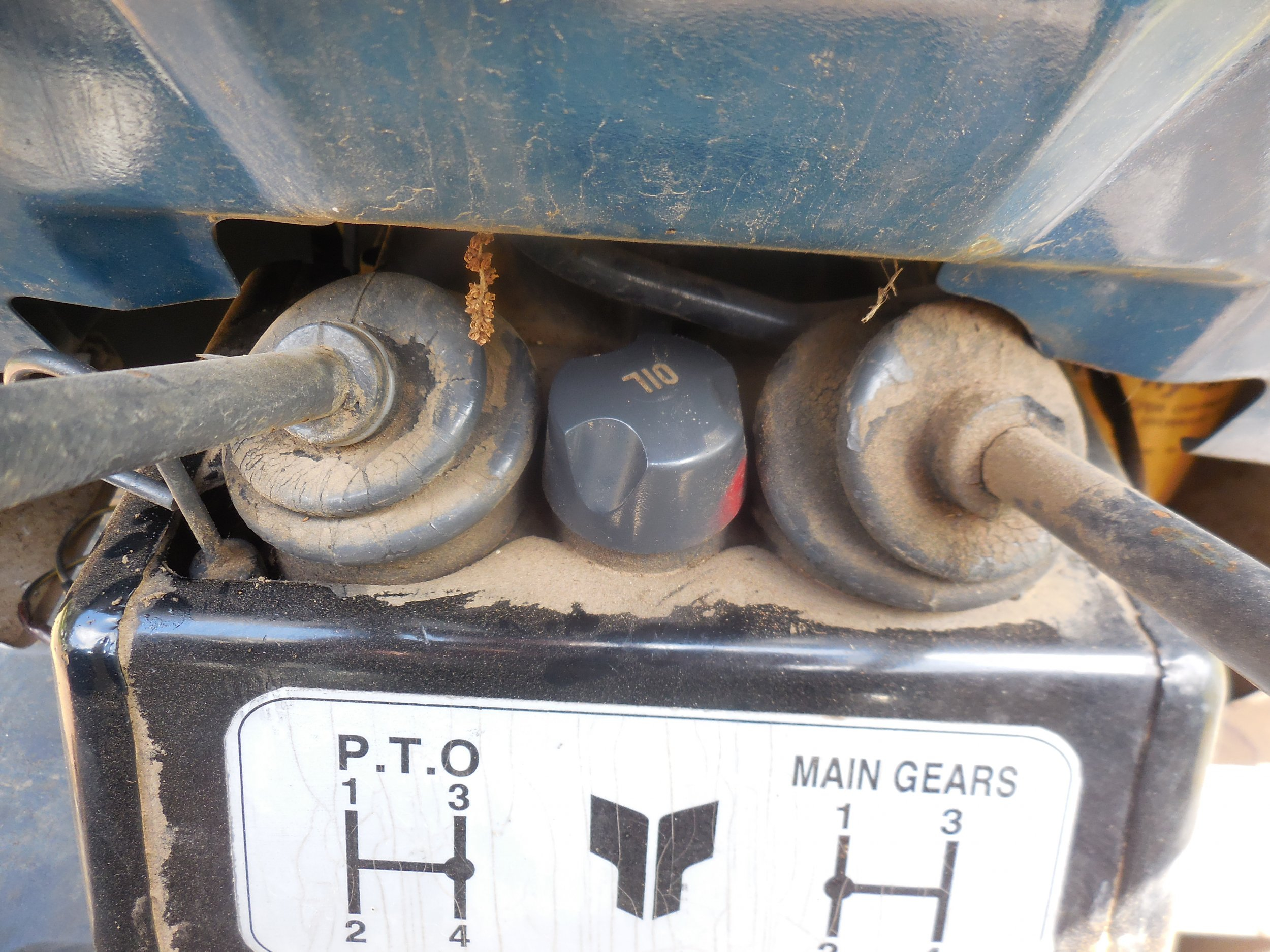

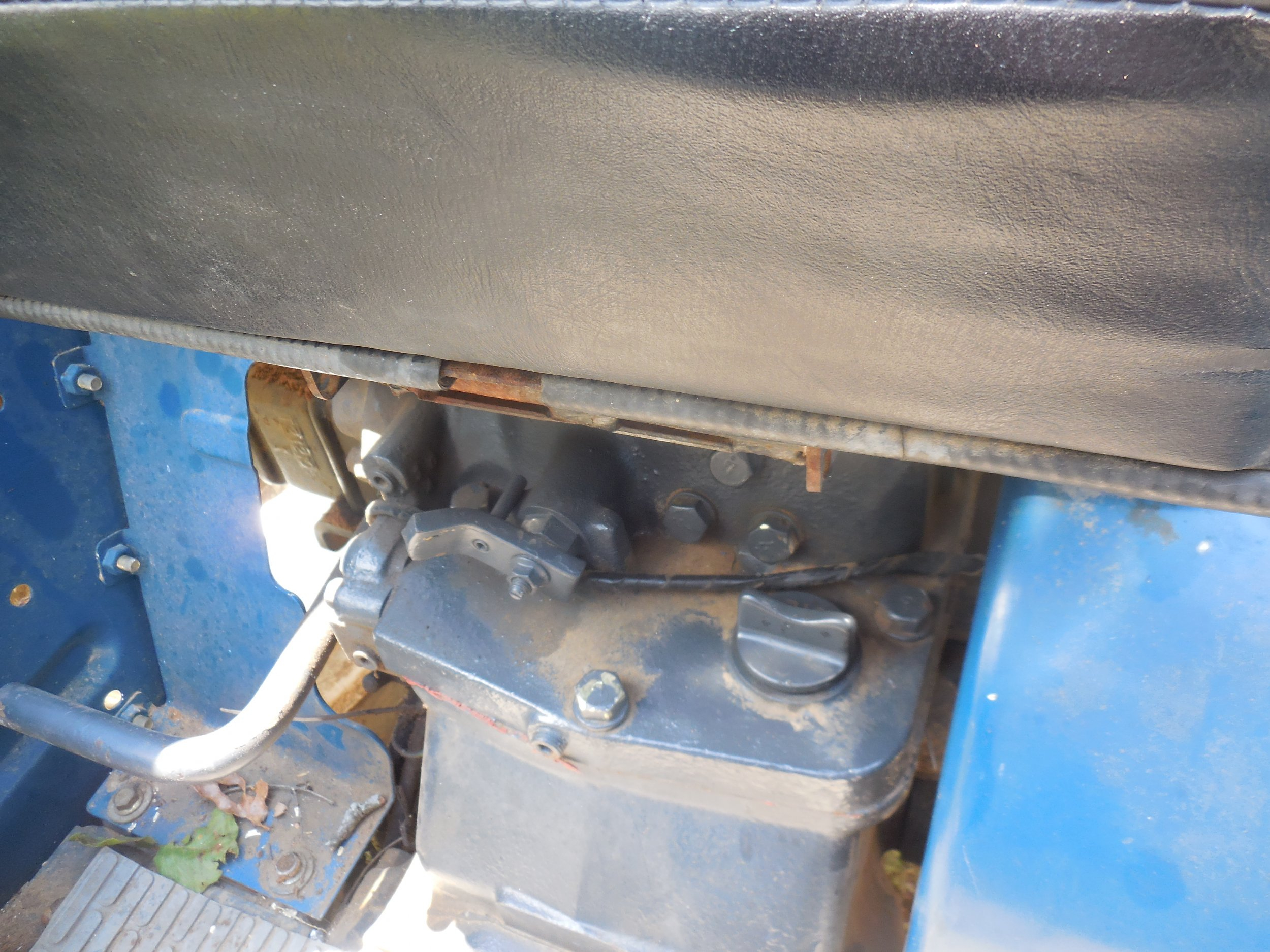

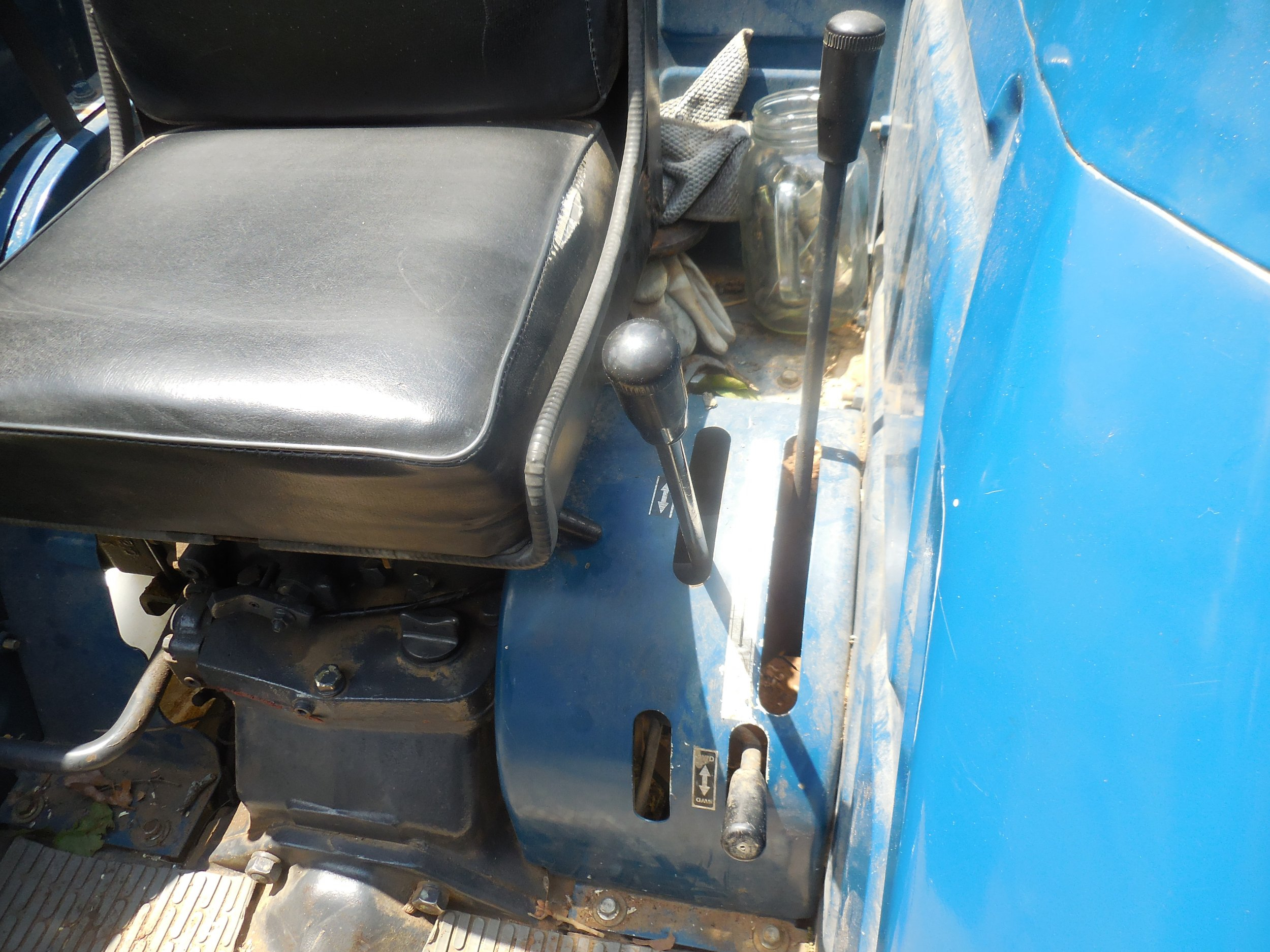

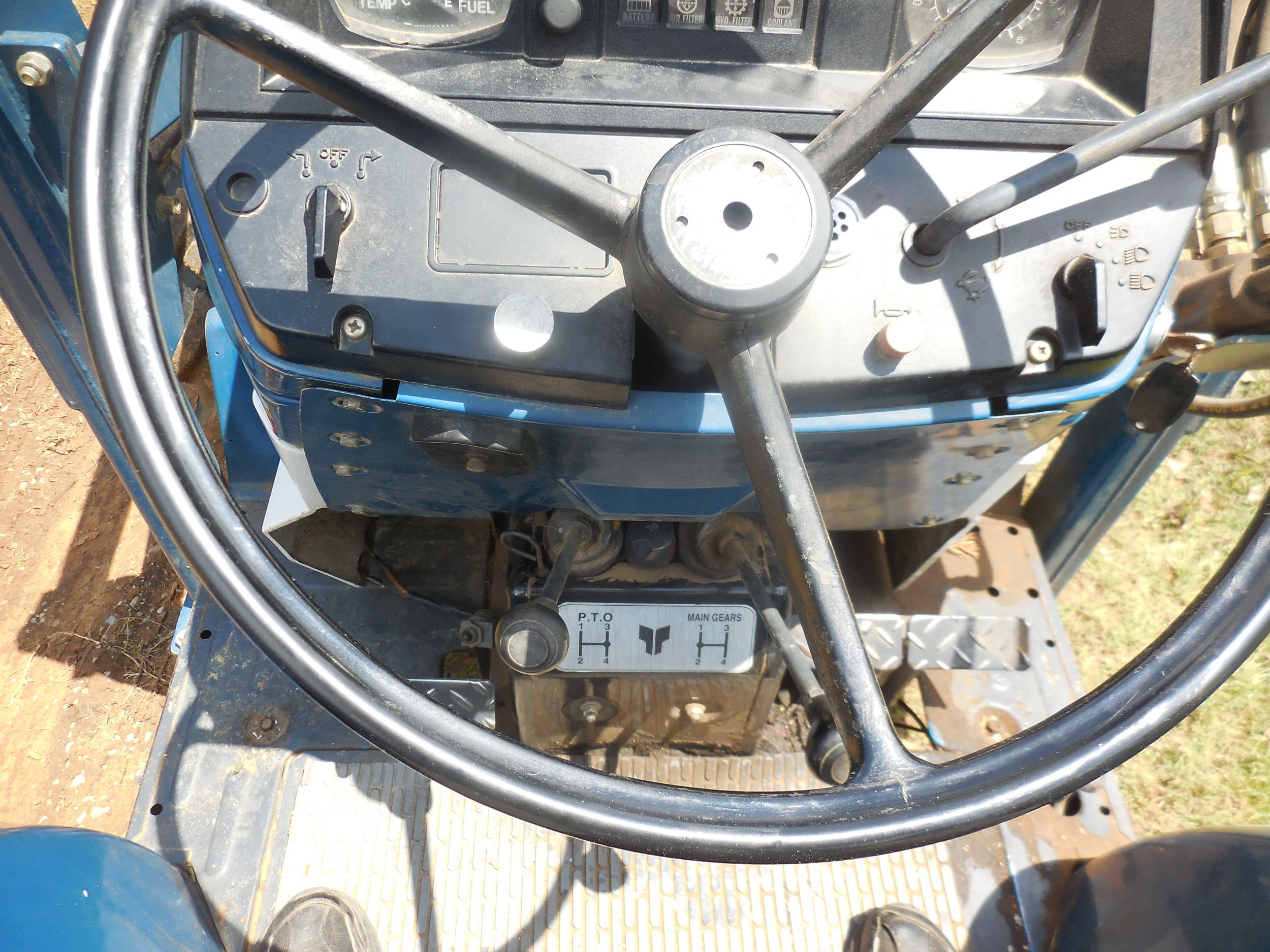

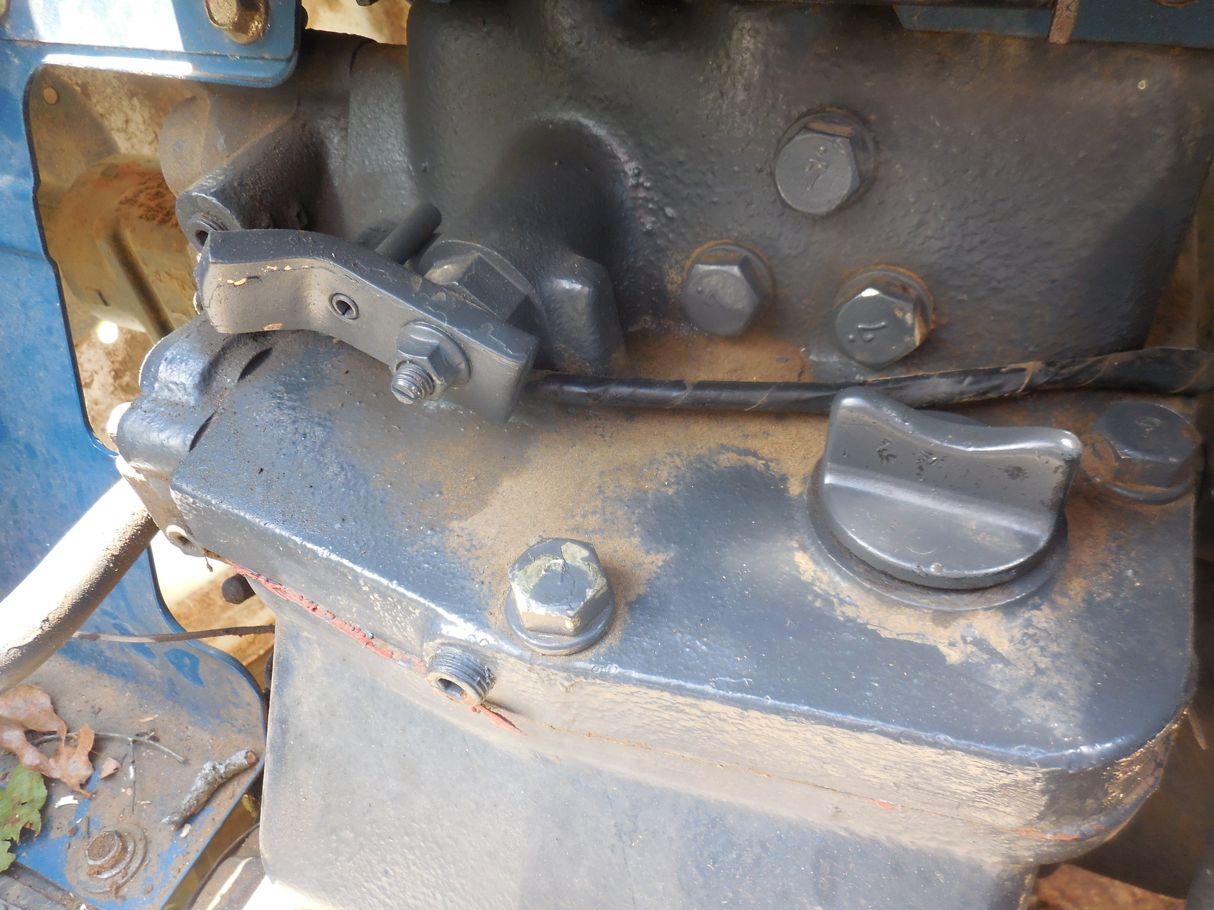

Under the seat is a dipstick that says OIL, what kind of oil does it require, motor oil or hydraulic oil and what weight.
Where do I check and put hydraulic fluid.
Thank you

Not same model, but have Mutsi Mt180D.
On top of shifter box, right front, I have a rubber plug that serves for dipstick as well as filling.
I made me a wood dipstick that I calibrated after I did a fluid change.
As to oil, use any standard hydraulic fluid and your CUT will be happy.
I used 30 weight.
