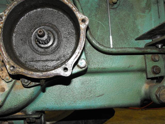

Appears over filling on my tractor is not a good thing after all. I noticed a couple of days ago that the brakes weren't working all that well. Took more pressure to stop the tractor than usual. Got around to pulling the brake covers today and found both sides were filling up with transmission oil.
So I held the dipstick against the side of the transmission to see just where the normal level would be on the brake shaft coming out of the gear case and guess what, it is at the bottom of the shaft. Appears when I filled it to the top of the shaft (about 3/4" over full) it caused the shaft to start pulling oil through the seal when it spins. Up till now the brake housing has always been dry and even a little rusty. Now it's nice and oiled up! I guess these type of seals work ok to keep out a little splash oil but not submerged.
Figured now would be a good as time as any to replace all the bearings, seals and hardware.
