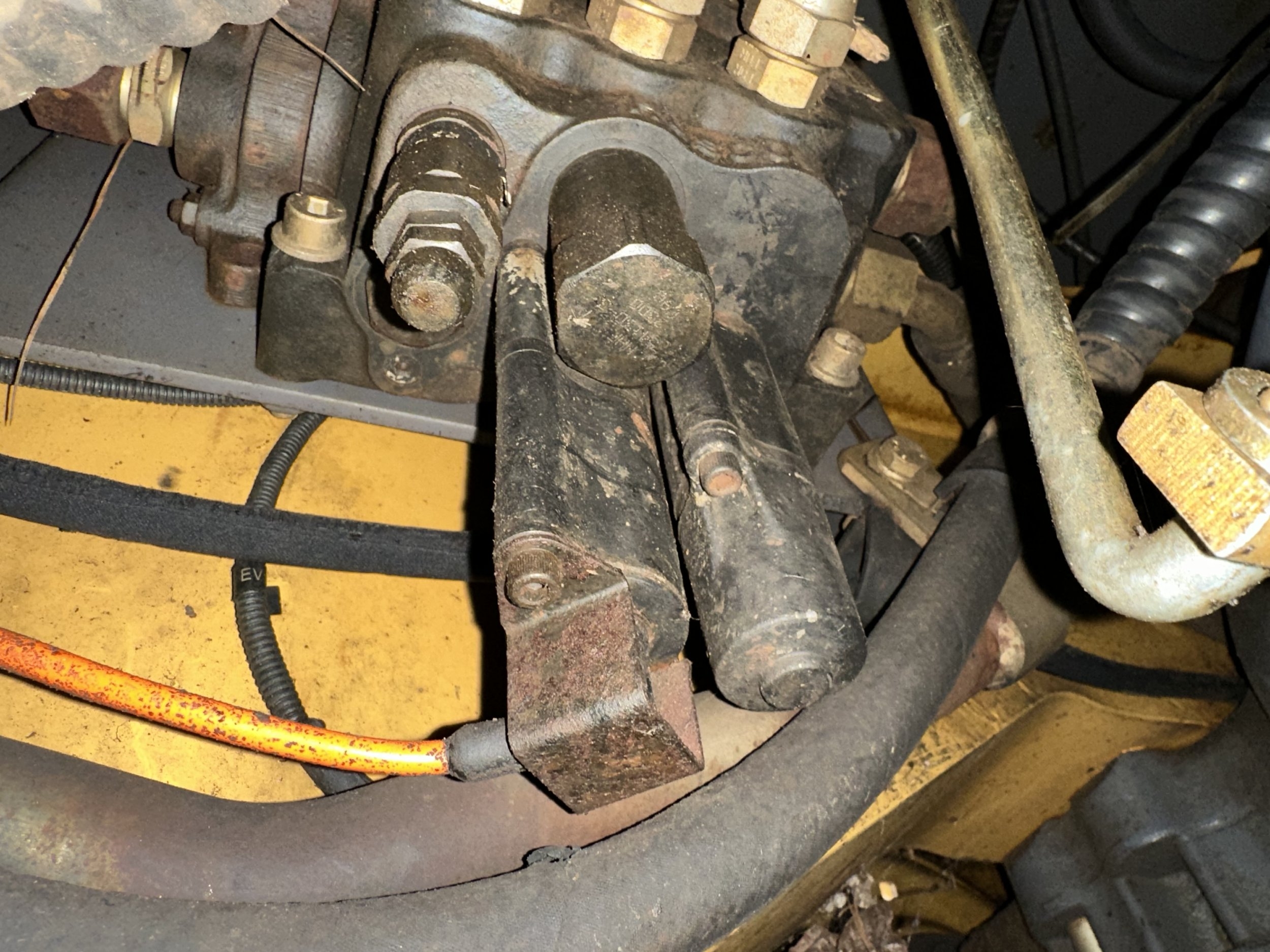

Just getting back to this project and trying to find the shuttle valve so I can check volts and function of the fwd / rev solenoids. The manual says the shuttle is on top of the transmission. Does that mean I have to come in from the top to see it? Under the cab floor panel maybe? Thanks to anyone who might know. It’s a New Holland 555E.
I thought for a second this might be the shuttle but it doesn’t look like the (very poor) diagram I have.

That's the loader valve. Here is a diagram showing the shuttle valve, on top of the transmission. I believe access is through vab floor panel.

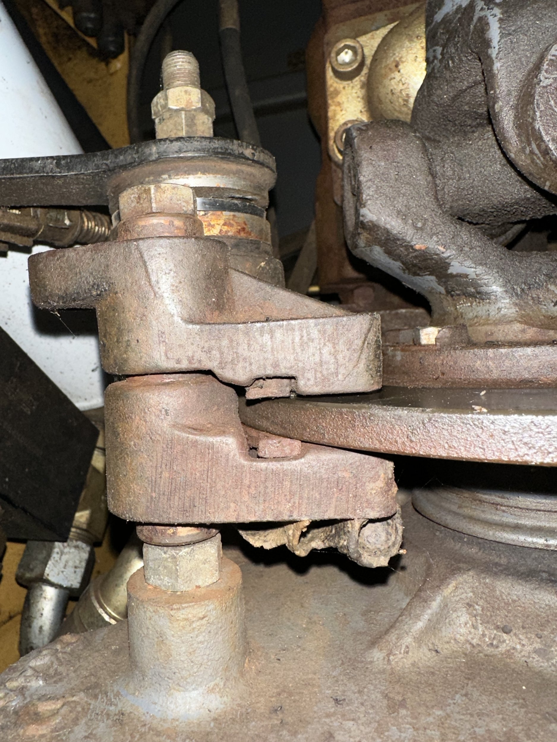

Thanks for the replies. I laid up under it studying everything. The parking brake mechanism all looks fine. Will update.
I’m just trying to get a good trouble-shooting approach. The first thing I did was clean the transmission filter screen, change the fluid, and the spin-on filter. The fluid is still cloudy so that may be a problem. (You can only change a portion of the volume.)
Hoping to move on to electrical trouble-shooting at this point. Thanks again
