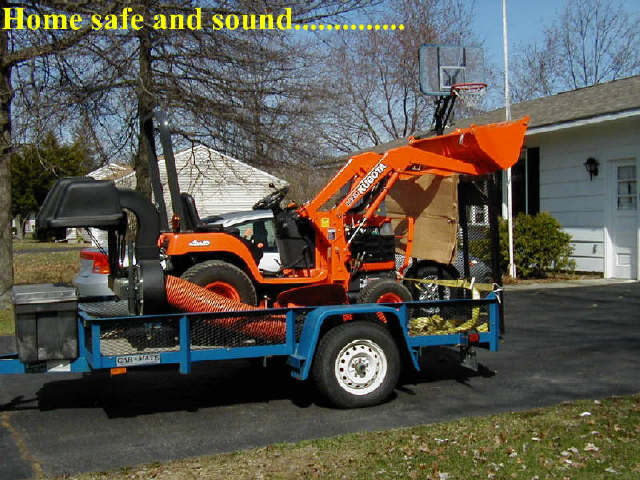

I have a similar issue I am wrestling with for my new BX1800. I have a 6 1/2' x 10' utility trailer with drop gate. It is a 3000 lb (~2300lb payload). I brought my new BX home last Sunday with FEL and Rear Grass catcher. It isn't long enough. I am struggling with new trailer or not being able to trailer with FEL in future. I have two properties about 100 miles apart and trailer every weekend in the summer at least to cut grass. So I am either upsizing trailer, fixing my Cub 1811 to take to my other property or just renting bigger trailer for few times I might need the FEL there to work on things............oh so many options, so little money to do!!!
Bottom line, I do not believe the 10' is a good way to go. But here is a picture of how I loaded mine to bring home (only 2 miles). The weight distribution was not correct, so I would not want to have tried a long distance (I didn't go over 40 MPH).
Hope this may help.

   / Transporting a BX22 ? #5
Here is another one showing it coming off trailer. The drop gate is a nice feature for loading/unloading and I much prefer it over ramps. You never have to worry are you on the edge of the ramp....

I have a bx22 and my trailer has a 16' deck and daul axles with brakes on all four wheels the bx22 takes up about 14' of that trailer, I would not atempt to transport it on a 10' single axle for any great distance. with bucket in the air you are raising the center of gravity of tractor and trailer this could cause problems. Protect your investment in the tractor and get the right trailer for it. My dealer recommended nothing smaller than 14' and dual axles make it track better while being towed it wants to stay in a straight line with no sway. I am not sure of how much trailering you will be doing but I do a lot back and forth to my other house at highway speeds with no problems.
