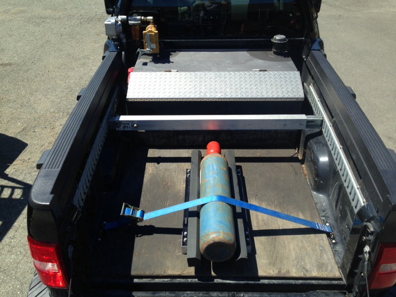

They are pretty safe if you keep the protective caps in place. I wouldn't transport acetylene inside a vehicle as even a slight leak could be fatal(acetylene and propane are heavier than air and would settle to the floor where a slight spark from any electrical item could set it off), but for compressed gas, put it in your car, secure it so it doesn't roll around and keep the windows open if it is inert gas. Even if you are in an accident, the bottle should still be ok with the cap on it. Not the best of transport methods, but still pretty safe. I would put it in with the bottom end facing forward and fully against the seat on the passenger side. As long as it is butted up and doesn't have a running start, even if the valve is knocked off (impossible with the cap on) it wont go any where and will just set against the seat and expel all the gas. I transport them in my truck the same way with the butt end against the front of the bed and ratchet straps securing it to the side of the bed for tall bottles and the small short ones (80 CF), I just stand up and strap them to the side of the bed with ratchet straps.

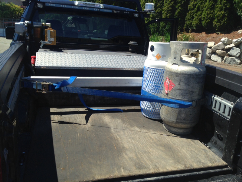

Had to buy mig gas this morning. I turned the tank around so the valve faced rearward after I snapped the pic.
I secure acetylene tanks in the same manner as as my propane bottles.
