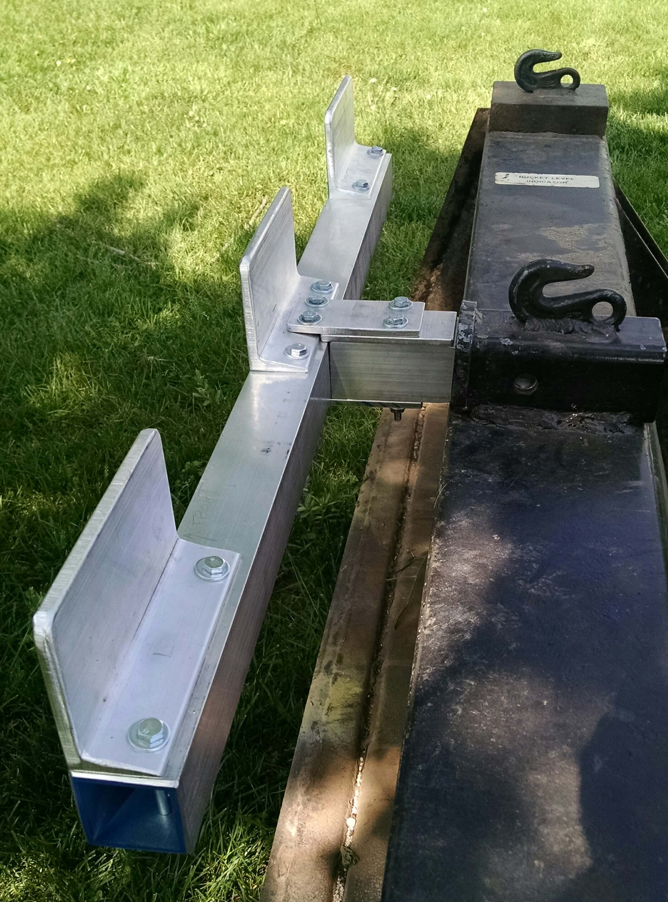

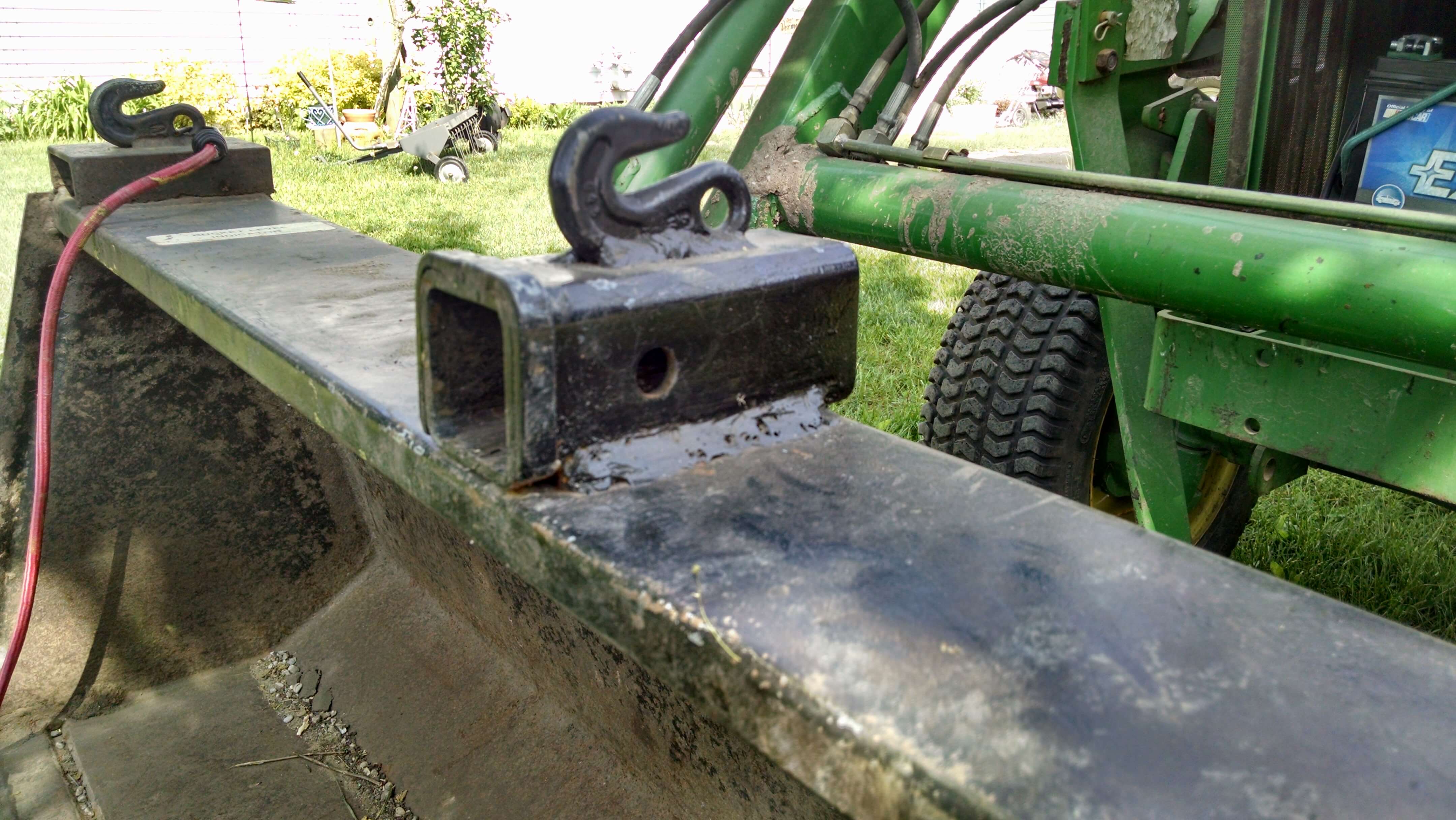

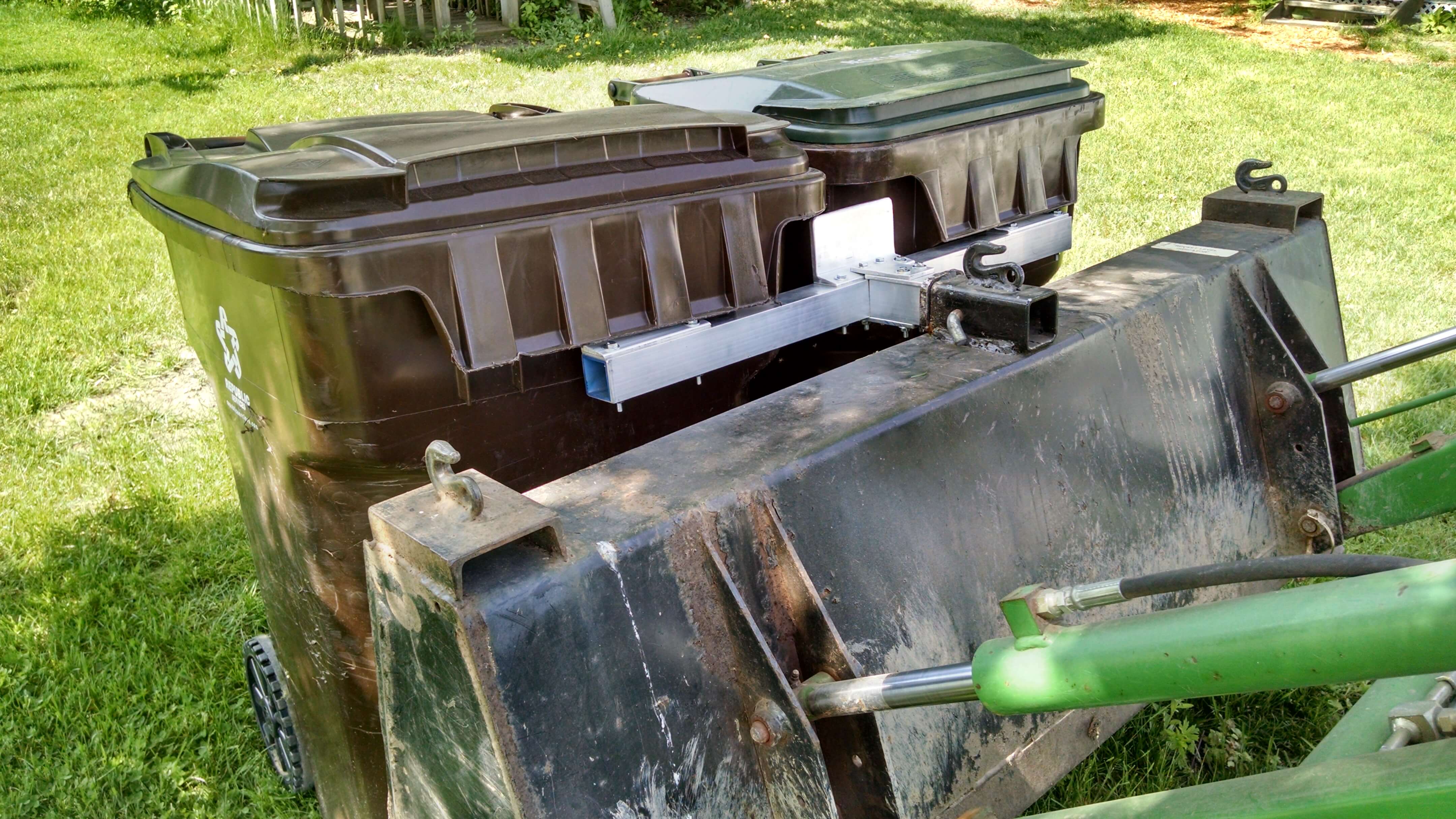

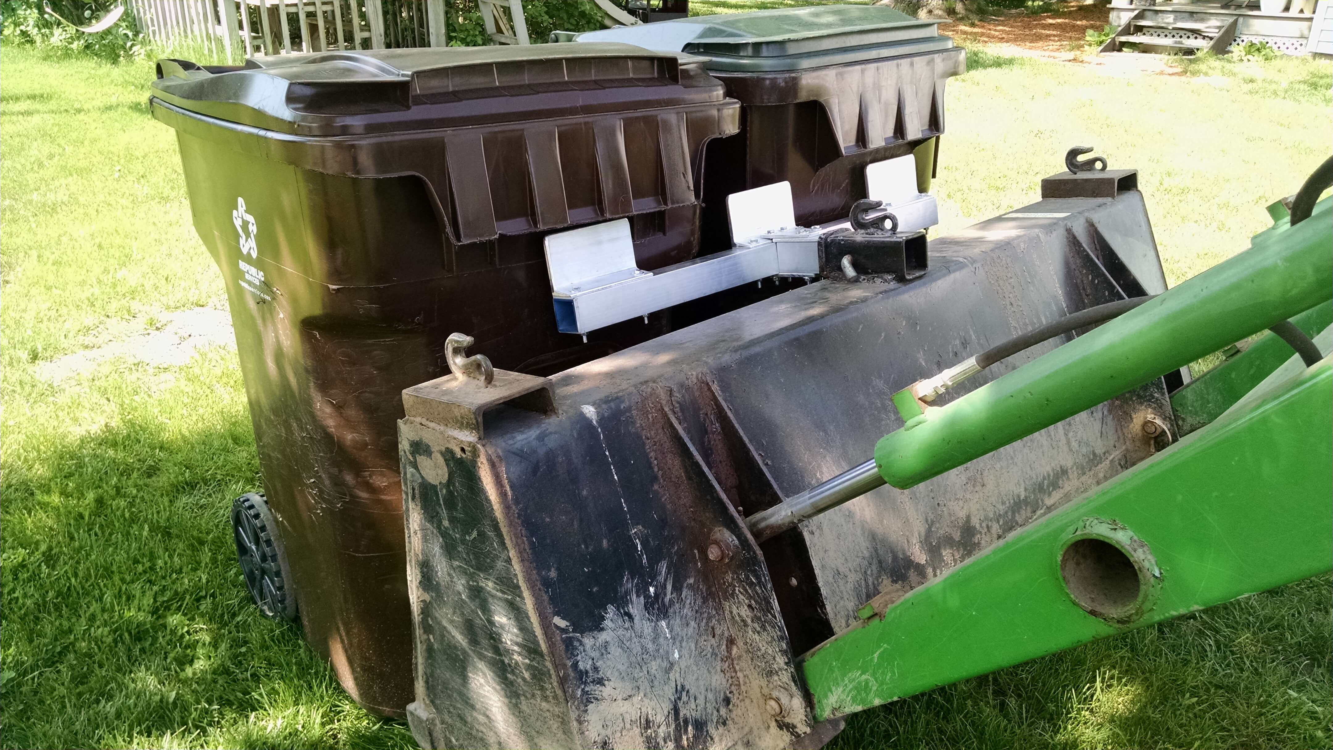

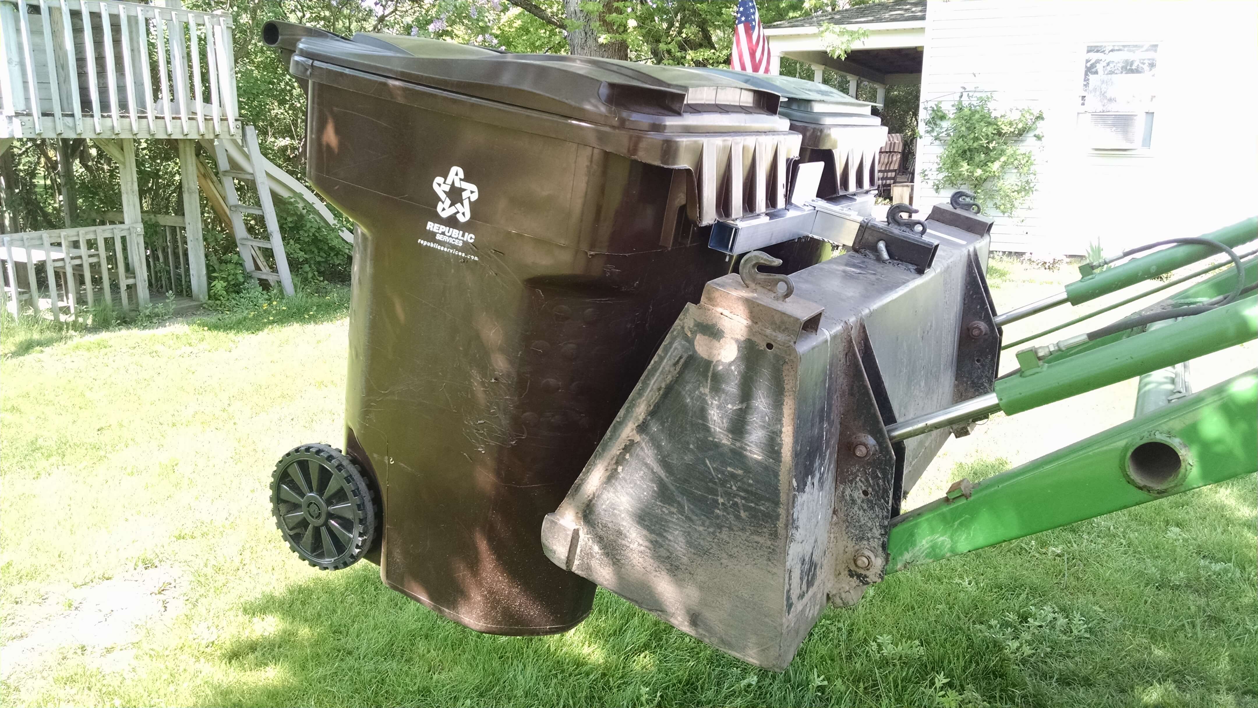

I lost all of my trash can haulers when the last of our kids went away to college and so last winter I had to haul them down the long gravel driveway through the snow and slop. For most of the really bad weather days I'd get out the tractor and lean the cans into the bucket, bungee them in and hope I could get them tilted back before they fell out. Worked pretty well except when a bungee broke or got soft. There had to be a better way
A little review of some great ideas on this site, a night to sleep on it and bingo!
A little bit of scrap aluminum about a 3 length of 2x2 square tubing and a 18 of 1.5 x 4 C channel. A bit of band sawing, grinding, drilling and assembly and less than an hour later I ended up with a really light weight accessory that I put into the receiver that is welded onto my bucket. Now I don't even have to get out of the tractor seat. The pictures should help explain.
Works like a charm!

Nice! I like it. I have the same cans from republic services also. But mine.... stay in the bucket just fine. Sometimes getting them to tip back and not out is the tricky part, but I've never lost a load.
Edit to add: I always load mine the reverse way as your holder does. So wheel-side into the bucket.

Thanks Deezler. Yep, getting them to tip back and not out was the tricky part when I used to use just the bucket, especially when there was a good load in the trash can. Additionally, a slow drive down the long drive was required just to make sure that they didn’t bounce out. Then, at the end of the driveway, I had to get off the tractor (in the snow and/or mud) and unload the cans from the bucket.
Now I just get on the tractor, drive up to where the cans are stored, lower the bucket to hook up, lift and drive away. At the end of the drive I just pull up to where I want them left and drop the bucket which allows the hooks on the attachment to slip out and I then drive away. Easy!
