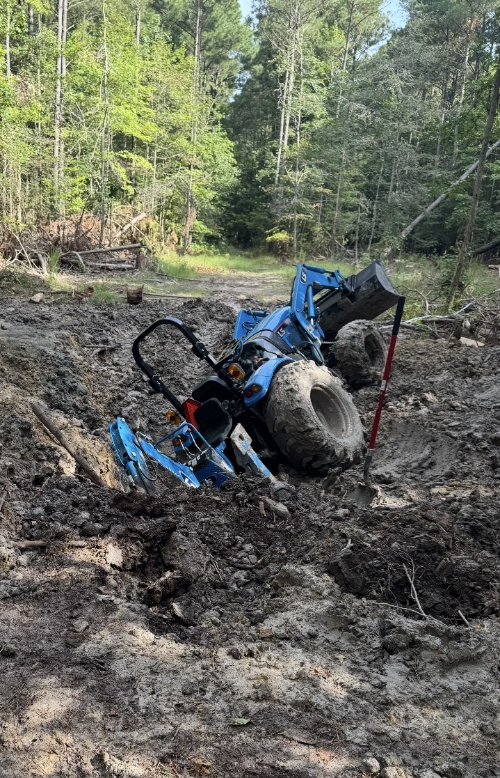

Digging a watering hole for deer (low lying land, water table is just six or so feet down). Going great, hit the water - now to clean up the dug out slop. That’s where the “fun” started. Using the bucket to smooth it out and 1.5’ from the hole was too close, all tires stuck and just a bit of spin and I slide backwards/left into the hole. Three tires are out of the hole - but rear left and the backhoe are in the hole. LS 342 shuttle shift
Tried hooking a chain to my 2500 Cummins but couldn’t get enough traction.
Debating whether my 12k warn and a snatch block will do it. Oh! And now it’s raining so move quick before half the tractor starts practicing to work as a submarine… 🤦‍♂️
I have been there and done that. It is tough enough getting a tractor out of muck without a backhoe hanging on the back. A small crawler is about the only thing that will yank it out of there.

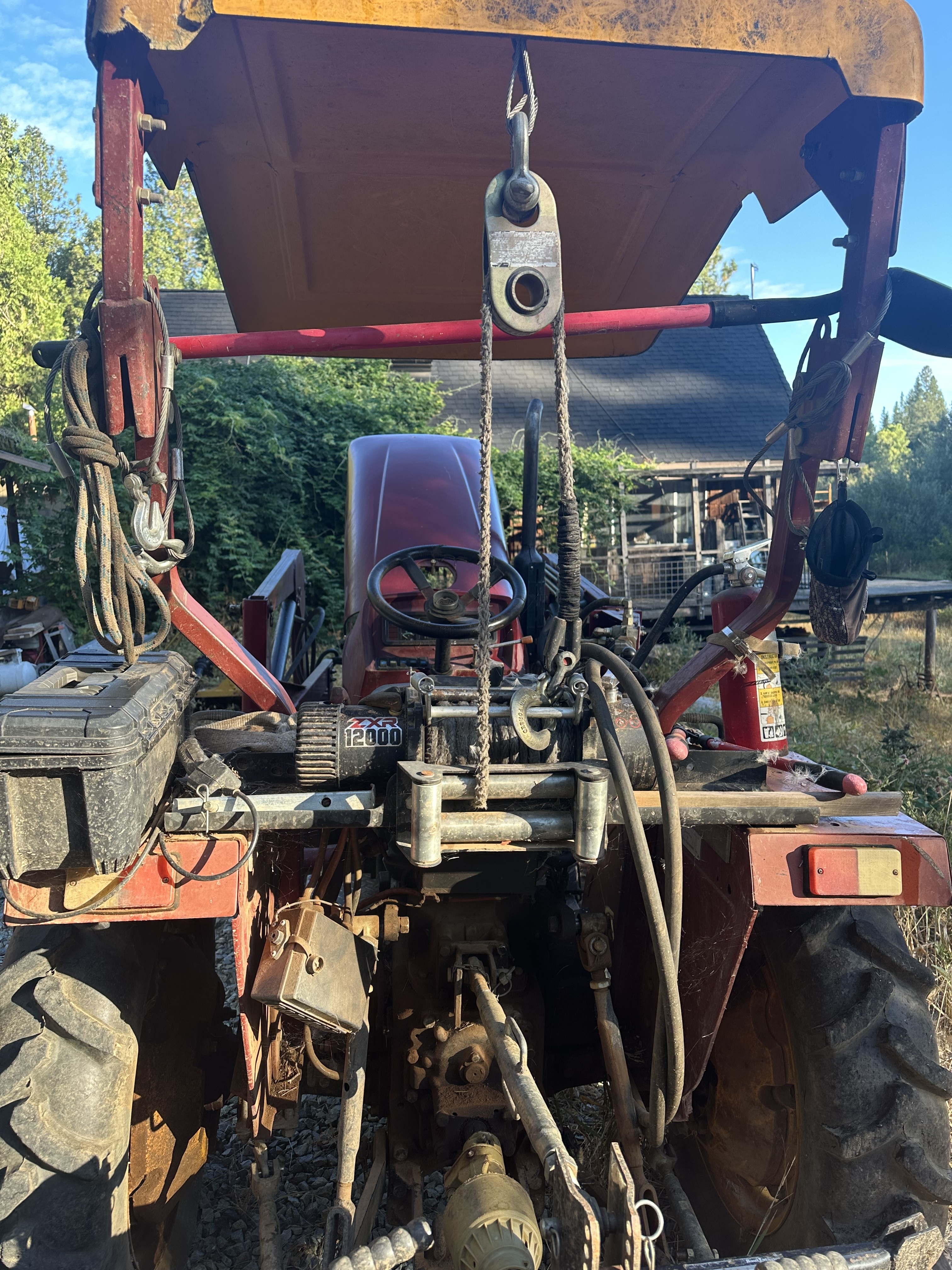

I got stuck near the creek in very muddy soil. 4WD and all four slipping. Added a Harbor Fright 12,000 pound electric winch to the rear Roll Over frame, working shin deep in the mud! Unstuck!

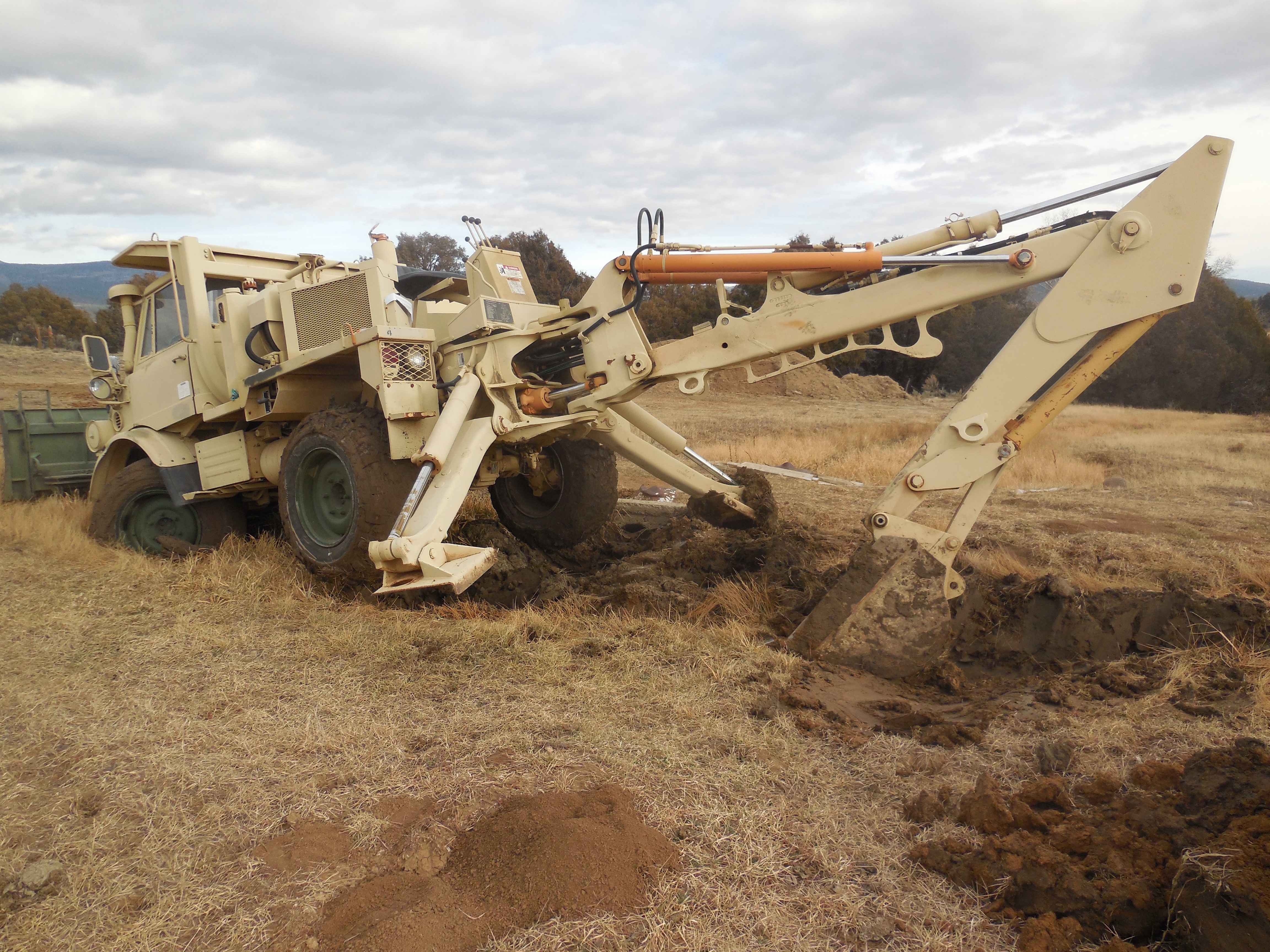

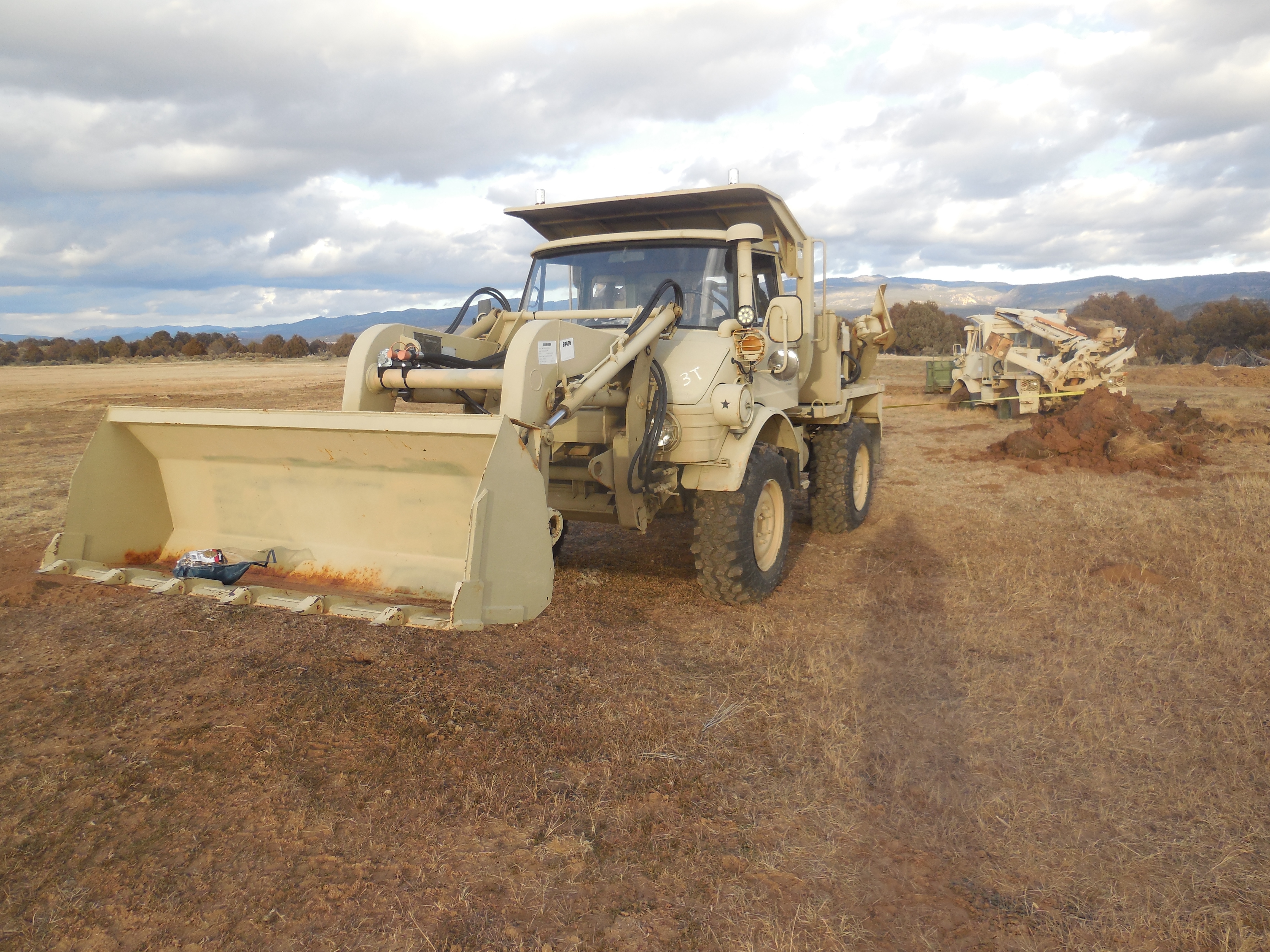

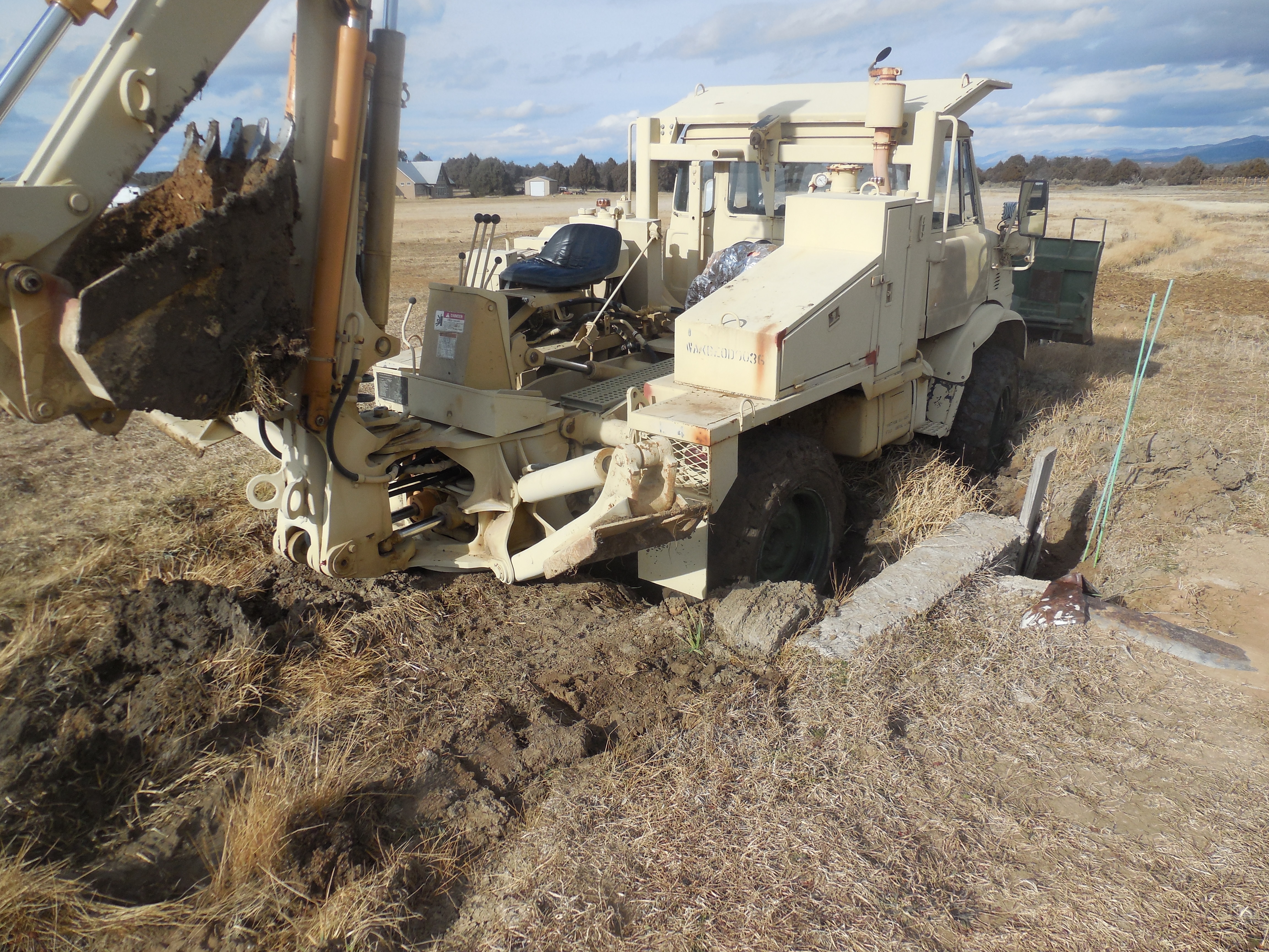

Stucks happen.
What worked against me in this case was the long travel suspension, making it quite hard to lift the rear out. It kept slipping back into the holes.
Another drawback was having the dozer blade installed. Instead of being able to lift the front with the bucket and slide on it, the blade dug in when the rear was high enough.
Oh well, pulled it out with the other one. Now there's an 18K winch on the stuck one, which would've allowed me to winch while driving it out instead of pulling dead weight.View attachment 4036223View attachment 4036224View attachment 4036225

Love these Mog's

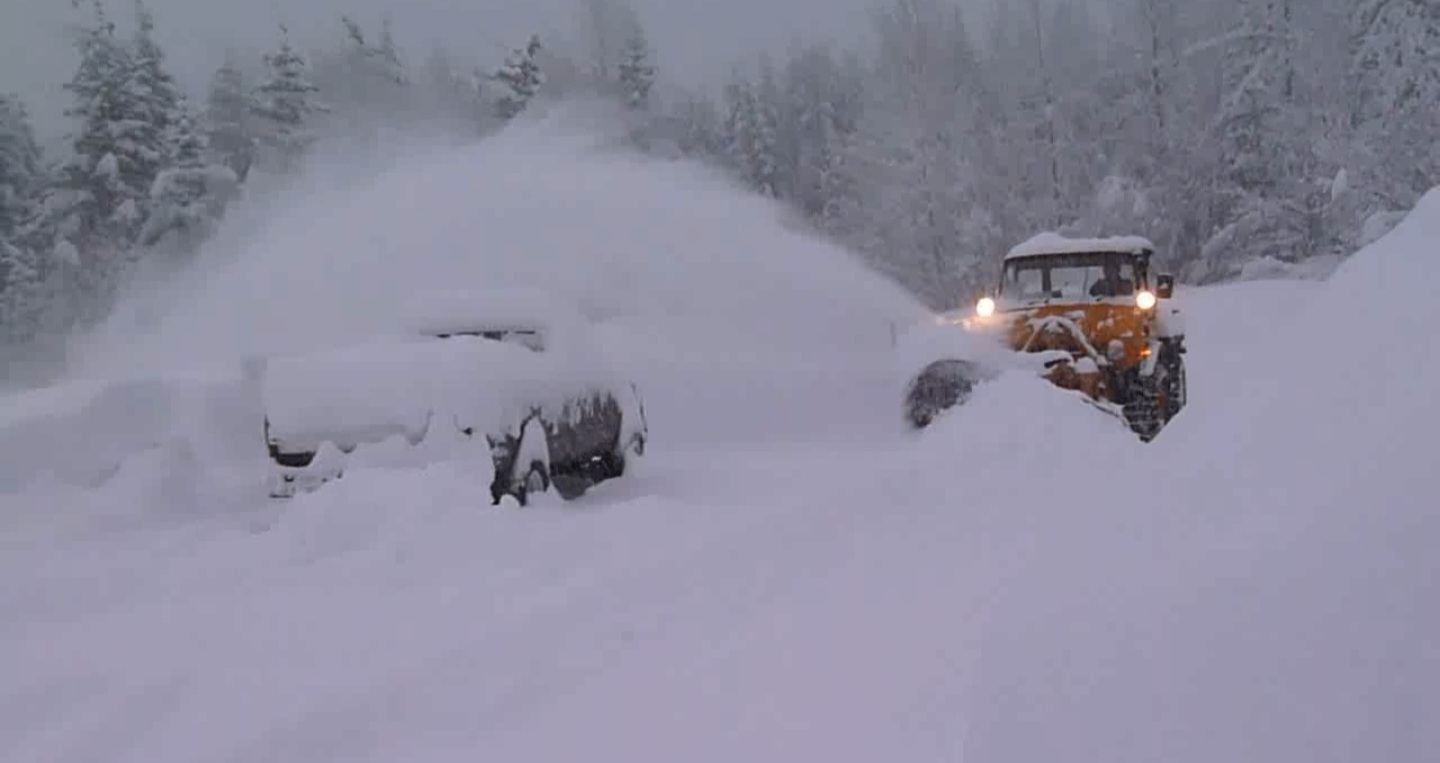

Love your Mog, put a blower on mine, don't do much farmin' up here.

The square plates at the front and back of the truck bed are outriggers. They pull out and drop down. Fully extended they will lift the tires off the ground.
Yep, but they are not meant to keep the vehicle in place, but to stabilize it when using the crane - especially when turned to the side and fully extended. Far from strong enough to keep the vehicle from moving fore or aft.
There are two "sockets" front and rear to put stout pieces of tubing in and those are to prevent movement.

Nice! I ran a 'blower on my first FLU419, the one that was used to pull the stuck one out, until getting a skid steer to run the 'blower.
I miss the heated windshield, it made things much easier than the simple wiper on the skid steer.

After seeing the picture of the hoe I can see why the hoe is useless to get unstuck. It's tiny.

Say you are sitting in the seat, what is to the right and forward? Any trees? I ask because if you can pull lightly from the righthand ROPS to shift weight to the high-side rear tire maybe an operator teasing it forward while the winch biases the weight can get it out. The pull coming also from forward will help it not fight itself. Can we assume that you can lock both rear wheels to drive together?
