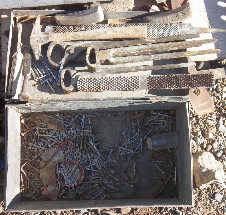

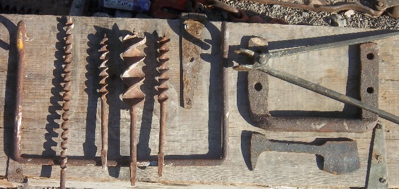

The hammer is for making holes in hot metal, just put the bar stock over the hardy hole on the anvil and hit it through the heated metal.
The picks are all what I would consider garden picks or for digging.
Let me see if i can get out to my barn this weekend and take pics of the two adz i have one I use for wood the other for digging. Both are sharp.

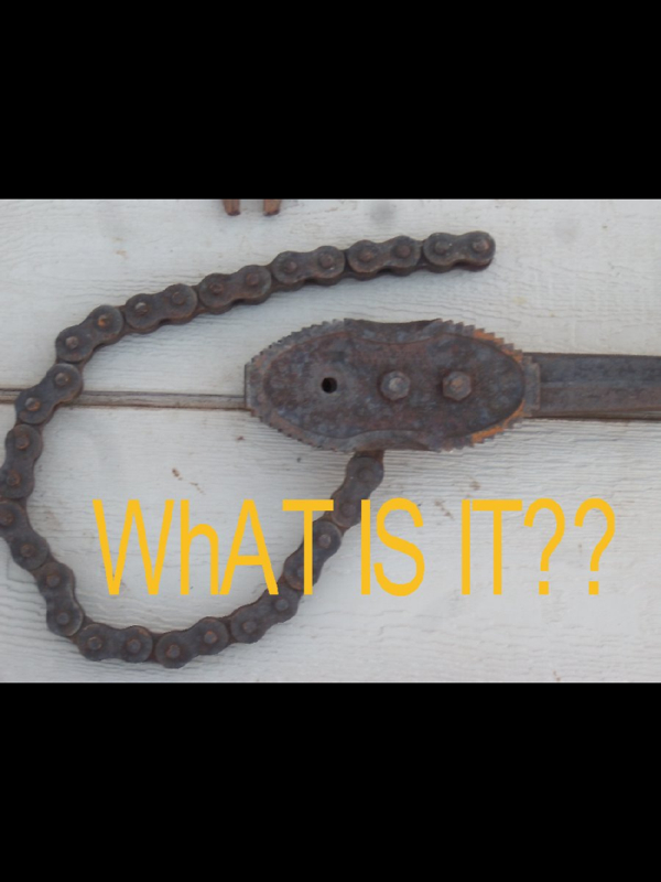

studor said:

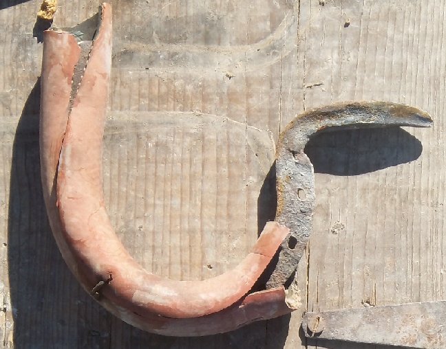

I've always known it as a chain wrench -- my father had one we used on stubborn pipes in boilers -- they were made to be pipe wrenches but were useful in any number of ways where you need to turn something with leverage -- I still have Dads and use it frequently.
The peavey (log roller) with the hinged hook is not missing its spike -- it is the small bump on the iron collar on the end.
I think the pick axe is a miners pick -- used as you speculate in tight spaces
I would say this is the proper name for this. http://www.ridgid.com/Tools/Chain-Wrench
You nailed it on the punch (broach). Lots of different sizes & shapes. Hope to find more. If all goes well some of the Stakes should also turn up.

thecnwcaboose said:
Not to step on toes but the "chain wrench" is known as a chain tongs. I use one and a chain wrench, and several types of pipe wrenches in my work.
Chain Tongs - RIDGID Professional Tools
Hmm. You might be correct. The tongs must let the chain go back through the jaw?? My chain wrench has hooks to latch it on. Looks like the principle is the same. Thanks for the correction.
