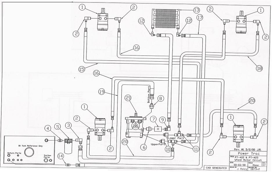

I've got some pretty good slopes on our other property. Some of them I cannot climb with the mower in float because the wheels start spinning. I can lift the mower off the ground a bit, transferring its weight to the front tires of the tractor and gain huge amounts of traction, but even with that, I still get to a point that the tires will spin in lose soil or wet grass. Even if one starts spinning, some of the others still have traction and I can keep going up that hill.
Another example is when I back drag a ball diamond. I use the large material bucket. I tip the bucket down and push up on the joystick until the front tires are off the ground. I step on the reverse pedal. The front tires spin a bit, but the rears pull me right along. If all four wheel motors where in parallel, I think the front tires would just sit there spinning with no power to the rears.
That's why I think, that with all four wheel motors in parallel, you will have excellent torque until one slips just a bit. Then all fluid will immediately go to the spinning wheel, which will spin faster, which will suck more fluid, which will make it spin even faster, which will suck even more fluid, etc.... until you let off the pedal and the wheel stops spinning. Then we will probably be at a stop, on an incline, where starting takes huge amounts of traction to get moving up hill again. One of the wheels is more likely to slip when starting on an uphill than when already moving.
However, with that said, no one would learn anything without experimentation. I'll refrain from further comment, as, after re-reading my posts, I sound like a broken record. /forums/images/graemlins/tongue.gif I hope it works for you and I end up eating crow /forums/images/graemlins/blush.gif. It would be really cool if we could make this modification for a few hundred bucks and have switchable power. I wait with anticipation(which little smiley face is for anticipation, anyhow?).
