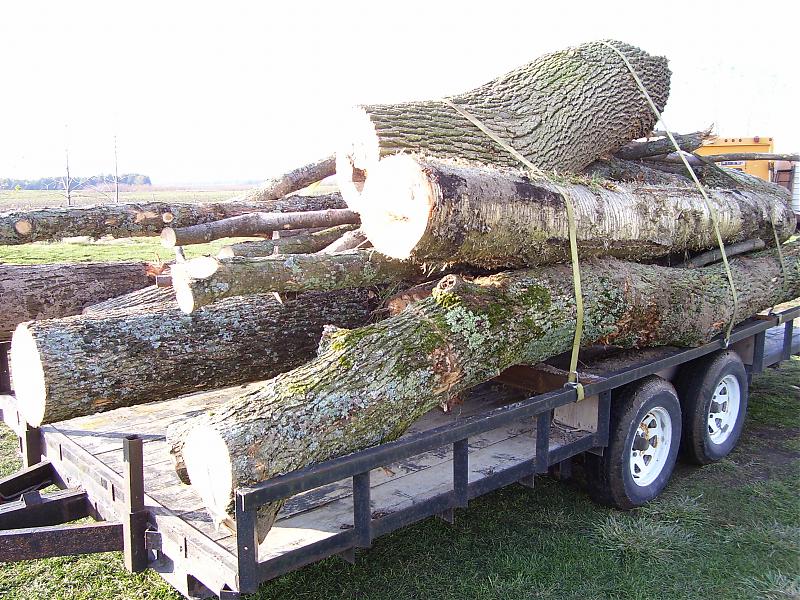

Big wave d, I have a dozen or so trailers that started out as campers. Heaviest was a tandem axle that I hauled my 1520 ford tractor on, I also hauled cars on it. I hauled the tractor, loaded tires, loader and snowblower on it often, this was the upper limit of weight for it. It was a 20' cut down to 16', tube style frame. I have a 20', 4" C channel frame one that I use for 3 lawnmowers and it works great, again gotta keep the weight down. The others are singles and tandems for a variety of uses, cheap and easy to work with. Make sure you realy go over the frame, lots of them sat around and if it's a tube frame there is likely almost complete rust thru on it. The C channel frame are great to work with, cutting them down to a usable length is easy. Width can be an issue if you plan to haul cars on them, can be done but it's tight. I usually built a 8 to 12" side rail frame on them for extra strength. Here's the tractor one loaded with a few logs.

Cantoo, thanks for the picture.
It seems like until I really give the old girl a thorough inspection; we don't really know what we have to work with. I need to see what style of frame it was built with and in what condition it is now.
Several people have commented on the railing for structural integrity. So if I do this project then I believe I'll be adding one. I know that it means that pallets aren't easily loaded/unloaded. As for now, I don't really do much with palatalized goods.
Basically looking to make something that can haul my tractor around. I don't plan on making long hauls with the old girl, so I am wondering how much I am pushing things by making this trailer as light as possible and strictly dedicated to moving the tractor. At 7K pounds with the hoe on, I am pushing the axles a bit past their ratings with the combined weight of the trailer and tractor.
