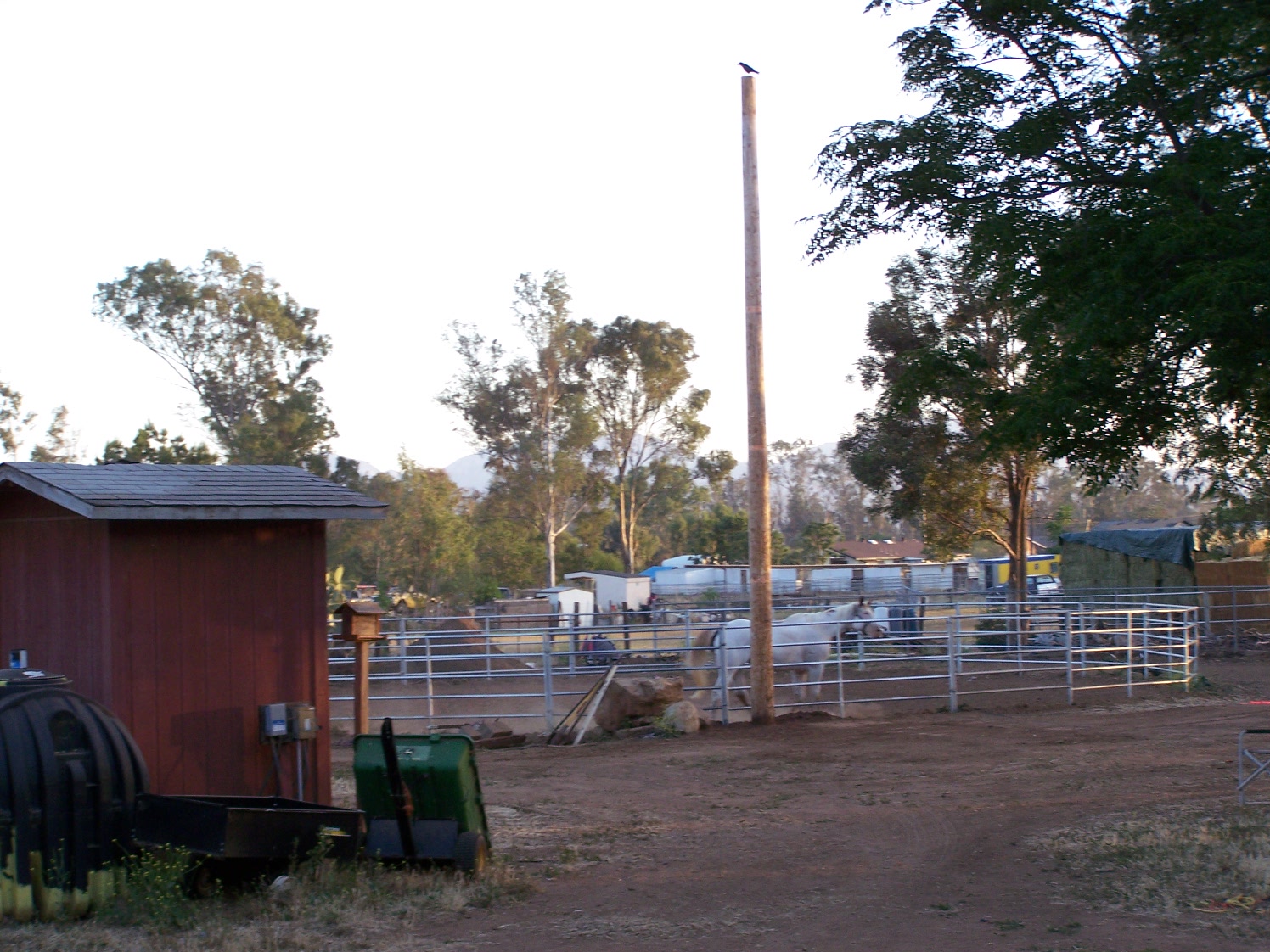

amen n80 i planted the 30 foot pole 5 feet gonna try to find the lights i also need to put some blockers on them so the neighbors dont see them. do you have a pic of the hps lights you have so i have an idea what im looking for?? should i go up all 25 feet out of the ground???also here is a very exciting pic of a pole.

Thanks for the pic. Now...do you have a pic of you putting that pole in!? It looks like it would be tough to place that thing-a little top heavy ya know. Did you use tractor, crane, 10 friends...just wondering in case I ever try to do this.

Anywhere from 20 to 25' high is perfect. At 20' the light is a little more concentrated and brighter on the ground in a smaller area. At 25' it spreads out more but it also causes more light pollution for your neighbors since this is a concern in your area.

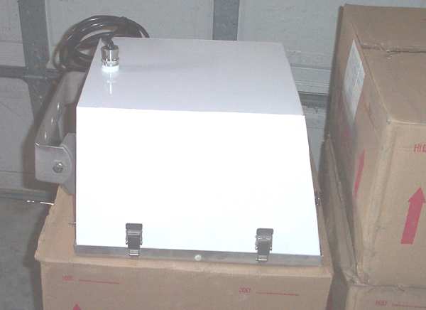

I have some photos of the lights I used in my arena. These lights come in several different styles. Mine were made for use on a ship and they are saltwater-proof, aluminum lights and more expensive than your regular parking lot lights. One good thing about these is that they run on either 110, 208, 220, or 440 volts. Using them on 220 volts allows you to run cheaper smaller wire to them than if you use 110 volts because they only use half the amps on 220. These have larger reflectors than most of the hps lights but they are so large that you can not mount two of them on a small utility pole so I need to get one 1000w light for my corner pole instead of using 2 of these.

sorry about not having in progress the wife left the camera in her classroom. i just used the bucket to lift it up had a chain from one hook to the other so it would not roll off and slid it up the bucket, got scary at the 20 foot mark. ill get photos of the next one.. jon
