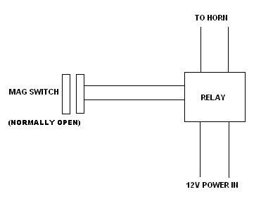

Is this the basic concept (don't laugh)?
I was looking at Wikipedia about relays. Is a single throw (normally open) relay what I want?
I also don't know how the connections at the relay work.

I don't like the idea watching for a mark or watching a drag chain spacer. It distracts the planter from focusing on the tree planting. An audible sound does not interfere with the eye balls and gets a rythm going.
I don't want the...look...look...look...look...look...look...plant. I want...beep...plant............................beep...plant.
The adjustablity is nessesary depending on how early I want to harvest trees. I can live with some limited adjustability but 11 ft won't be the only spacing. I can live with 11' or 5.5' or 3.65' or 2.75' spacing (either 1, 2, 3 or 4 magnets on the rear tire rim).
I can fashion the mounting brackets, etc. to mount the required hardware. I don't mind to do some rig up as it is once per year for one day of planting.
I like the idea of using the tractors horn and a relay/magnetic switch to activate a beep. I think some rare-earth magnets stuck to the tire rim would be strong enough to activate the mag switch and stay put while driving. If that doesn't work I could always double side tape the other side of the magnetic contact switch on to the tire rim.

Thanks for all the great suggestions. I think I have found my solution with help from ACZLAN.
A magnetic switch by the rear tire and magnets spaced on the rim and hooked to a relay sounding the tractor horn. The wiring is fairly simple and the magnets are adjustable on the rim to vary the planter spacing. The audible tone will be better than a visual cue.

BUILD UPDATE:
$50 for wire, switches, fuses, relay and terminal connectors has completed the electronic build. I gathered up the parts and sat down this afternoon to build it. About 1 hr later I had the working guts of the tree spacer horn honker. It is a super simple system in the end...probably less fuss than a mechanical bell dinger.
All that is left is to fab up/weld a bracket and make the final connections.
I did test it out and it honks the tractor horn as you pass the magnetic switch by the other base side. I put an on/off switch so that we can shut the whole system down and all is fuse protected.
I have an eBay order being shipped with rare earth (neo) magnets that I will space accordingly on the rim. Those will be the only thing that is not permanmently installed on the tractor. The bracket will be tucked up behind the fender and inside the frame.
Should be goodly. Thanks for all the input. I learned stuff about relays and that is always good to learn.
I'm thinking that no matter where on the rim you put the magnet it's going to trigger once per revolution and the spacing is going to be the same, the circumference of the tire. Two magnets makes it half the circumference, and three makes it one third, etc. But with this setup you're not going to get 10 foot spacing from an 11-foot wheel.
/ Tree Planter - Tree Spacing Timer
#36
I know I won't get 10 ft spacing...It is an 11ft circum. wheel.
If I put one magnet on the rim it will make 11 ft spacing. Two magnets equal 5.5 ft spacing. Three magnets equal 3.66...ft spacing. Etc, etc.
10ft spacing was a starting point for the idea. It was one of my planting options. I can live with 11ft. It is close enough but I also can put multiple magnets on the rim and get small spacing.
