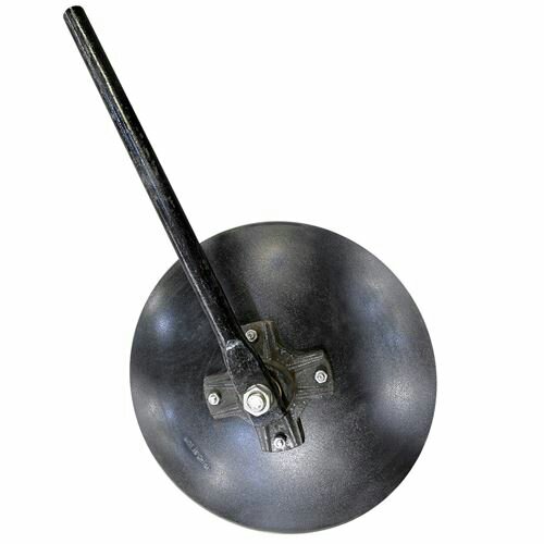

As a kid my Grandfather planted Christmas trees using a Farmall tractor and a single disk harrow, similar to this but larger diameter and mounted in center of tractor.
He made long rows about 10-15 ft. apart. He grew a variety of maybe four type trees.
We kids went along spacing trees maybe every 10 ft., it went pretty fast just flop soil over root ball, the trench held water. 31752.jpeg
