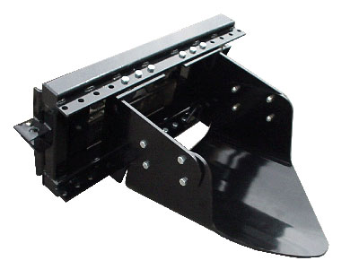

I have over 2 acres with many, many small-ish trees I want to remove, ranging from little 1" diameter saplings & smaller that I can & prob will just bush hog, up to 5"-6" trees that I can push over, but the root ball doesn't always cooperate by popping up some such that I can continue scooping it completely up out of the ground. Sometimes the trees actually break off at or near ground level.
What would be the best tool or implement for this type of tree removal?
I'd like to be able to drive right up to a tree, & using a compact spade type QA bucket, push the spade under the main trunk & curl the loader to lift it out of the ground. I say "compact" because the spades I see available are pretty long (36"+) which would reduce the curling power of my loader.

How about something like this. You can also use your forks if you have them to lift trees and root balls

I am not sure this is the best or fastest but I have used my quick spade for a few years now. Its great for driving up to small trees and plucking them up out of the ground. I've cleaned up fence lines, planted and moved many trees with mine.

OK, thanks! I like the price of Luremaker's suggestion! But I like the QA design of JJ's, where I could remove my bucket, bringing the whole spade unit back much closer to the loader's pivot point, thus increasing the curling strength. If I could find one that's about 18"-22" long, instead of 36" or more, that would prob do the trick :thumbsup:

I made a great sapling plucker out of a piece of of thick plate steel, that I just cut a V shape into. It simply bolts to the front of my bucket when i use it. The V is sharpened with a chisel edge (flat side up), which makes it bite tightly into the tree as you lift. It works so great on my tiny L250 for 1"-3" saplings that I plan to make a larger model for my Larger TLB and see what my max tree size will be for it. It's only a few dollars of scrap metal and couple heavy bolts.

He says it's made of 1/4" steel plate, & I emailed him for dimensions: "22 wide at the back and the spade blade itself is 26in deep"
It's $395 + $128 shipping = $523 ... Worth it?
/ Tree plucker/ remover recommendation please #8
1/4 in plate isn't very strong and the shipping is way too high. Just my thinking.

For me, I've found the easiest fastest way to be a small back hoe. I chainsaw the tree first and leave enough stump to easily find when I come back with BH. Drag off orcut up the trees. When you dig up the stump with the BH you can pull just the root ball and shake off most of the dirt. 1 wipe over with bucket and you be able to tell a tree was ever there:). It takes a lot more power and tears up much more earth when you push the tree over and try to dig out with the FEL.

Bep, Have you considered a "tree getter" ? Easy to build & use. When backing thru a tree with the 3pt hitch version it increases traction as it pulls down on the rear wheels vs. liftihg the rear wheels on the fel version. Either one lifts & rolls the stump away from the tractor which beats the short chain method. Both very effective depending on you tractors capability. MikeD74T
