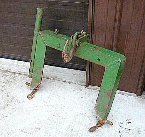

My 3 pt attachment for logs is a homemade arch-like lift, but is very similar in form to a 3pt quickhitch (LandPride, etc.) with a big hook at the top for the tongs. A friend of mine borrows mine and would like to have one made, but I may just sell him mine and replace it with a quickhitch. I would add some grab hooks to hook chain into in a way as to not destroy the integrity of the quickhitch (one each at the lower ends where the lift arms attach and a couple along the top frame).
The logs are hooked about 10-12" from the end of the log, and the logs hangs between the ends of the lift arms. The drawbar keeps the log from getting too close to the rear of the tractor (PTO shaft and safety cover).
I can see advantages of both these rigs (your puller and my arch), but am not quite sure if they would work well together. I now back over the log and drop the lift arms down each side of the log (or at the end of the log if too big to fit between the lift arms), then attach the tongs (sometimes I can reach the tongs from the tractor to get them to drop over without getting off the tractor). Then I lift the log with the tongs and 3pt, and sometimes will throw a chain on it to keep from losing the log (which occasionally happens, but not often).

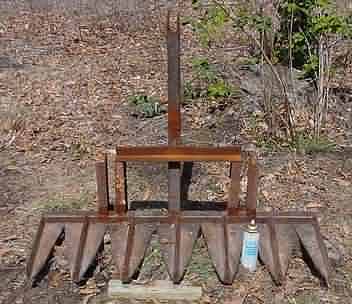

Here is a picture of a treepuller that I welded up last year. It was a rainy Saturday and it was all steel that I had in stock.
I would chance a few things when I build the next one. This one works pretty good, but at times I've got to get off the tractor to clean out the small debris from the teeth. This is where a bucket mount unit would really shine over a three point mount, having down pressure to clean out the teeth on the bucket model.

Attached a shot of the 3pt log arch that I use with my logging tongs. Mine has a couple of grab hooks welded at the bottom corners on a couple of chain links. These help to snub up chain(s) around logs that are looped over the big hook. As I said, it is similar in form to the quickhitches, of which I may replace this one with in the near future.
