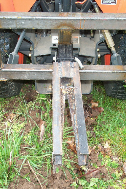

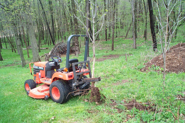

I finally got around to building a small tree puller.
I built it with only one fork but I used it today and it was really impressive. I have a home made sort of quick hitch on my BX that has a receiver hitch, carry-all attachment and a weight box attachment. I made the tree puller to go into the receiver hitch. Thank's again for the idea./w3tcompact/icons/grin.gif
See attachment for Picture.
Rich...
/ Tree Puller and logs #13
Close up Picture of tree puller.

/ Tree Puller and logs #17
Jag, sorry but still confused here. Looks like you back down on the tree to pull it out. Is this right? Then go forward and the tree stays in the puller until you lower the 3pt and drad it loose? thanks, bw

BW, that is basicly the use. Once you get a feel for using it, the work goes fast. At first you will hang the tree too tight in the forks and it is hard to get back out. After a little use you back up into the tree and pop it out and drop it almost where it was, unless you want to move it to a pile before droping it.
