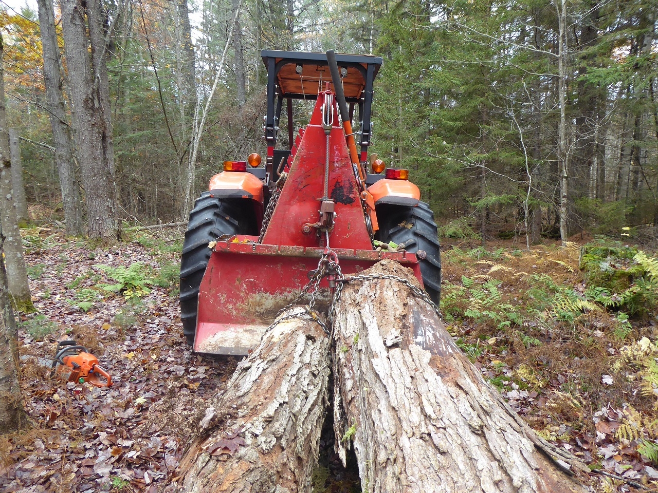

Cable chokers are a lot lighter than chain, even high strength smaller link chain. It makes a difference when you're pulling the cable and carrying a choker or two up a steep hill. You don't need a rod attached to get them under the log. I think they grip logs harder than chains. The one I have is not as easy to come unhooked when you start a pull as the chains with slip hooks are. Setting those up properly helps but sometimes the first log bumps the second log before there is tension on the choker. Or you just got the direction of the forces wrong.
Cable chokers don't let you tie the log to the back of the winch to drag it out of the woods. Well you can but not so the winch pulls the butt up off the ground so it doesn't dig in. The chains are easy to store especially if your winch has a place to store them like some do.

I like chain chokers because on a tractor winch you cannot pull the slider end of the chokers into the winch like you can on a skidder. If you want to get the hitch off the ground you would need a whole assortment of cable choker lengths. With chain chokers you can adjust the choker length in the keyhole slider. Also if your winch has a slotted rack you will need chain chokers to use it.

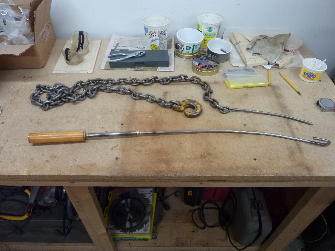

If you have trouble finding what you want locally you can by chokers on-line at places like Labonville. It is usually cheaper to just buy the hooks on-line and buy chain locally then make your own. I use 5/16 hooks and grade 70 5/16 chain. It works fine with both 5/16 and 3/8 grab hooks and sliders and is plenty strong for tractor work. It is lighter and easier to handle compared to 3/8.
I use a crude bending jig and torch to put a pin on the end to push under the log.
And you can make or buy a longer hook to push under larger logs or in the snow. Grab the chain and pull it under.

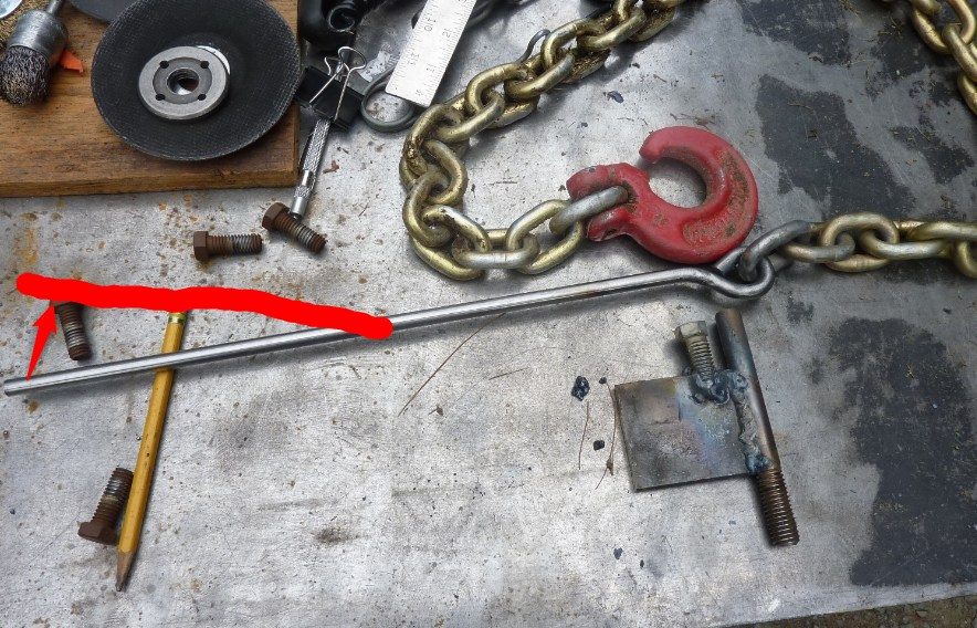

I was going to say it helps a lot to put a slight bend in the leader pin (or whatever it might be called) so that when you push it under a log, it wants to curl up on the other side vs diving into the ground.

Adding the bend in the rod has a major impact on ease of threading the chokers under the log, IMO. This work is physically hard enough as it is. One less thing to fight...

Glad you added that. A bend helps a lot. They get bent just using them too - sometimes to much. But are easy to straighten in a vise. I have a mixture of 3/8 and 5/16 chokers too. My Farmi 290 has 5/16 key hole sliders. Once in a while I end up with a 3/8 choker off the 501 on the 290 and it is a real pita. The chain seems to start into the keyhole then get stuck. Not easy getting it out for some reason. So when you get your winch make sure you end up with compatable hardware including the slots in the rack on the winch.
