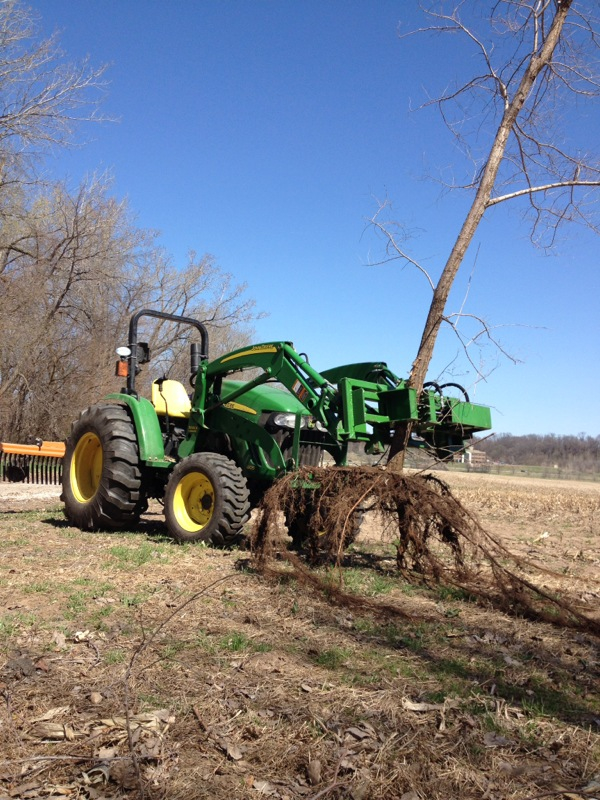

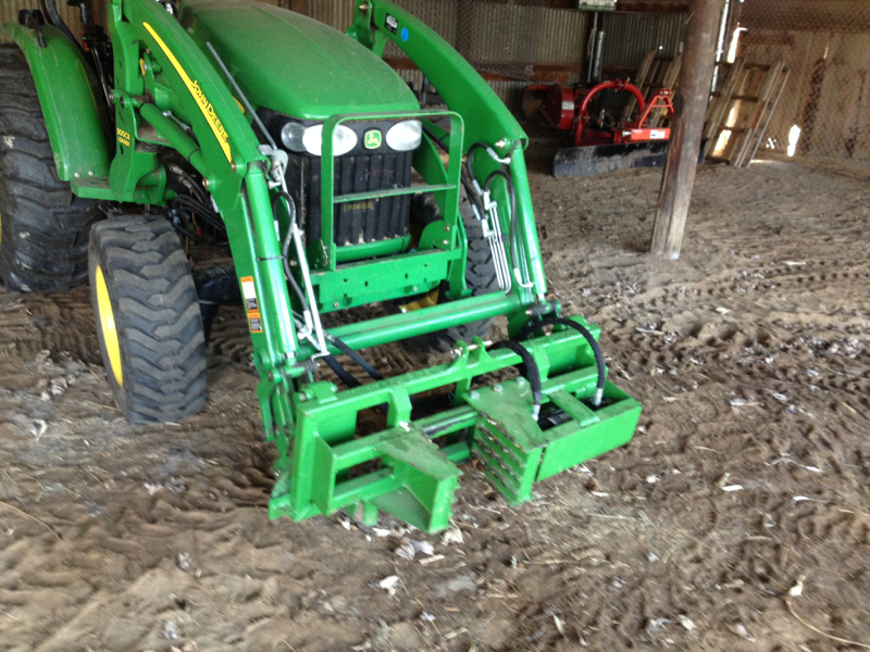

I have one that works well. I started using a brush Grubber model that would just tear the bark off more often than not. Learned that I needed a hydraulic clamp. Here are a few pics...
Best feature: I don't have to get off the tractor to pull each tree out of the ground.
