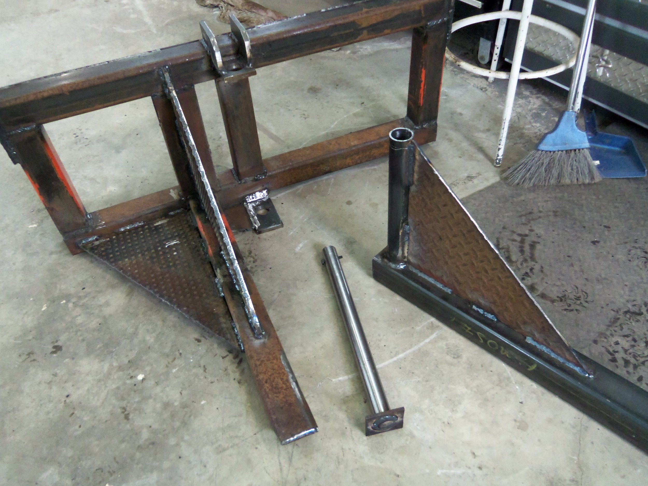

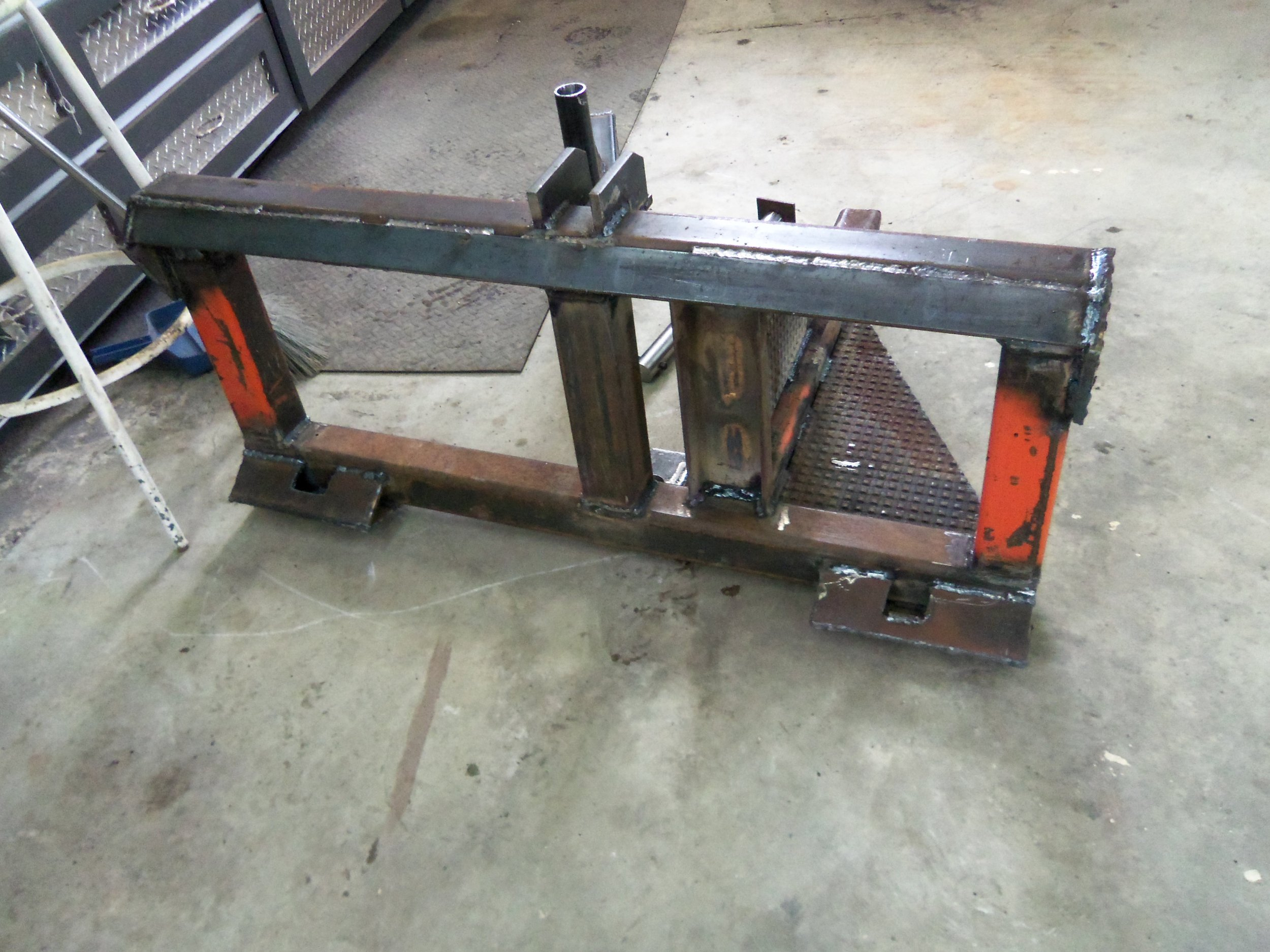

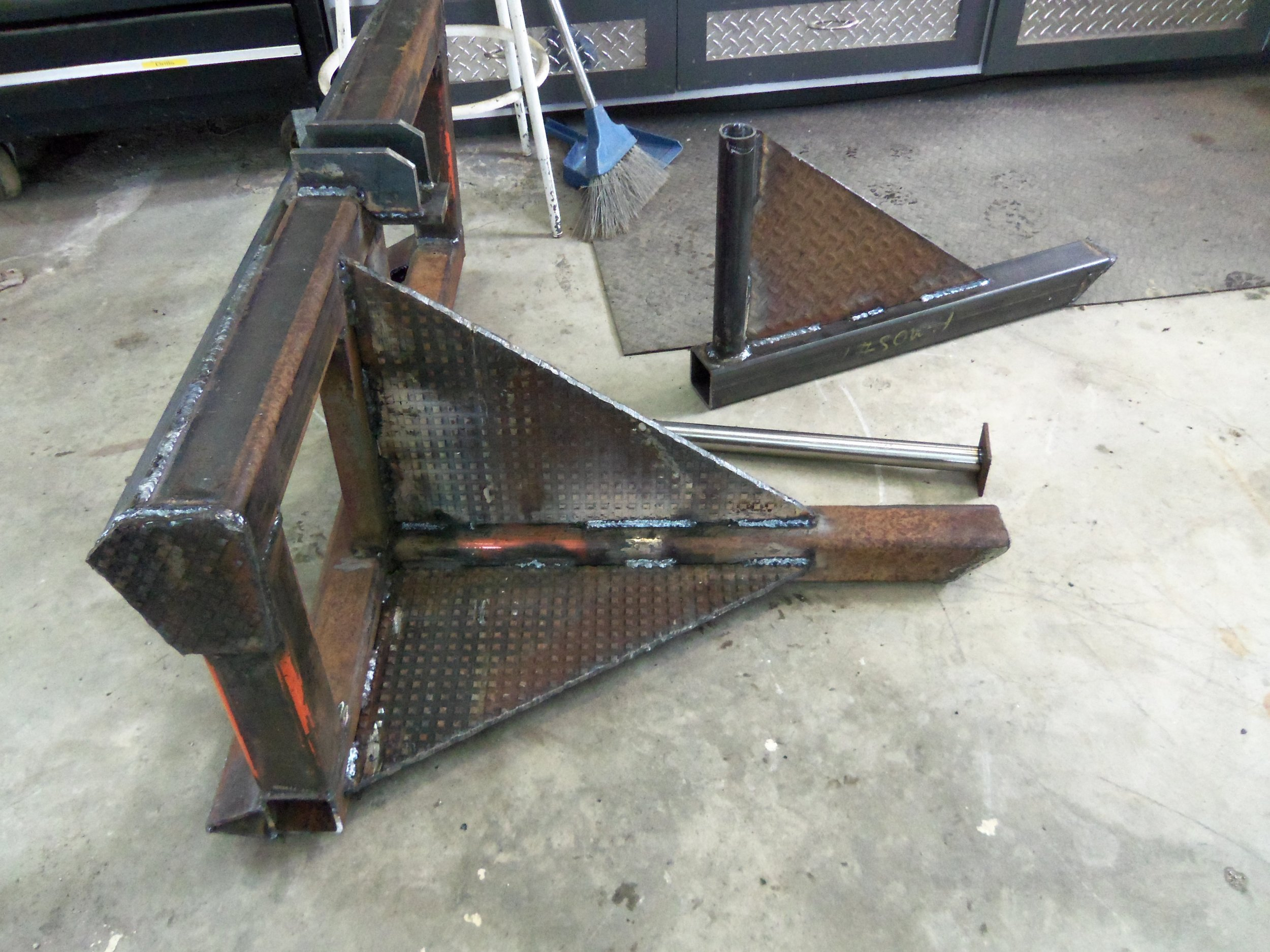

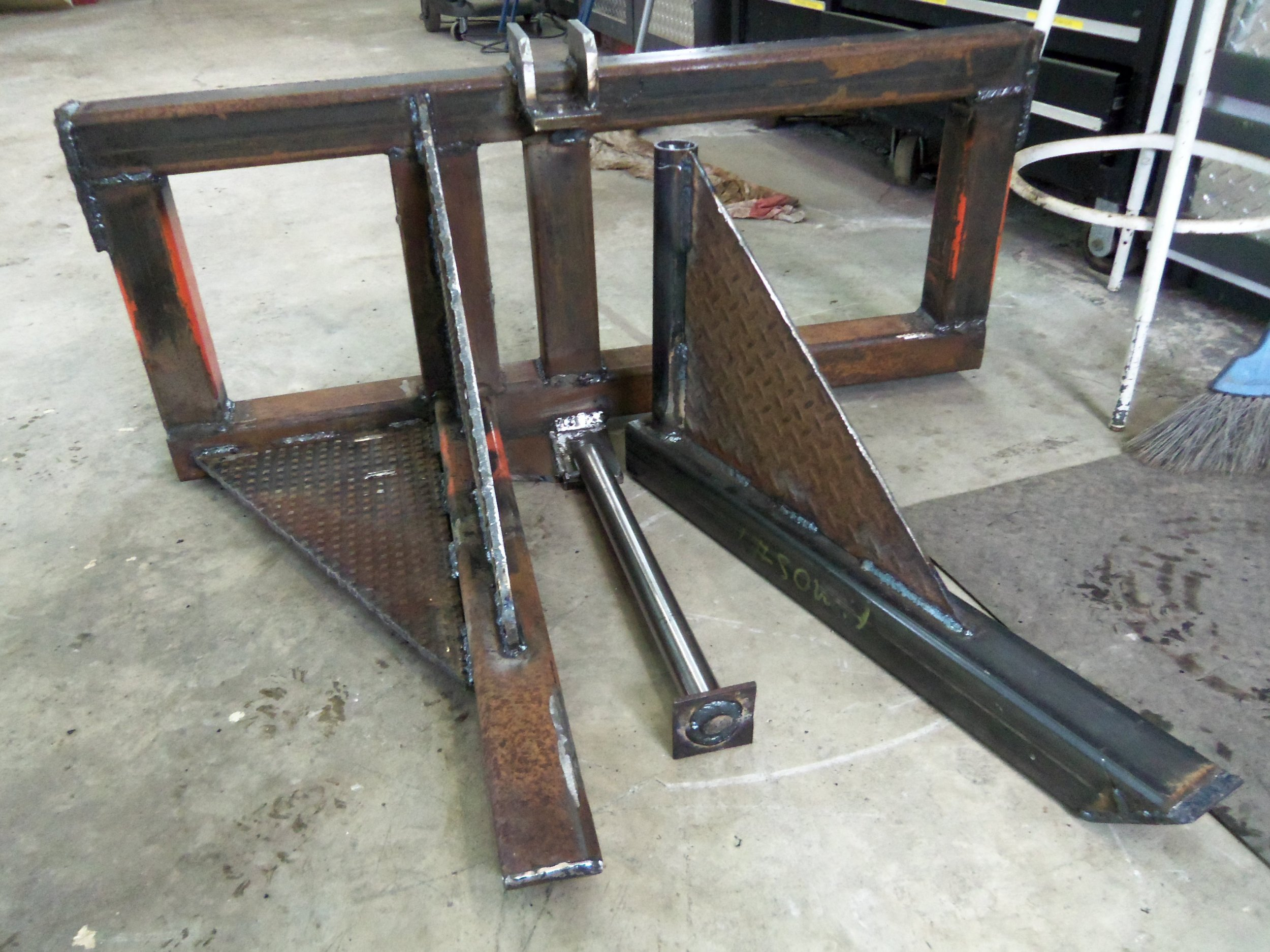

Well am doing a tree puller for my tractor . Was looking to by one but but dint find any thing close to me and i have the tools and shop to do this . Also have the time to do it and it just fun doing this stuff So far i have the main frame don in 3x3 tubing and 3/8 plate i willl post pic soon just have to bring the camera in garage .
   / Tree puller
#2
Well here are some pic it almost done still have to sand blast and paint it when it get warmer outside . The steel is stuff i had here only had to go get a few piece > By the time im done it going to cost me about 550.00$ way cheaper the a new at over 2k ,one that am going to just a few time here and then. Hey it fun doing this stuff .

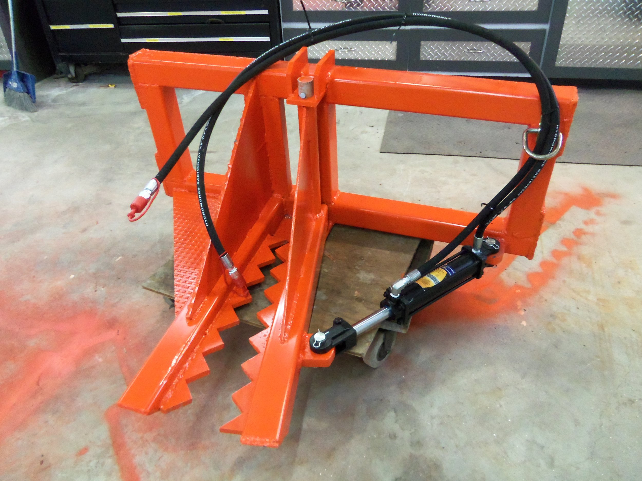

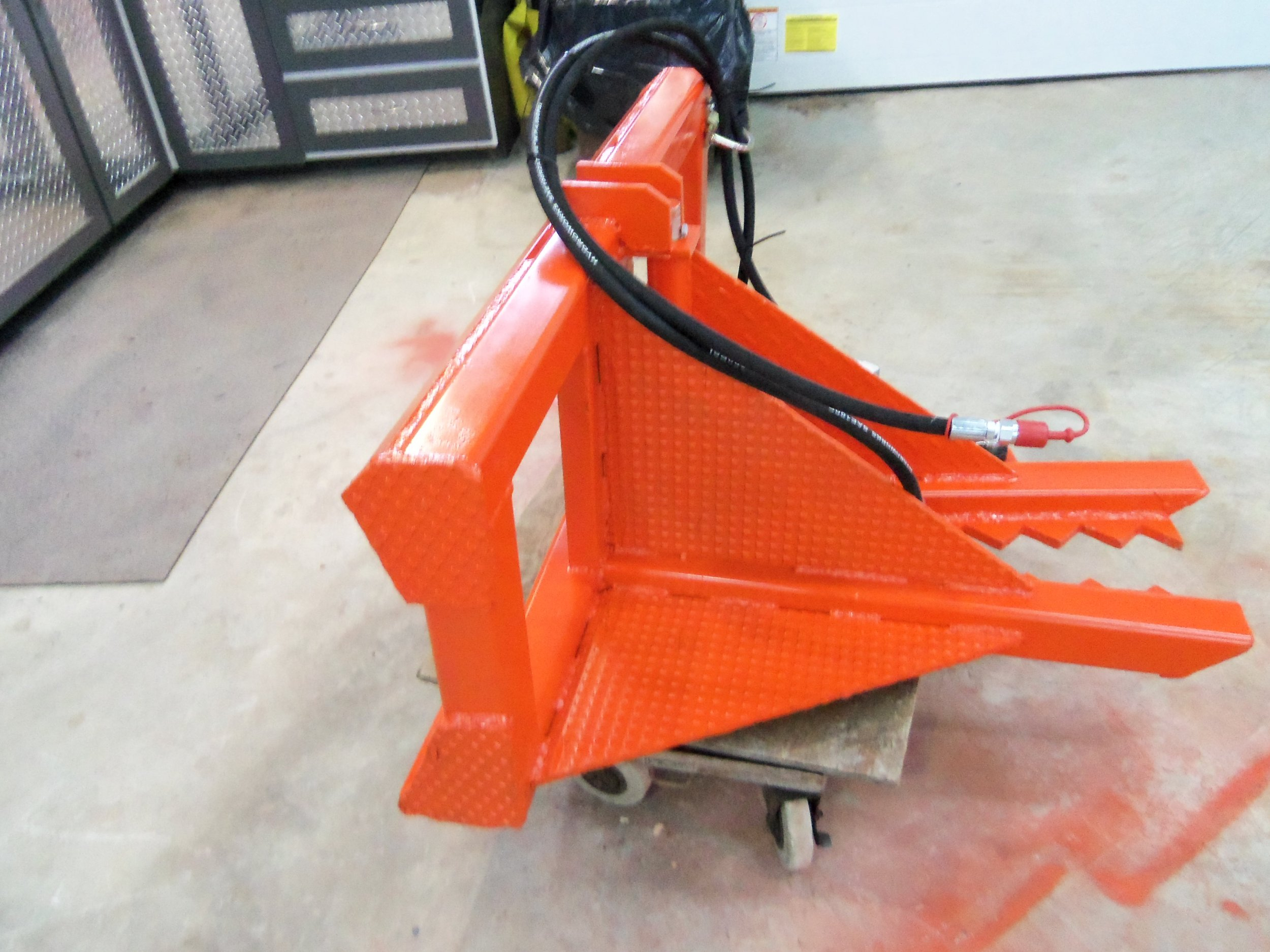

Well finaly got the rest of my parts to finish my tree puller . Got a 2inch bore x 8 inch stroke it open about 12 inch. got 3/8 hose x 6ft .Just got to try it out see how it goes .

It works .Well finaly got a chance to try out my tree puller a bit today .Look like ti working good try it on a few tree 2 t0 3 inch no trouble at all . Going to have fun whit this still have to wait till it dry up still to wet .
