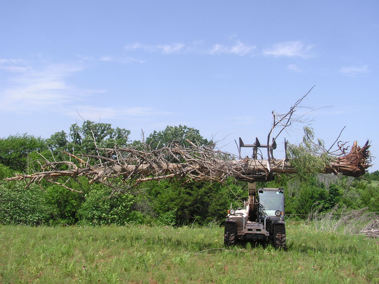

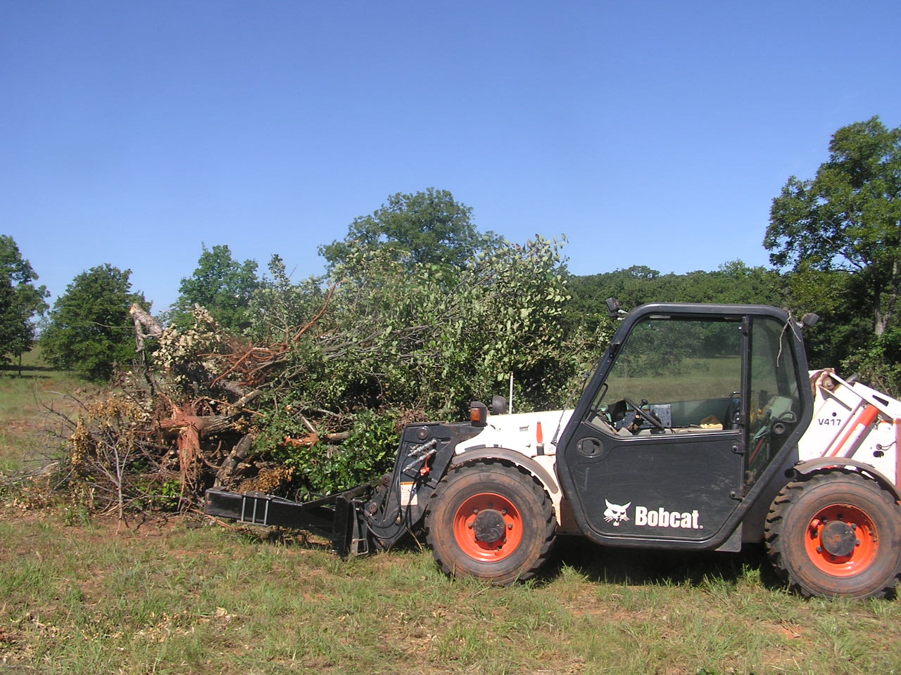

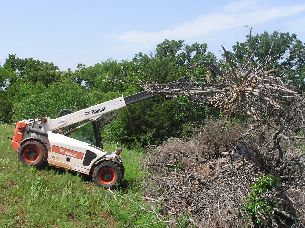

I think you are right about the view issue, and I have also looked at the Buckthorn extended puller. I worry that the hydraulics on my tractor (especially the curl) may not be robust enough to handle the extra torque of the longer extension. Have you found that to be a problem? I couldn't tell what machine you have your puller attached to, but it looks pretty beefy to me.
I have never had problems with viewing using the grapple, but do when using the bucket. I even thought about trying one of the cheap TV cameras I have left over from another project, but have not yet got around to that.
If it's handling your grapple, I don't think the puller would hurt it and the puller just weighs 284 pounds.
One advantage of the long arm puller is you can clamp on the trunk and curl down as you drive forward, breaking the roots out just like your pictures. Then just pull them up and put them on the pile.
My machine is a Bobcat V417. Here is a link to the biggest cedar tree that it has pulled: http://www.tractorbynet.com/forums/attachments/277824-tree-puller.html#post3444397
