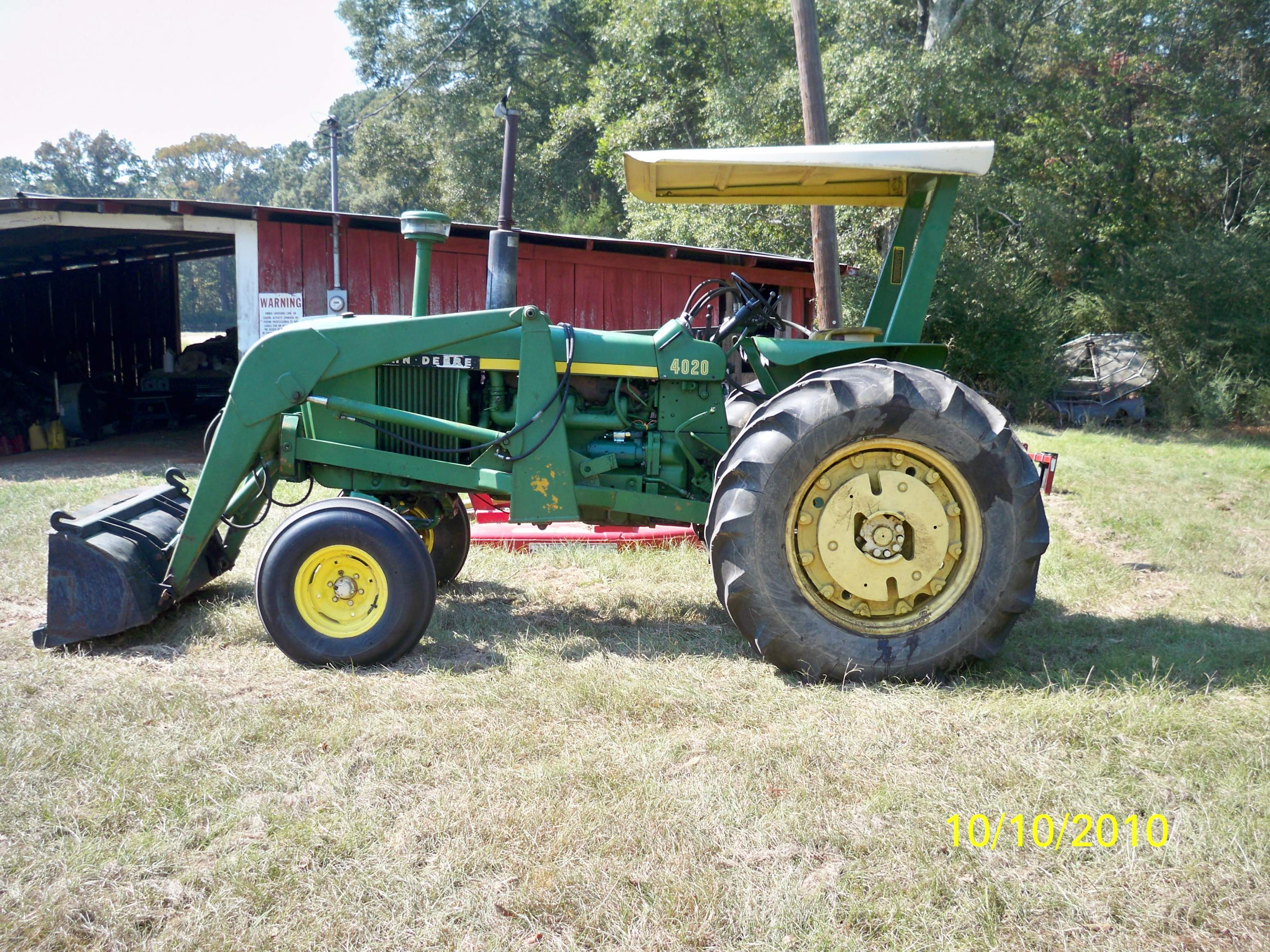

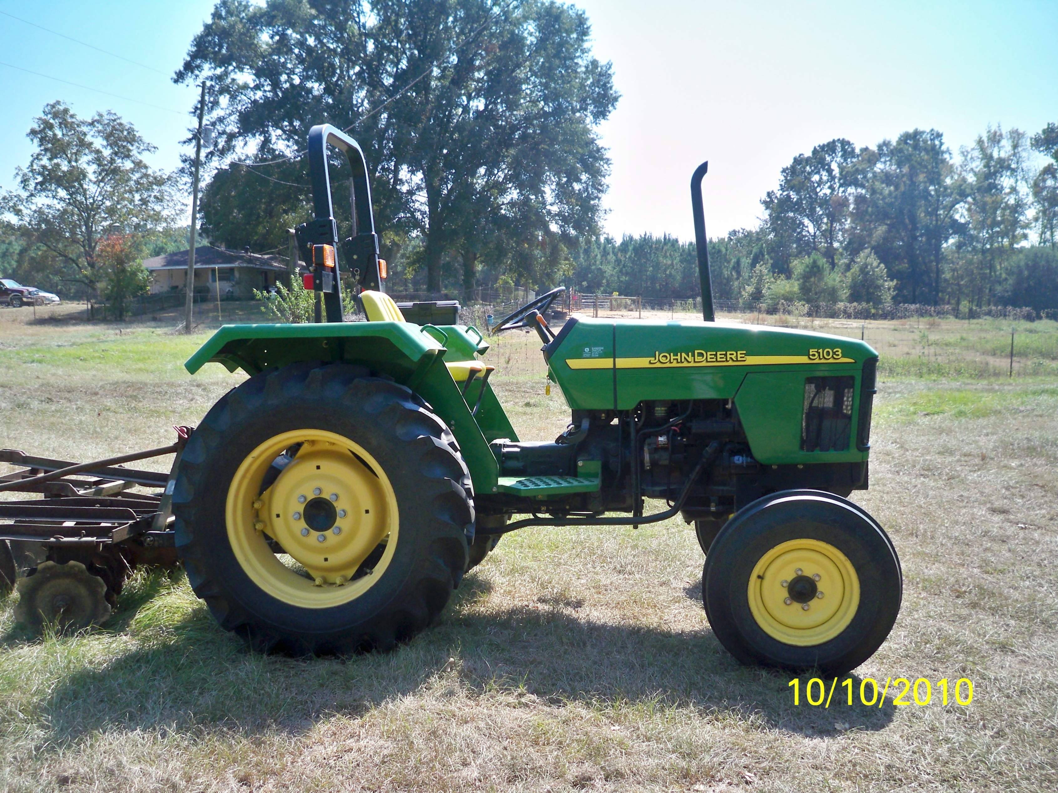

I recently acquired a real nice pulling machine, a JD 4020. I use a drawbar with a log tong to move the big trees and the front end loader for small stuff (saplings and youpan). My 5103 has the rear tires filled and it makes a big difference traction wise. The 4020 has wheel weights. If I have to completely remove a tree of any size, I rent an excavator and loosen the root ball and use the excavator to push the tree over. I then use the 4020 or 5103 to drag it out the way, depending on the size of the tree.
