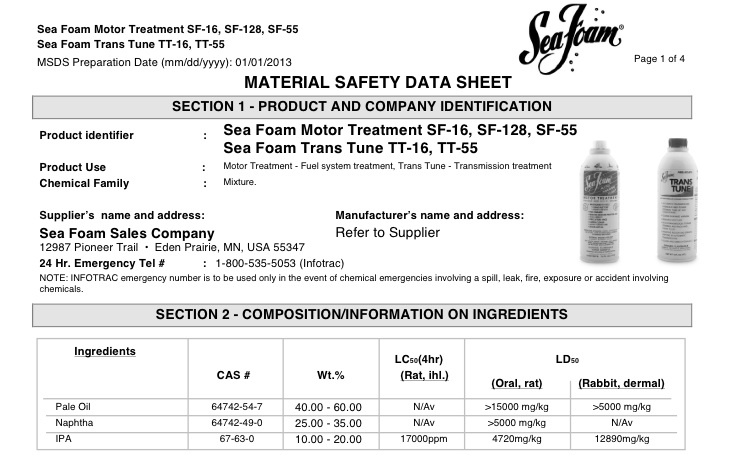

My stihl polesaw was giving me the same symptoms. I finally put about 1/4 cup of seafoam in a half tank of fuel, and after running a few minutes, it's all better. Still have no idea exactly what the problem was...... . No ethanol gasoline is a must for all small engines.
