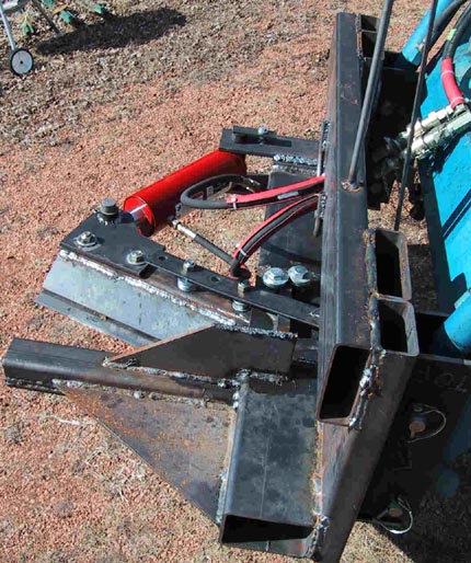

Here is a picture of an almost finished tree snipper which is a knock-off of a tree snipper
I'll post interim photos as I figue how to post pics /forums/images/graemlins/confused.gif

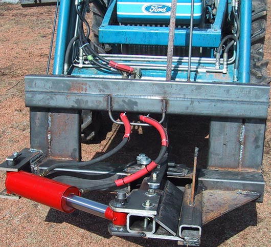

   / Tree snipper
#2
Pic # 2

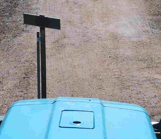

   / Tree snipper

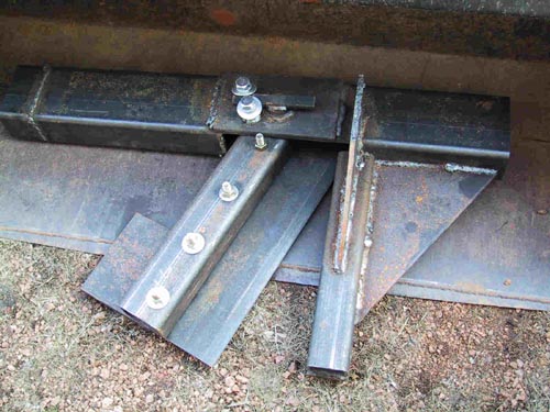

On the last pic notice the flat bar on the moveable cutter. It goes behind the snipper and sticks up as a flag that tells me where the jaws are (open or shut). You'll notice a vertical rod welded on the top cross member. That lines up with the stationary cutting bar. The flag moves relative to the rod,since I can't see the snipper from the seat The rod lines up the opening of the snips. Here is what I see from the tractor seat when the snips are open.

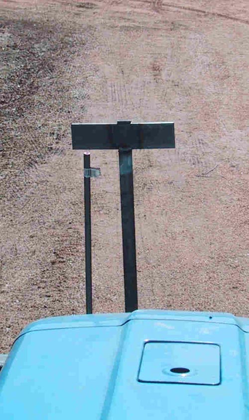

   / Tree snipper
Here is what I see from the seat when the jaws are closed /forums/images/graemlins/smirk.gif

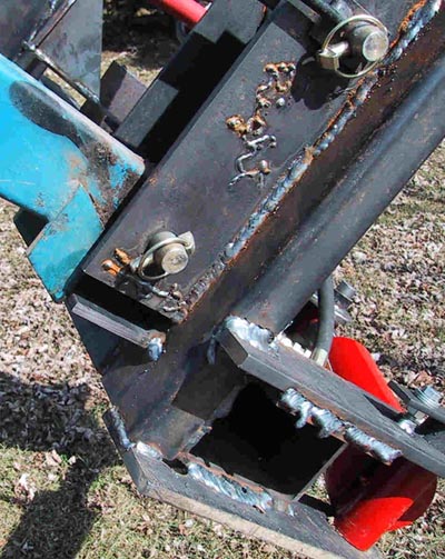

I had to weld a stop so that the whole thing wouldn't go(dump) as far as the bucket. It would pull the hydraulic hoses apart. It's the piece welded on just below lower pin.

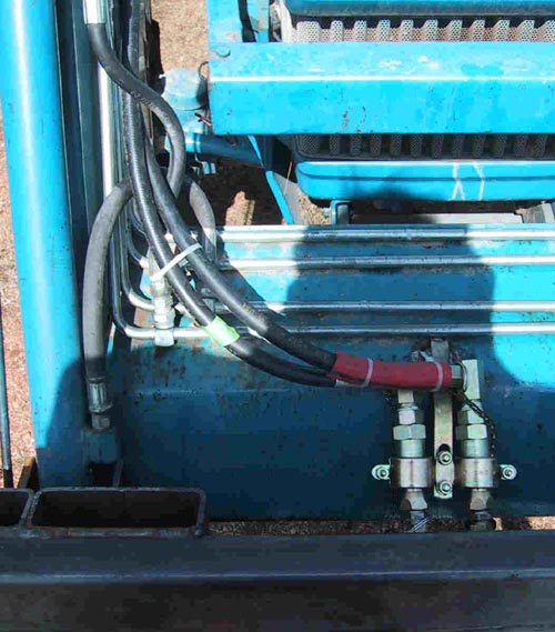

This is the hydraulic coupling in its bracket that automatically disconnects if the hoses are pulled. The bracket holds the knurled sleeve on the female part of the coupling but the whole coupling is free to slide forward and pulling the hoses pulls the whole coupling forward thus pulling the knurled sleeve back and the male couplings pop out.

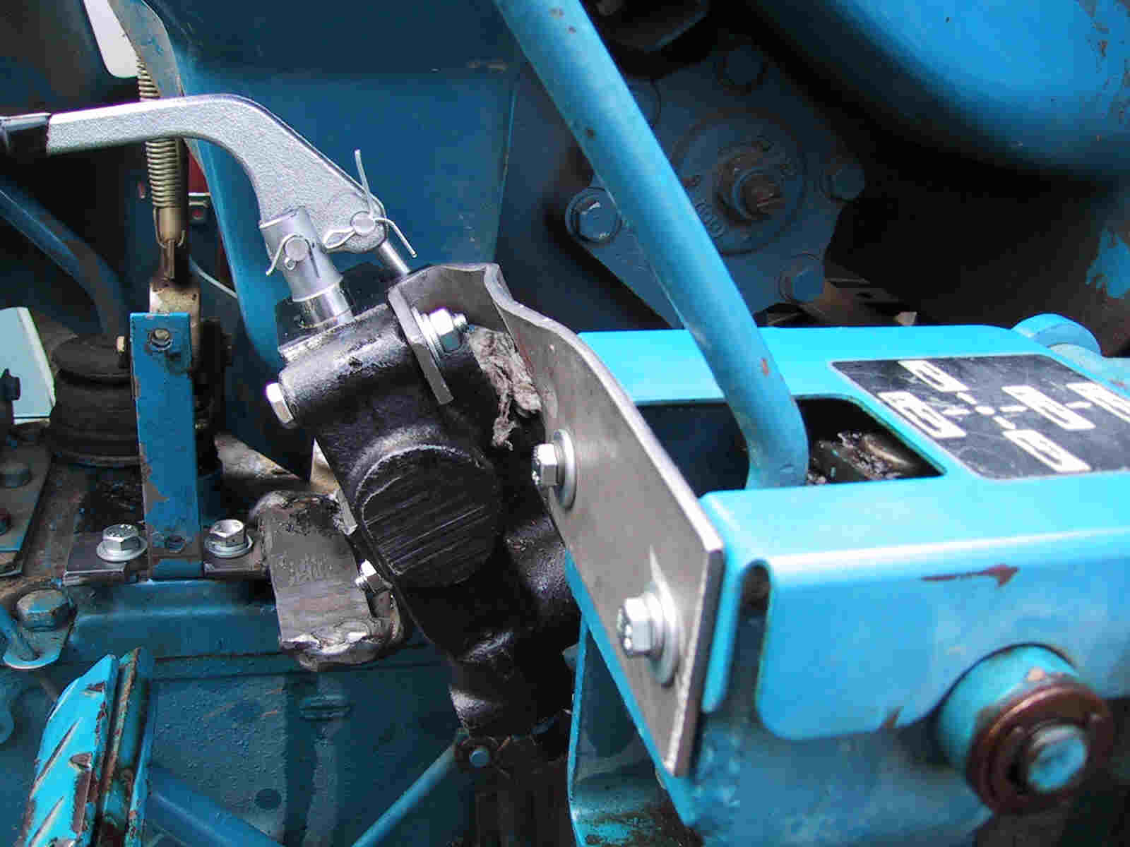

#9
I spent a day and 1/2 making these two brackets to mount the hydraulic spool near and handy to the FEL joy stick. One bracket mounts to the transmission case on a brace that holds the plastic shroud around the shifting links (it's a Ford 1910) The other bracket come off the joy stick pedestal. The throttle linkage had to be worked around-see 2nd pic
I've got $220 of steel. $380 of hydraulics(the cylinder was $200 but I got the spool for $36) Dont ask what my time is worth. I had a neigbor who was a very big help. /forums/images/graemlins/laugh.gif /forums/images/graemlins/laugh.gif /forums/images/graemlins/laugh.gif

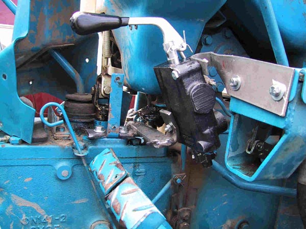

   / Tree snipper
Another view of spool mounting.
