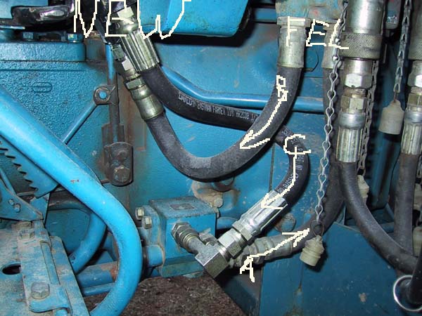

Gerard, here is a labeled picture of the new spool connected in series with the FEL spool. The arrows indicate the direction of flow of hydaulic fluid.
Hose A, an origenal hose was not changed; it comes out of the diverter block to the input of the FEL spool.
Hose B,an old hose comes out of the FEL spool and goes to input of new spool valve. This hose used to go the diverter block where hose C enters now .
Hose C, a new hose, comes out of new spool and goes back to the diverter block.
The diverter block has a slotted bolt head that directs the tractors hydraulic fluid either through the FEL circuit first, then the 3PH or to the 3PH first and then the FEL circuit. With the latter setting the 3PH has to be up for the FEL circuit to work- a pain in the butt /forums/images/graemlins/frown.gif
I see that my Adobe Photoshop labels look pretty crude when seen on the bigger image but I think they are readable.

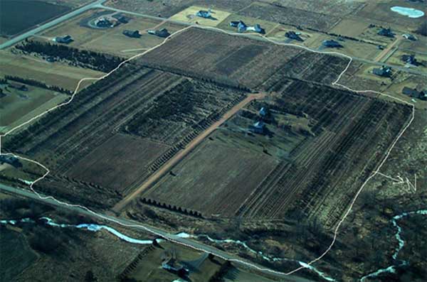

Beenthere, actually I have an 84 walnut tree plantation planted about 20 X24'. These are the American Forestry Technology/Purdue U trees with the 4' nurse tubes on a 10' 3/4 " electrical conduit. I put then in ~ 7 years ago and some are ready to be detubed. The walnuts are just north of the house. I'm in the middle of ~55 acres.
