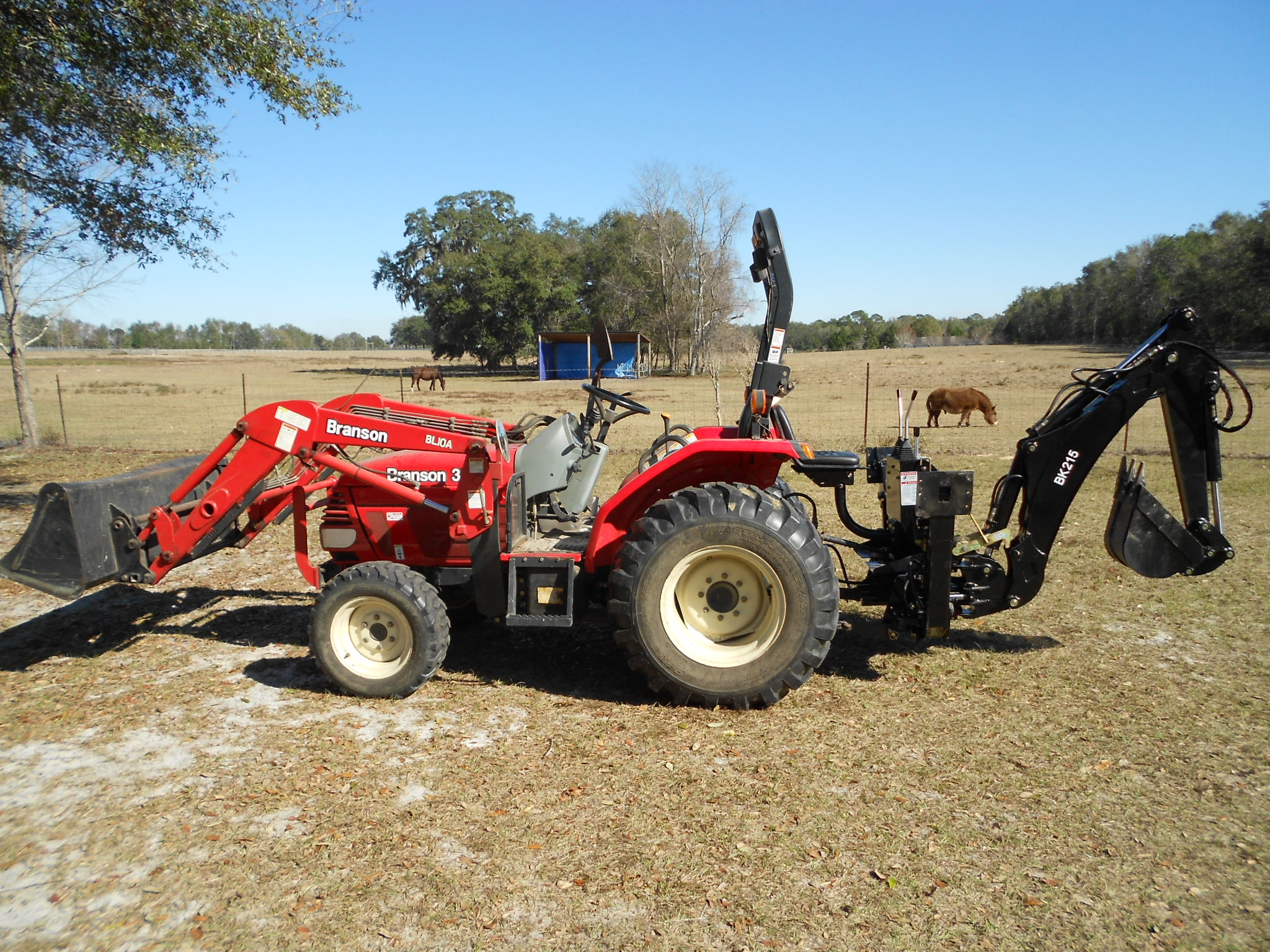

I had a Jinma Hoe and last year I bought a new BK 215 that I am using on my 3510 Branson.
I am using tractor hydraulics and only run tractor at 12-1300 RPM and have plenty of digging force.
You might try backing off on RPM to find the best setting.

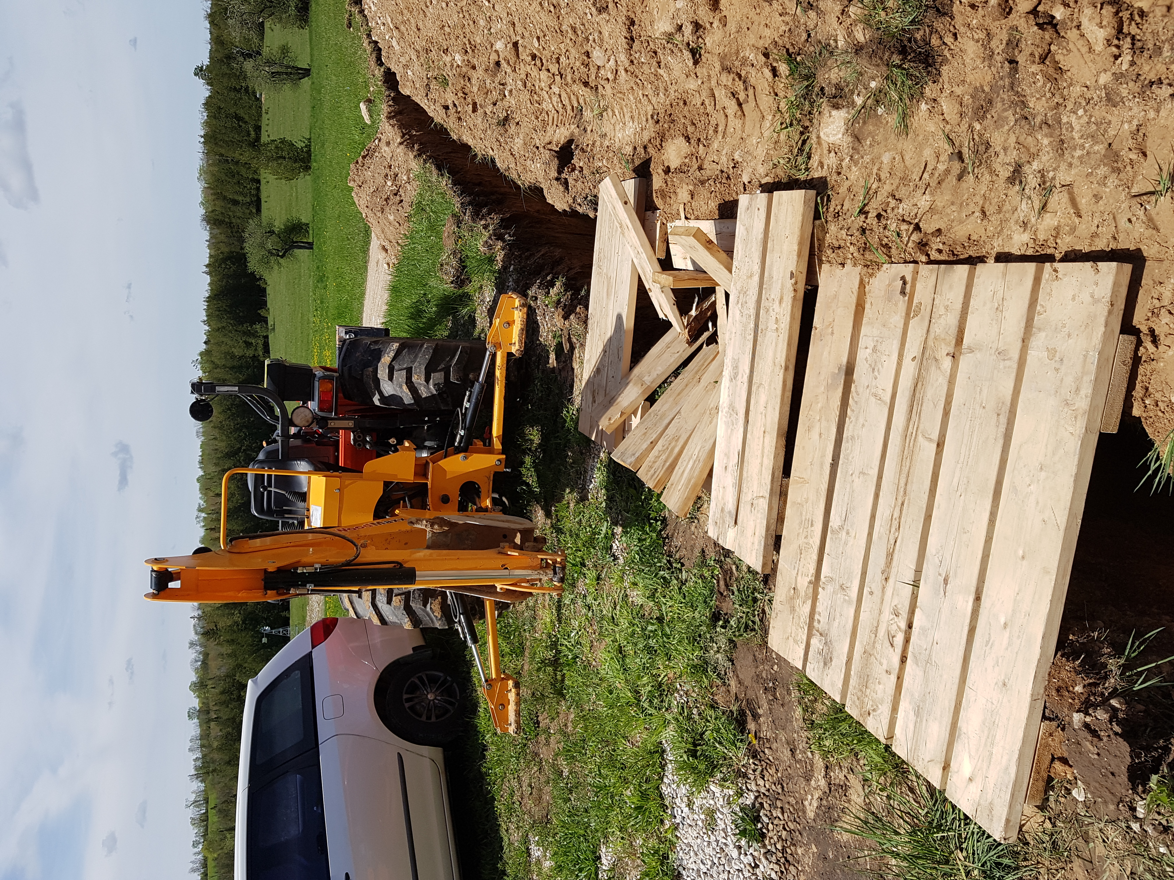

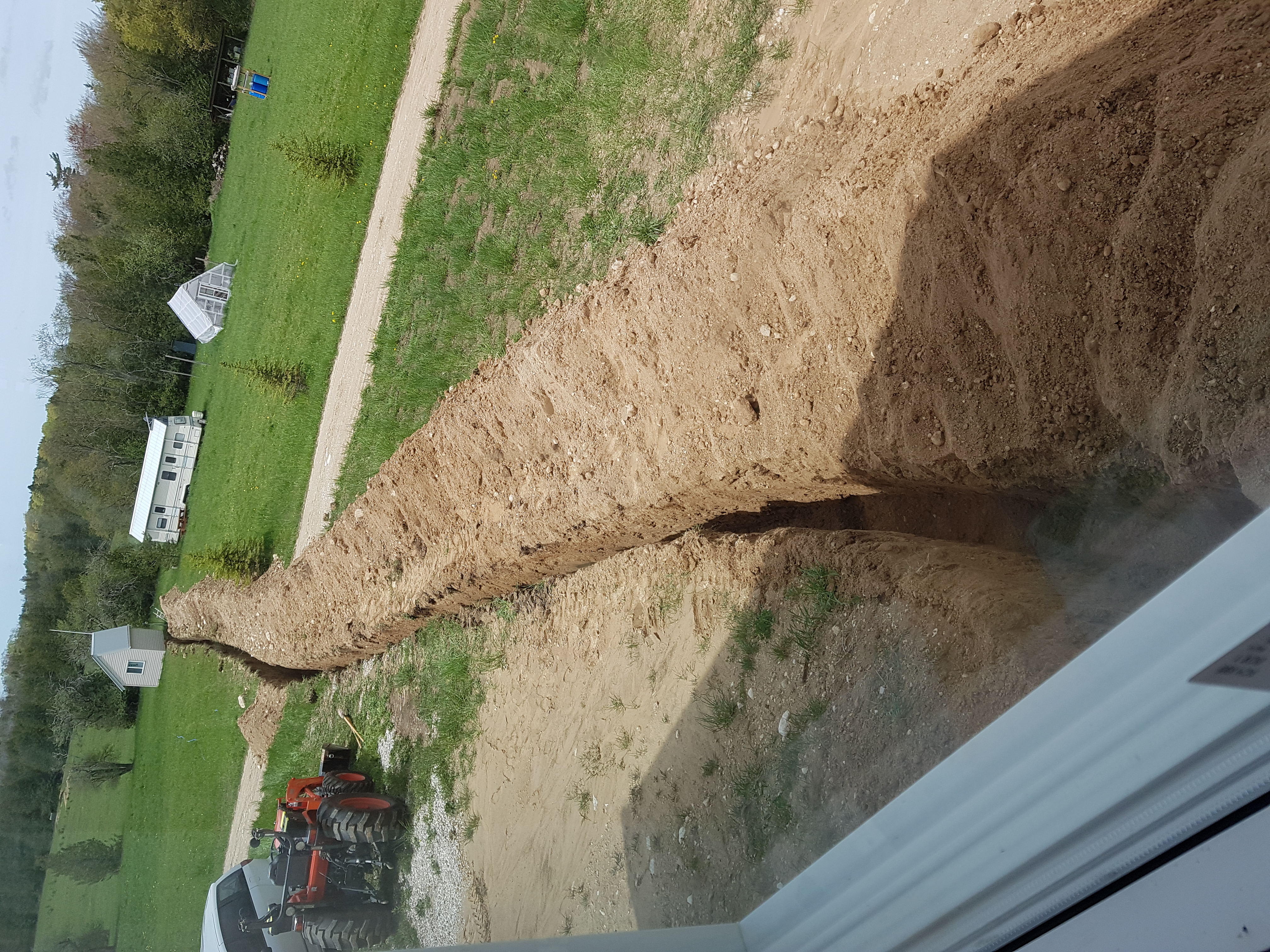

Back in town after 1 full day of digging. Everybody said, "practice, practice and more practice"; so I practised a full day, but somehow didn't work for me at the end of the day :). I see smooth movements but slow only if 2 movements are done in the same time. Anyhow, I'm almost there, the water line is in the trench, pressurised with no leak. Next weekend I'll drop the conduit with wires, and put back the soil.
Lesson learn today: don't underestimate the weight of the machinery. For last 30ft I had to start digging from the house to the pump, so I finished being with the tractor above the trench. To be able to move the tractor out, I built a quick platform using 2x10 and guess what? a few pieces broke. Almost fall in the trench. I fell the rear side going down so I push the throttle to the floor and able to climb out. Not a pleasant moment. Here are couple pictures.

Nice job!
Would you have been able to back the tractor to the side of the ditch and dug at a 90 degree angle? (keeping you from having to drive across)

Nice job!
I tried but didn't work. The ground around the house is not levelled yet, so I couldn't setup the hoe support feet.
