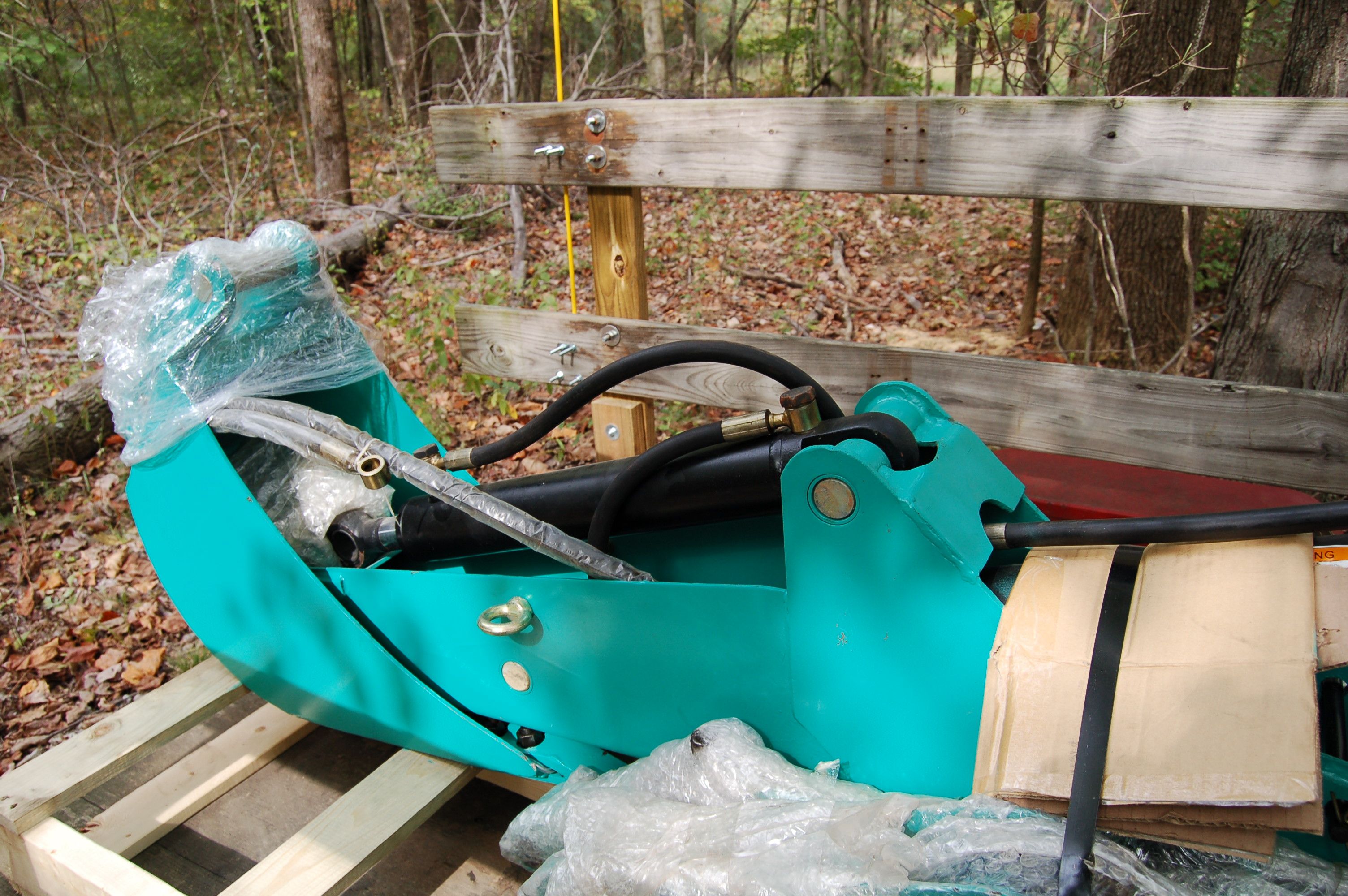

Mike I went outside and just measured the cylinder diameter and it was 2.9" So as an estimate I would say I have 2.5" cylinders. I'm assuming that bigger the cylinder the more powerfull the hydraulics? Or is it a combination of both the cylinder size and the stroke.
Wedge
/ Trench Master Backhoe. #23
2.5 would be about right for that size of hoe. You are right that the bigger the cylinder the more power, given the same system hyd pressure. Power is a combination of diameter of cylinder and the pressure. In your situation then the surface of the piston (not the rod side) is 4.9 sq inches. OK say you have a system pressure of 2000 psi then the force that you can generate on that piston is 9,800 lbs of push. If your stroke is 16 inches the volume of the cylinder is 78.4 cubic inches--or .34 gal--about a third of a gallon. Given that your system has the capacity of 4.5 gpm then theoretically it would take 4.5 seconds to fully extend that cylinder.
If it were mine, I believe that I would hook it up to the existing hyd and see how it performed. If I deemed it too slow then I would go through the process of adapting the pump. Just my opinion.
