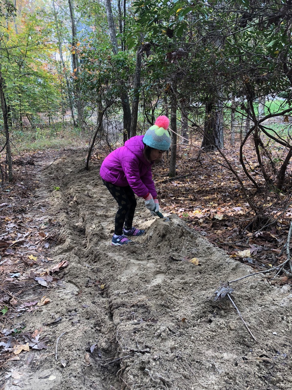

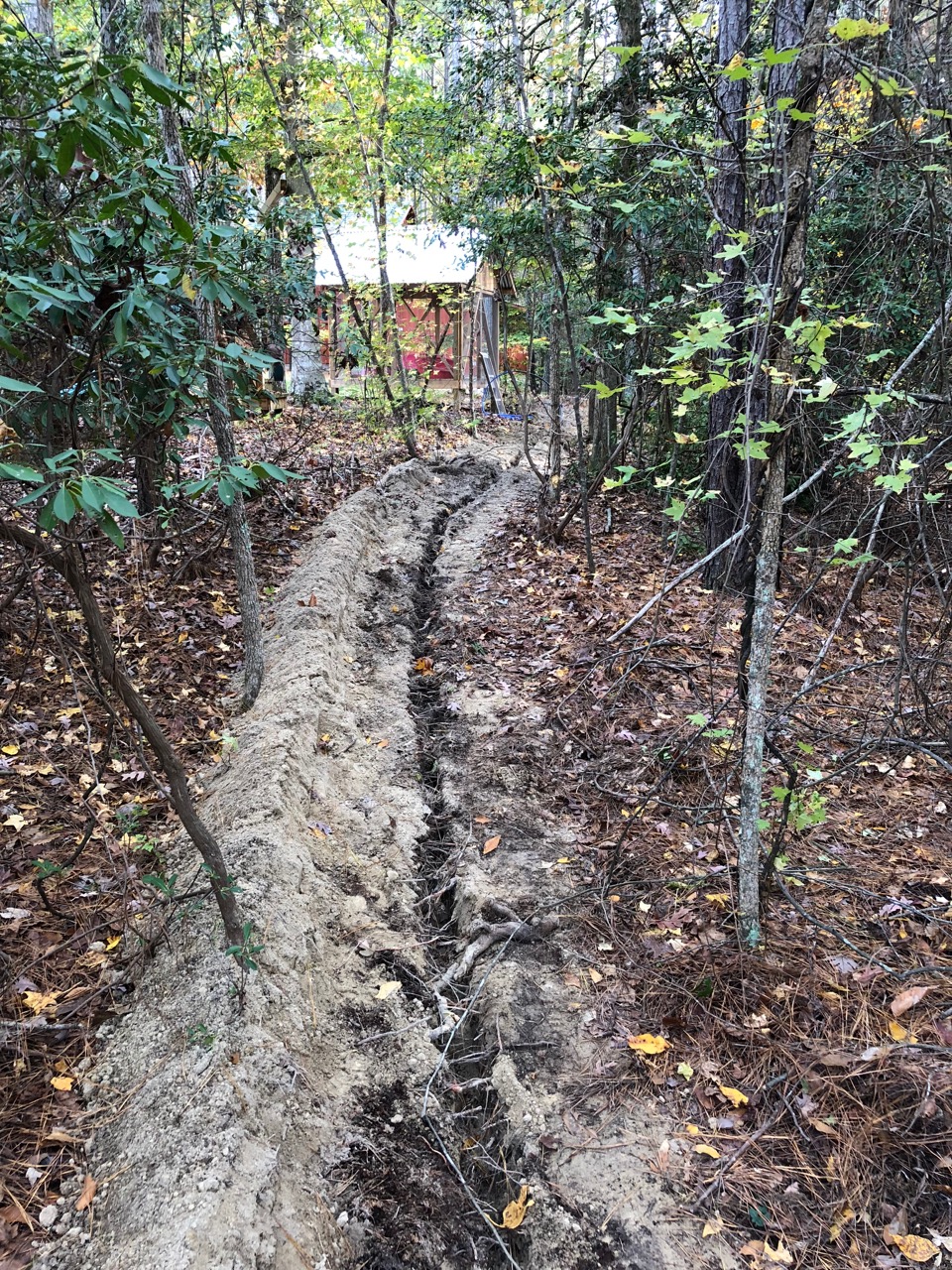

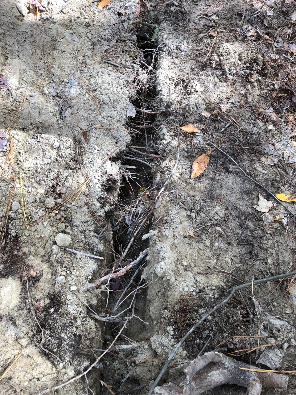

Last trench I ran was through sandy soil -- nice enough sand that my daughter wanted to play in it. You'd think that would slip right back into the trench. But there was such a heavy/thick root mat on top that I still had problems getting the sand back in the trench. Had to push it past the roots and it was a fight.
