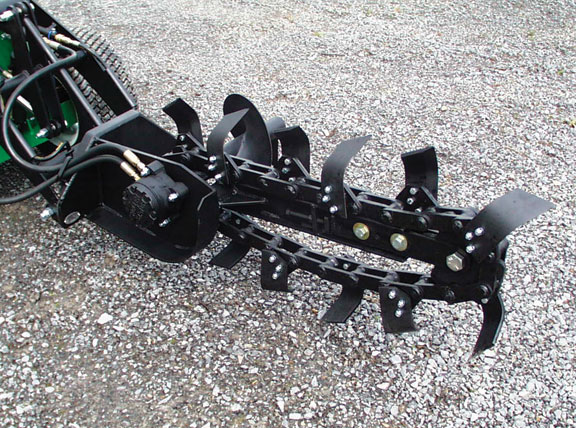

My chain is worn out also, and when I called them about prices, it was way up there. If the chain is worn out, the sprocket is worn out. However, I am going to weld and build up the worn side, and see if I can get a little more use out of the chain. It's to bad they don't make replaceable links, or maybe somebody does. . You could just build your own, or replace any defective link. [ PT's insider ], Now don't tell the customers where we get our trenching chain, and don't give out dimensions, and for sure, do not show them any pictures. I forgot, don't tell them how tight the chain should be. We want them to wear that sucker out real fast.
I will tell you, that when it is working as advertised, and pointed almost straight down, it will dig a 4 ft trench fairly fast here in out Florida sand. I also have the wheeled trencher which will double as a stump grinder.

I had been thinking about building up the worn side of the sprocket with hard surfacing, but I am in doubt about the logic. I am thinking that it will just wear out the rest of the chain faster. My roll links are worn down to the pin in some spots. If only the joints were bolted. You can't weld the rollover link, as it would weld the pin also. Bummer.
You know, I just might try and make some parts that bolt together. I guess the critical part is in getting the valley measurement correct. Might even be able to reverse the sprocket and save expense on them. That sprocket might also have a tapered shaft, and that would put that idea in the dirt. Pun intended.
If you have to replace a chain, you have to do the sprockets also, and that is just about everything except the hydraulic motor. At $500.00 for a replacement chain, it will have to sit for a while.

I remember looking at J_J's chain the first time Mr. Jimi (rest his soul) and I went to visit him. It didn't seem like a hard project to make new parts, once you got set up to do it. Somebody like 3RRL could probably turn out a couple a day from his shop and not even fire up the standby generator. Somebody with more time than money could sure do well making the parts and putting them together.

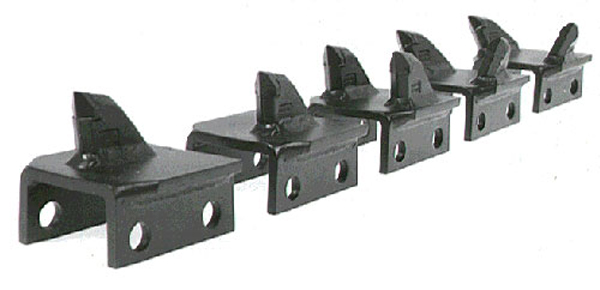

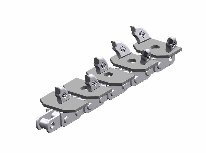

I found this aggressive chain on the net.

JJ that first one is called a gator back and the second is called Sharks teeth. They work wekk only in had rocky soile the firsts it really ment for super high concentraions of rock.
