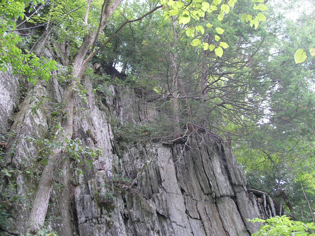

Well, I do hope it goes as you say but keep in mind that soil conditions vary greatly with location. I assume Florida is flat with few rocks but I'm in a rugged mountainous location with rocks all over the place. No telling what I will run into once I start digging. I would think a very large rock would bring a trencher and a hoe to its knees. After reading oc3crwler's post it may be a good idea to first experiment with my hoe to get an idea what I will run into and then try to come up with a plan.
I think that is the prudent plan. My experience with my own glacial till was that the larger rocks are near or on the surface and tend to run in groups/veins. In my case bedrock is way down and not to worry about. Since I had multiple projects going on at the same time I used an excavator to make 3 trenches(5ft deep and 250 ft long each) in about 4hrs time with probably 1 hr dealing with larger rocks.
