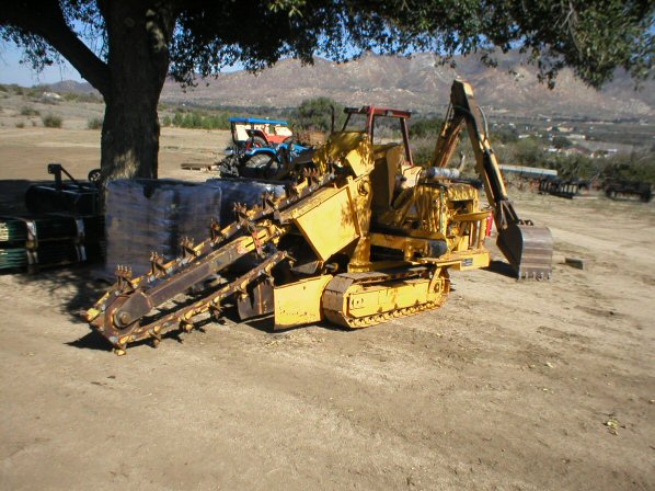

The guy that we bought our Parsons Trencher from had a Vermeer that would dig a 36" wide trench and I think that he said that it would dig 10' deep.:eek: He also offered to sell it to us for $1, all we had to do was pay off the balance of what he owed on it. The balance was a tad bit more than what we wanted to pay for a trencher though. :rolleyes:
Anyway, our trencher old and wore out as it is, has dug over a mile of 9" wide trench, 54 inches deep for us. The carbide teeth cut through solid granite, only have to drop down one gear for speed. :cool:
