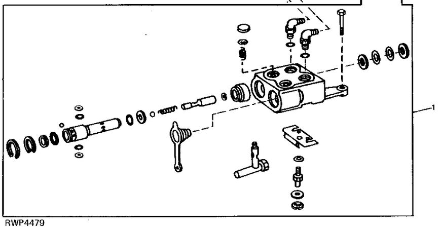

   / Trick to connect hydrolic hoses of snow blower to tractor. #7
any chance of some pics?
   / Trick to connect hydrolic hoses of snow blower to tractor. #8
Here is something from the parts catalog.
