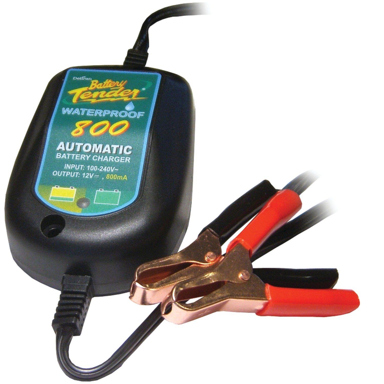

I have a 2670 and I was wondering if anyone uses a trickle charger on their tractor during the winter months?...
Is it O.K. to let it on all winter?...
Thanks--BCBSLICK...
/ Trickle Charger... #2
I wouldn't personally use a trickle charger. I use these full-featured Deltran chargers on everything to keep all my equipment batteries in shape. They don't constantly charge the way a trickle charger does. They actually monitor battery state and charge as needed. I leave them connected to my tractors, boat, idle cars, and generator all year long.
Amazon.com: Battery Tender 022-0150-DL-WH Waterproof 800 Battery Charger: Automotive
Z.

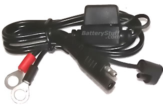

Do you just hook to the battery terminals without disconnecting anything?...
Then remove when ready to start the tractor?...

On my Genius I hook up a set of leads that stay on the battery so when I charge I just plug in the connector.
/ Trickle Charger... #10
The tender DC cable has a connector and fuse in-line. They come with two different ends: Those clamps for a quick connect, and a set of rings for a more permanent installation - but you can still unplug the cable in the middle when using the machine. There's a nice little dust cap that covers the end of the cable when unplugged.
For my more-or-less permanent uses, I use the rings. They go under the battery terminal clamp bolts or nuts and stay attached.

They come with clips, or a cable that has battery connectors on one end and an SAE connector on the other. You live the "pigtail" in place and unplug it from the charger when in use.
I have them on three motorcycles, two snowmobiles, a generator and the tractor.
