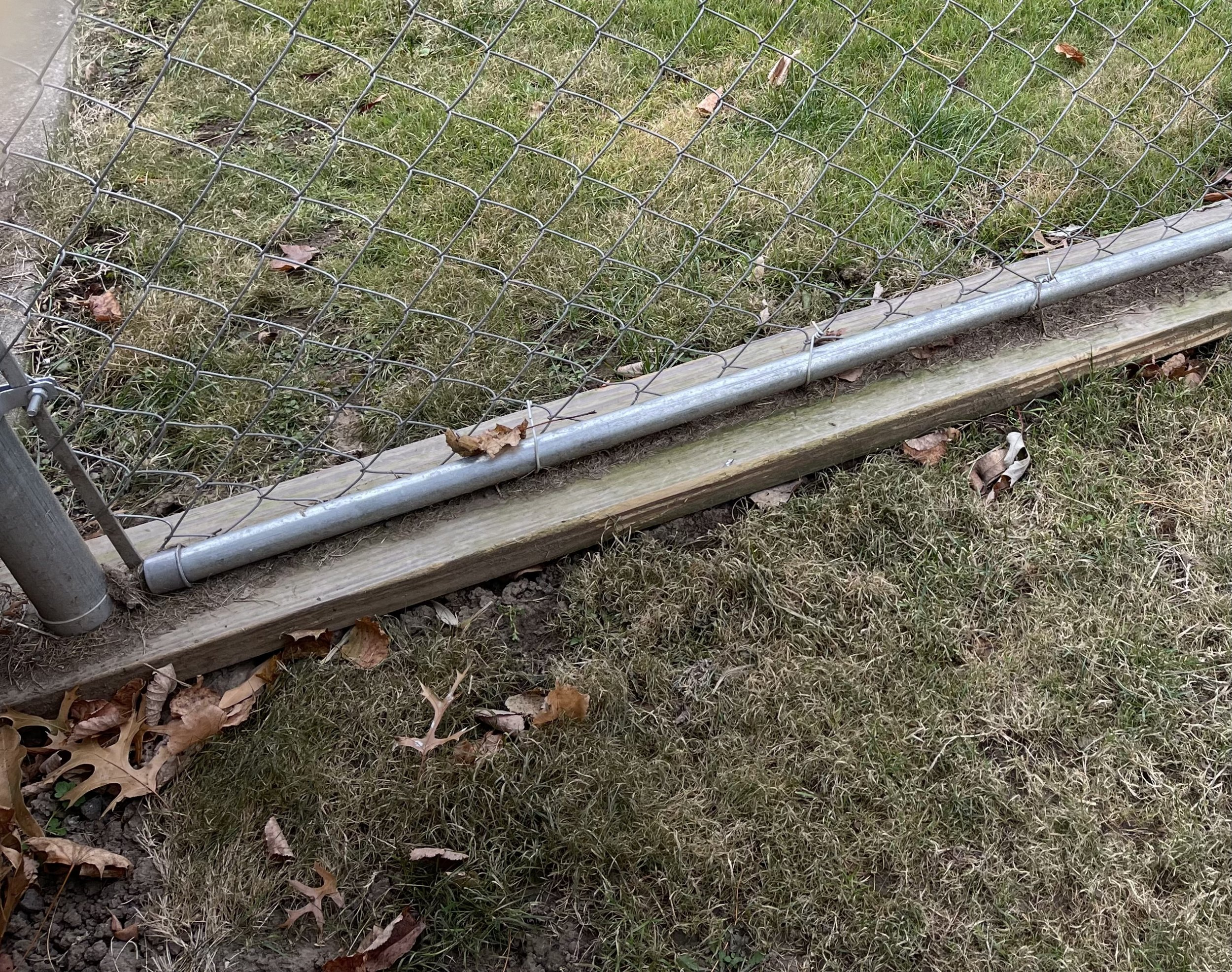

Here’s my solution, I have just over 1 acre fenced for my dogs. I too didn’t like trimming the fence line, 2X8 treated drilled out to go over the fence posts, and then a bottom bar to tie the fence to allows me to mow right up to the fence without a lot of trimming, and keeps the dogs from digging and pushing under the fence.

That doesn't seem very practical if you've got a couple miles of fence. I'll stick with glyphosate.

Yeah, I used railroad ties, half posts and 4x4's.
I had a demon dog, he was big, his jaw power and teeth basically wore out the chain link. He just kept tugging at it until it unraveled.
At least he did not get under the fence. I sunk field fence under all the wood.
He just wanted out and to always be with someone.
