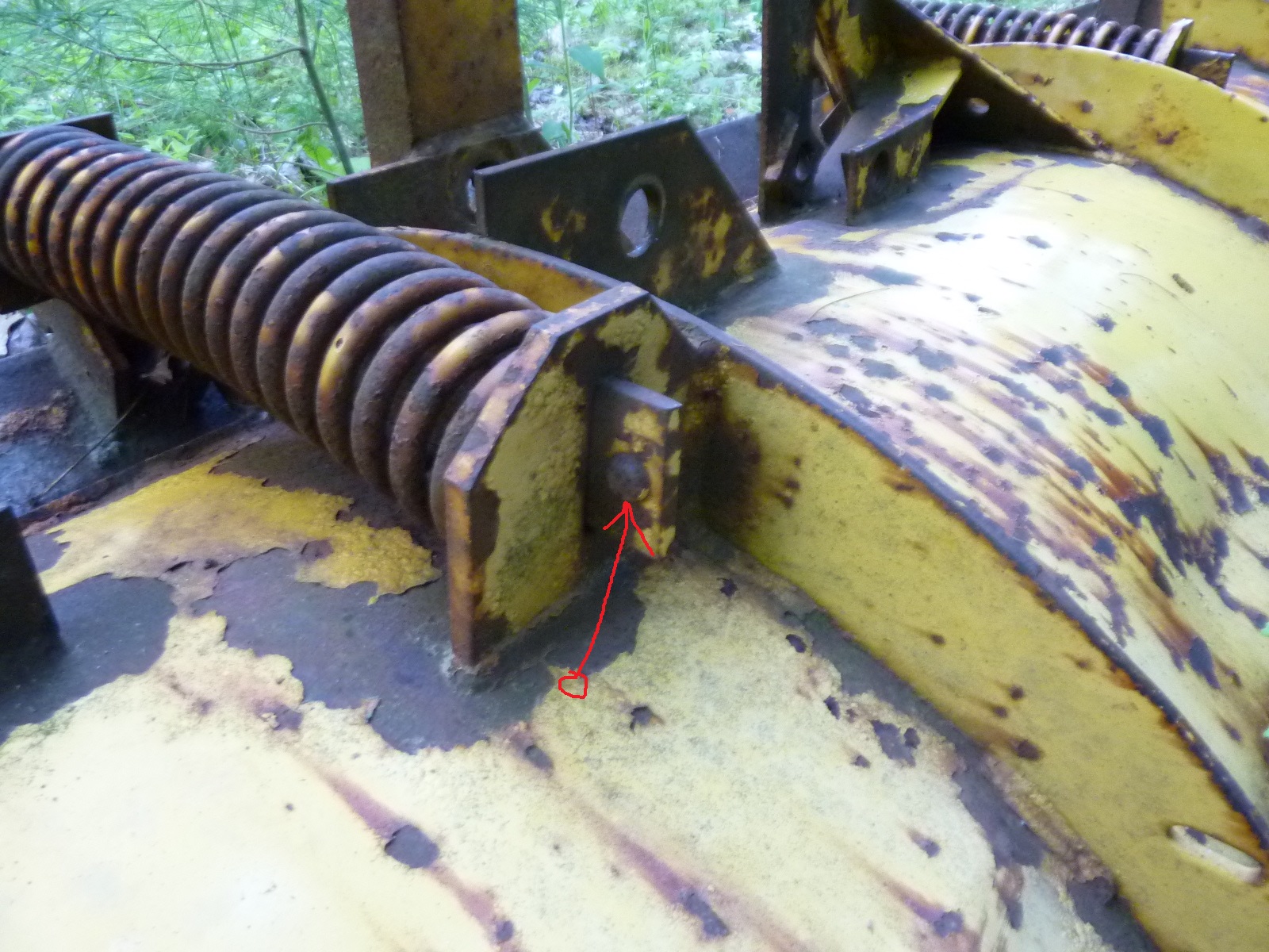

I am going to do some rehab on an old Fisher plow and want to remove the trip edge springs, One of the spring assemblies has a rivet on the top of the bar which retains it on the plow. It can't see any purpose for the rivet but before I grind it off I thought it would be best to ask why it is there. I plan to use the rod thru the coil and turn with a pipe wrench to relieve the tension technique to remove the spring assemblies. Thanks

What does the opposite side of the bar that the rivet is in look like inside the spring. Probably retains the spring. Bob

Yes the rivet was Fishers retainer once it's removed you can use a bolt in its place or nothing.

I don't think I will have trouble getting it off. There is a hole in the bar about 2" below the top of the spring. Just put a rod thru the coil and that hole and turn the spring with a wrench to "screw" it down into compression removing the pressure at the top against the plow. The bottom of the bar is bolted into an open clevis piece on the trip edge. Remove the bolt and bar and spring will slide down and out as an assembly except for that rivet which I want to cut off.
I just would like to know what they put that rivet on there for before I cut it off
