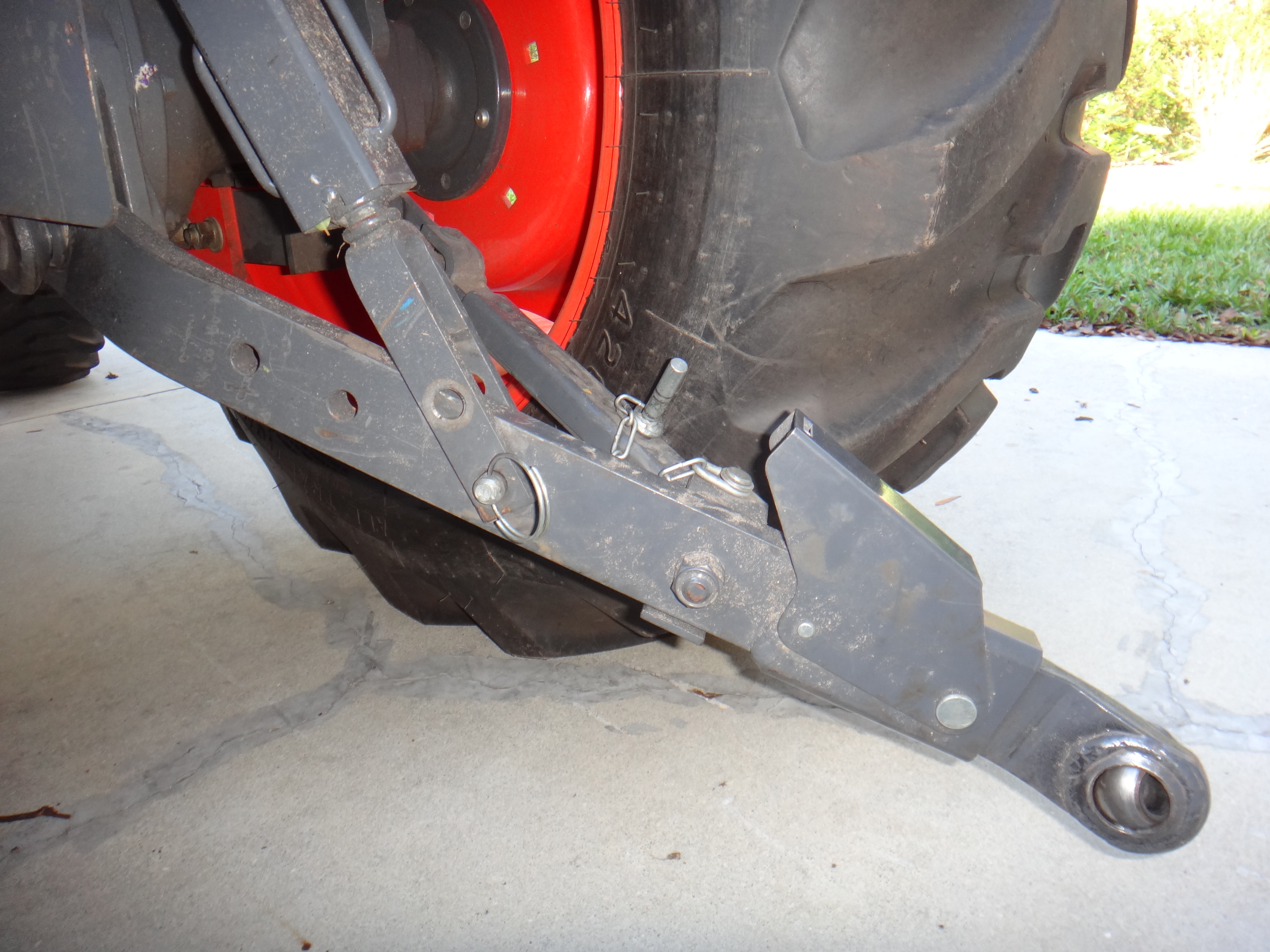

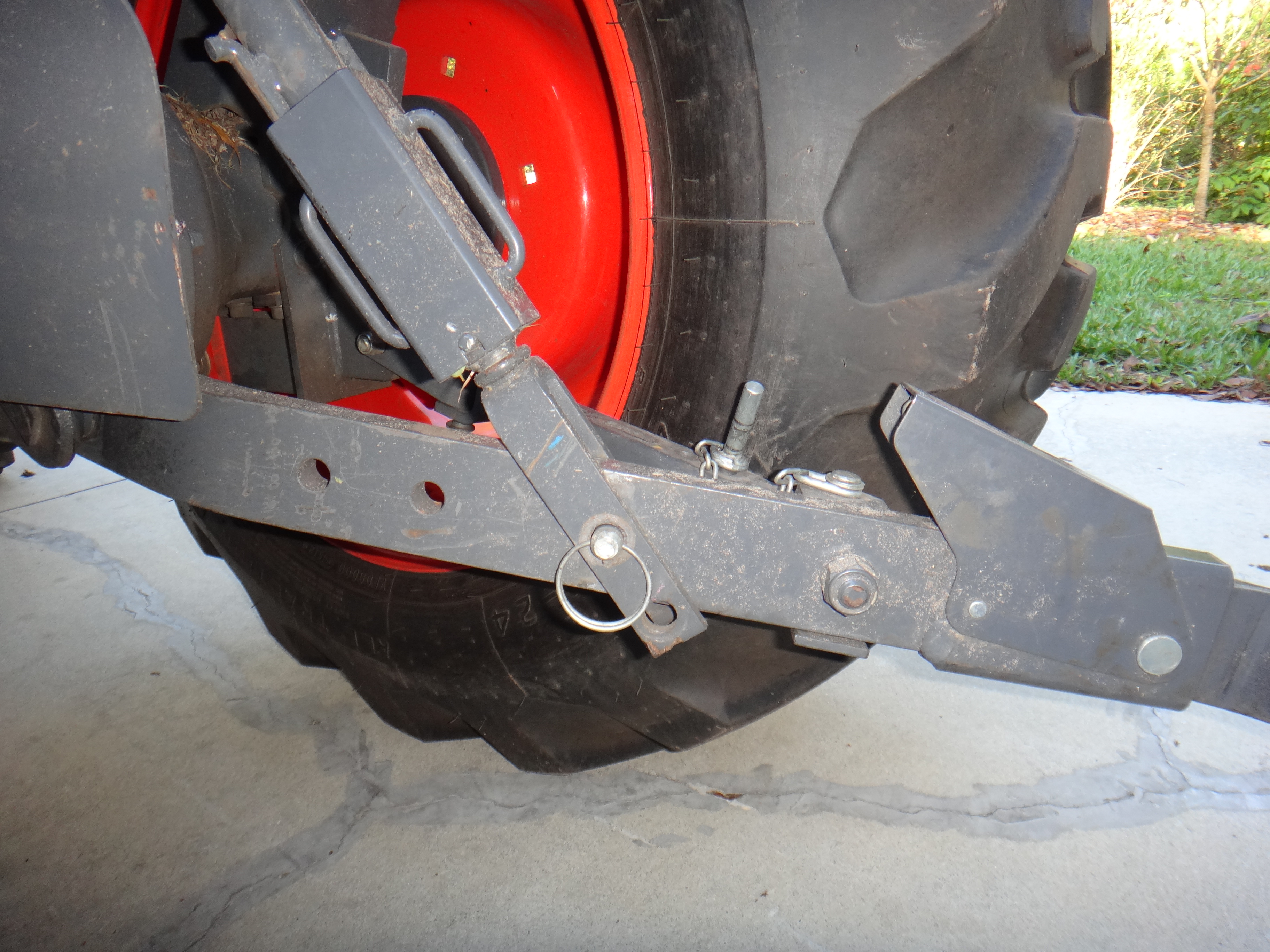

RE: 2" ground clearance.
I trust your Lifting Rod stirrup pin adjustments are positioned in the 'normal' UPPER holes (Photo #1) and not the LOWER holes (Photo #2) ?
