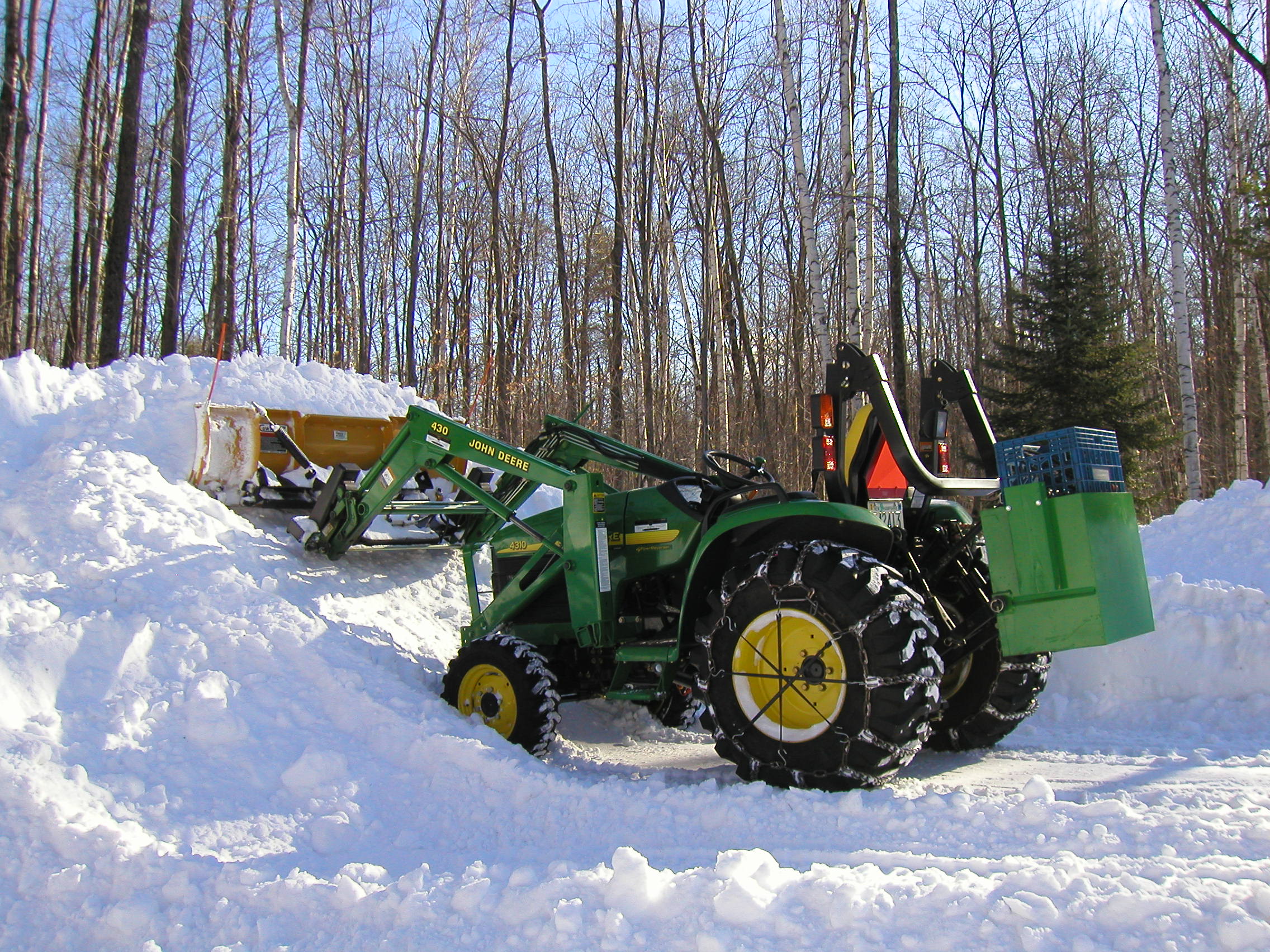

NHbot- I was referring to how your plow is connected to the loader arms. Have you considered a quick connect device?
PILOON- Thanks for your explanation of the relief valve. Makes sense. It gives me a better understanding.
The attached pic is of one of my bigger snow piles.
Since the areas I plow are all dirt/gravel roads, I set the skid shoes down enough to lift the blade up in the beginning of the winter. As time goes on and the roads ice up. I set the blade lower to scrape the new snow clean. It also makes it smoother with less obstructions to trip up the plow.
Chuck

I did look into changing to the quick connect system, but it extends the implements, and I loose weight lifting ability.
Changing the pins out really isn't that bad once you get used to it. I learned the biggest thing is to have the tractor and implement on solid level ground and it will go much quicker and smoothly.

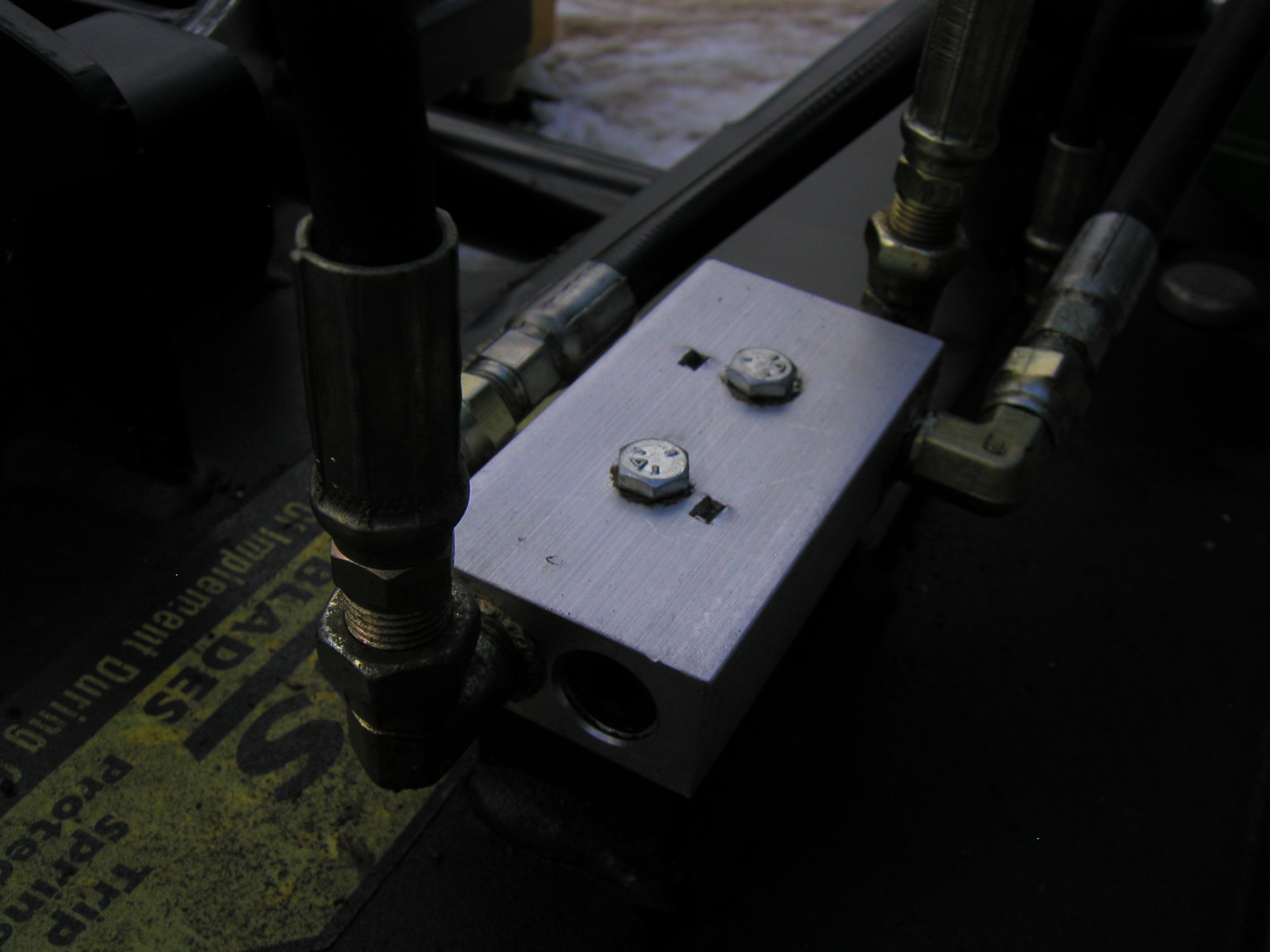

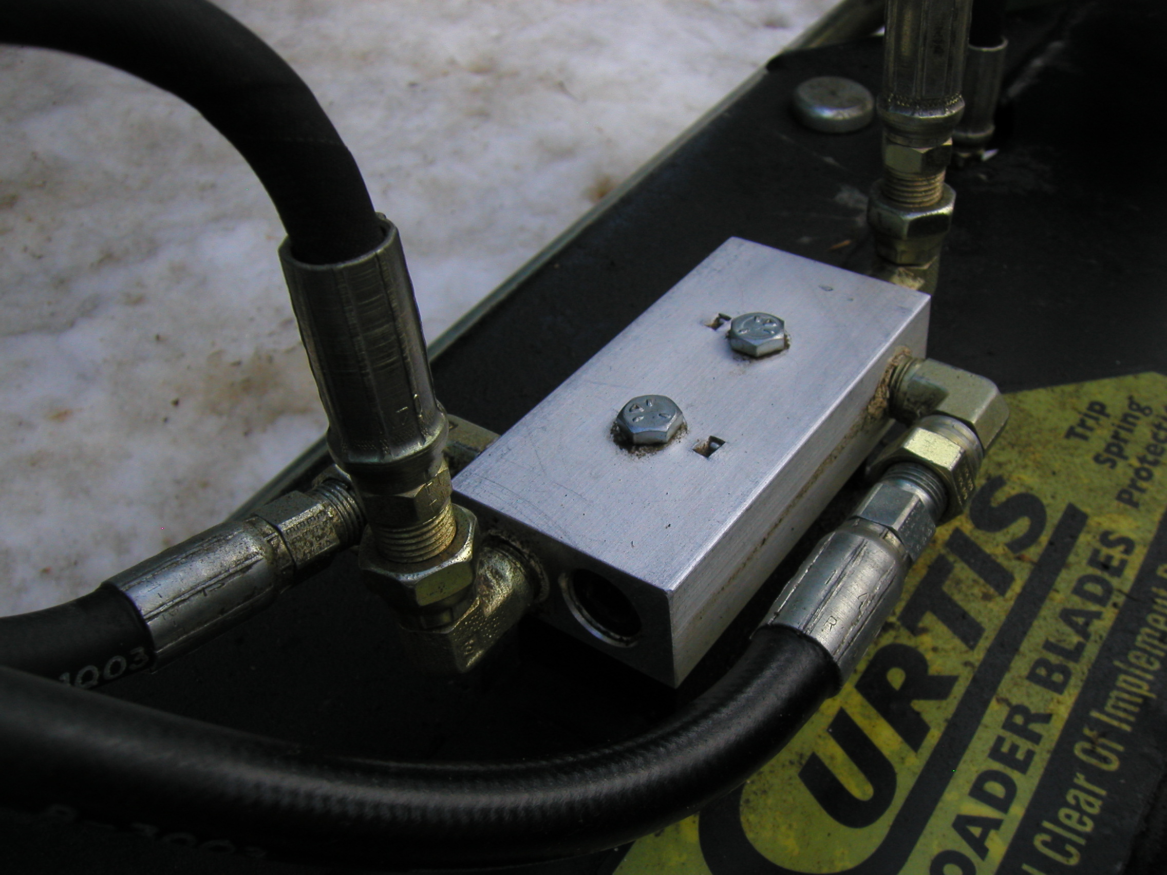

I'm assuming this is the relief valve.
Anyone recognize it or can educate me further?
Chuck
   / Trip springs on snow plow were too stiff #16
Yes, that is your crossover/cushion relief valve. What is in the other hole on the ends, and witch hose go to the cylinders-the ones on the end or the sides?
#17
kennyd- The side hoses ( those facing the loader arms ) go to the cylinders. There is an extra plug/blank in each side.
Front and back are from tractor.
Chuck
   / Trip springs on snow plow were too stiff #18
There could possibly be an adjustment under those plugs-but I think you should leave it alone...
