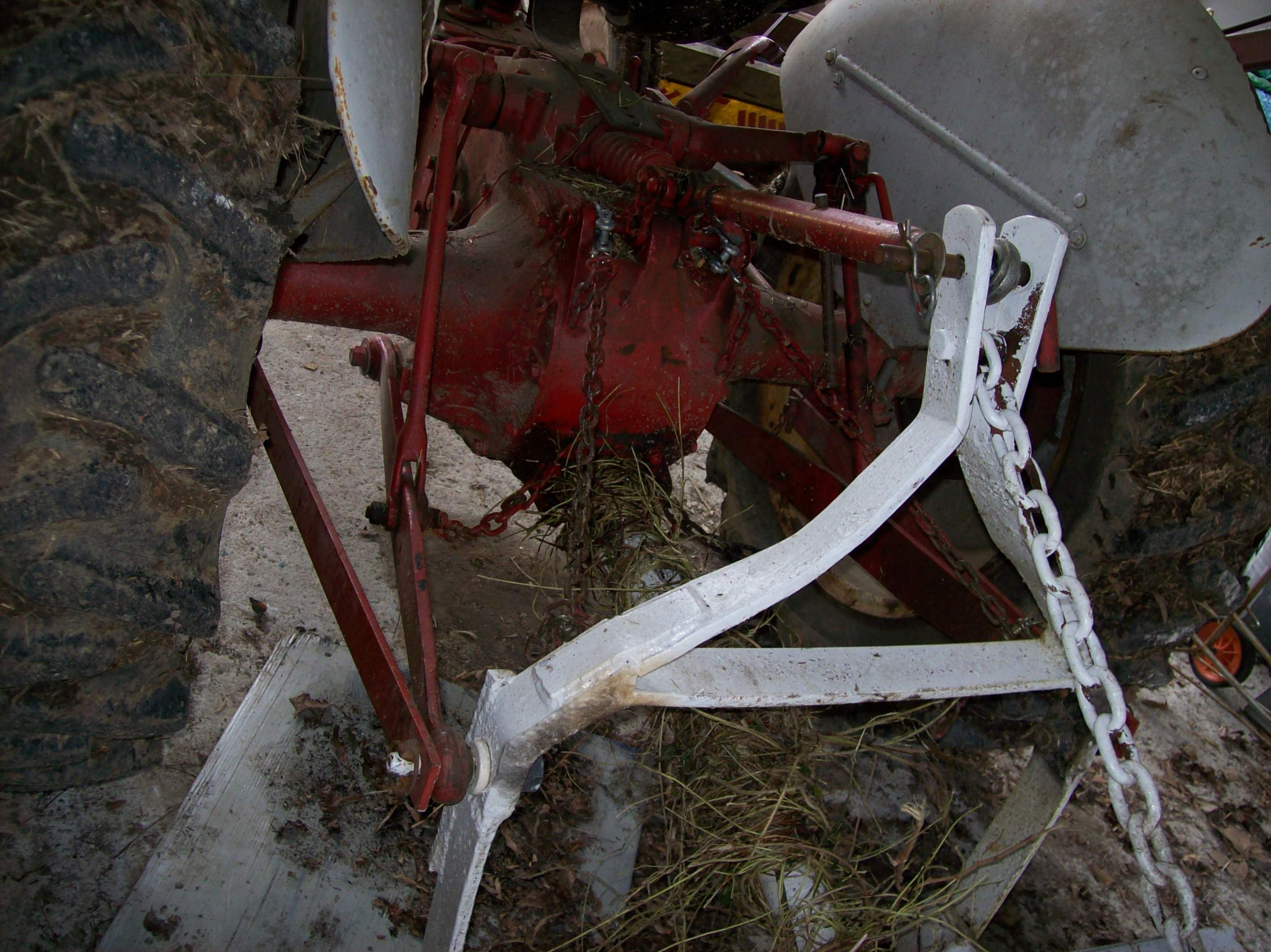

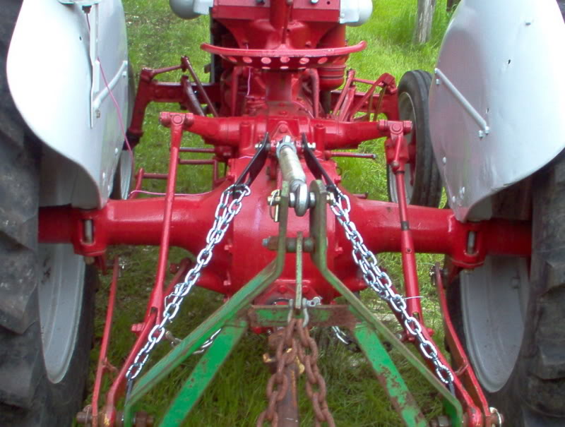

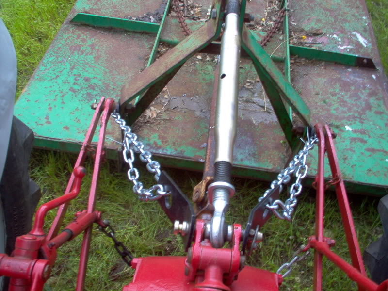

I welded 2 rings for chain attachment to my rotary cutter near the lift arm pins and hooked the opposite ends to my long top link pin on my 8N tractor with D rings.
these pictures below I got from the internet shows the proper way to do it, but I did not want to buy the chain kit with the pin/chain plates.
A setup like this should work for your Ferguson.

4 quick links and 2 sections of 1/4" chain. Safety wire the links and you should be good to go. Probably less than $20.
   / trouble keeping brush hog at right height #15
DO NOT USE QUICK LINKS.
I have used Quick Links. Bouncing of the tractor and Hog soon separates Quick Link components into individual pieces.
Use much stronger Clevis Links only.
See LINK in Post #5.
