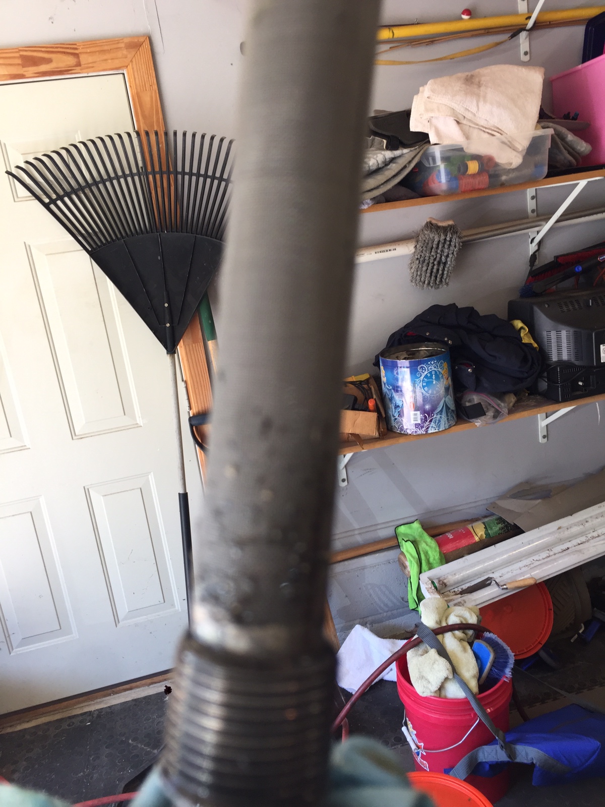

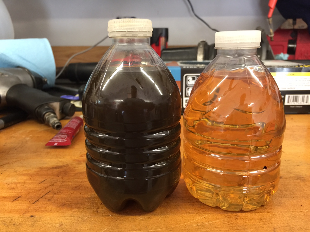

So I got around to serving my Bx today. I am right at 947 hours to be exact. Changed engine oil , hydraulic fluid and the two fuel filters. Just love changing that bottom fuel filter. Checked the strainer and it seemed like it was pretty clean with minimal stuff on it. Not sure what is considered bad but if I recall mIne always looked the same for each service. Here are a couple picture of the strainer and the difference in new and 150 hour Kubota Super UDT2. I didn’t get to put it through the paces yet but I will maybe run it around Tom oof I get a chance.

Was having the same issue with my, admittedly poorly maintained BX2200, same loss of speed and power on hills, same whinning. I changed all the hydro fluid and filters, cleaned the suction screen, all was back to normal, nice and quiet, plenty of pull. In my case it was water contaminated hydro fluid.

I have a BX23 with 860 hours on the clock. I run my transmission fluid changes to the required hours, sometimes a little longer and I have never ever been able to easily see the difference in colour between the new and used fluid. When I see the colour of your used 150 hour oil I would say it was burnt or contaminated. If I had your BX23 I would be checking for problems based on what I see with my BX23. I work my BX23 hard, I do not baby it.

I did check that and it seemed ok to me as long as I was looking at the right thing. I will check on it again. Hopefully the fluid change will be all it needed.

I usually run mine to the required hours also but with the problem I thought I better change. It for sure is darker than the new fluid. Is it burn or contaminated don’t know but doesn’t look good. If it’s contaminated I wonder with what? I will try to get on it this evening and run it around and see what it does. The real test will be on the next mow. Spoke to my cousins who is much more knowledgeable of these than I am and he said if it still doing it after the service he would come take a look at it for me.

Good luck with the test you’re going to do, test mow a section while you’re at it. BTW, I have a B2650 and my hydro fluid comes out pretty clear, I would have trouble differentiating between new and old.

Are the blades still on your transmission cooling fan? If not, you can overheat the fluid. You also have wet brakes in that fluid and clutch materials that can drag and cause an over heat situation. Have you poured any of the used oil through filter paper (coffee filter) to see if the dark stuff is suspended or dissolved. Might help to determine the cause of dark oil.

The fan was mention earlier and its working with all the blades intack. I will take what in that bottle and run it through a filter and see what the results are and report back.
