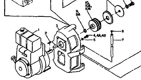

Yes, I have two belts installed. I dont see the purpose in it. I did do the predator swap. Besides a leaking tank, I am having a engine pulley problem. When I tighten my new pulley mounting bolt to the engine, it tightens the pulley to the base of the engine housing. It causes rubbing, and hard starts. Rope does not want to pull..... You maybe laughing but how in the heck do I secure the engine pulley without smashing it against the motor?
   / Troy-Bilt Horse engine swap #54
Ok. I am sitting here thinking do I just need a longer pulley mounting bolt? One that allows the pulley to "wander" down the engine shaft.
   / Troy-Bilt Horse engine swap #55
There should be shims to adjust the pulley spacing from the engine. I just changed engines on mine and had to add some.
Parts 9 and 9A in this diagram:
Bruce
   / Troy-Bilt Horse engine swap #56
Thanks got it shimmed correctly today.
