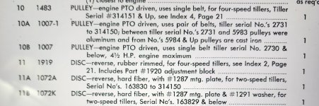

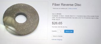

This is in response to a very old post so I hope someone sees it. I have a mid-70s vintage Horse 2 speed that came with a defunct 6hp Tecumseh (serial number 162677). The age is my best estimate and I have re-powered with a 900 series Briggs. As you can see from the attached photo, there are 3 (I believe threaded) holes that accommodate the Allen screws mentioned by another poster; however, there was never a reverse disc on the machine since I've had it. Now looking to find said disc because I'm too old to be wrestling the thing around. My parts catalog says part no. 1072k with part no. 1287 mounting plate (see attached schematic and parts list). I've see no hard fiber reverse discs with 3 holes in them for the Allen screws. Any help appreciated.
   / Troy Bilt Horse reverse disc (model question) #15
