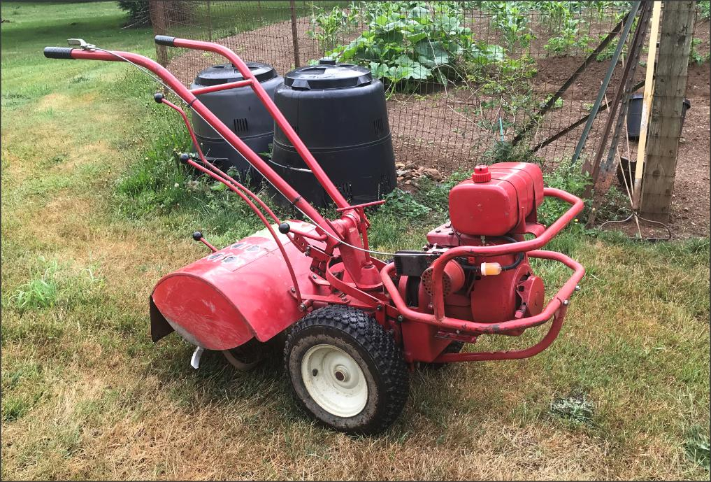

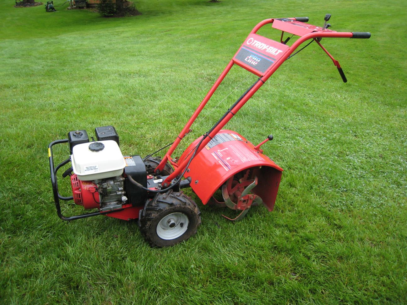

I had a Pro-Line Pony for 20 years and it tried to run away frequently, but I switched to Horse model couple of years ago and it has never done it so far.
It must be due to the difference in weight.
Pony
Horse
