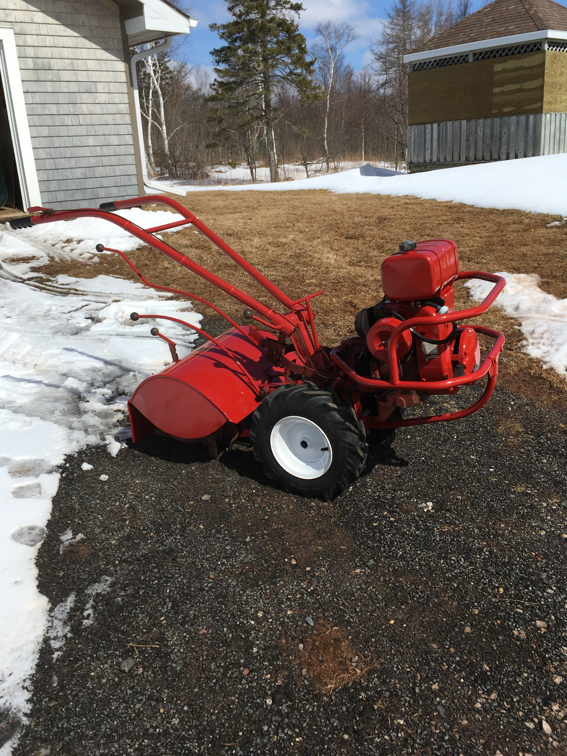

I picked up this one five years ago and it had sat outside since 1979 and needed new tires, rims and tines. Since the wheels were off I replaced the oil seals and added a new fuel filter and air filter. The rest was just paint. These old Troy Bilt tillers are built to last and need little maintenance. Mine sits all winter, and I add fresh fuel in the spring and she starts on the first pull.

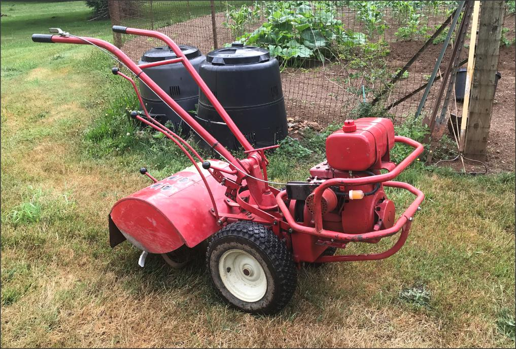

I agree about keeping & maintaining older Horse tiller.
Mine is 1976 model which I bought for $200 and did repairs like replacing shaft oil-seals, cleaning up carburetor & installing a new petcock and fuel filter etc.
