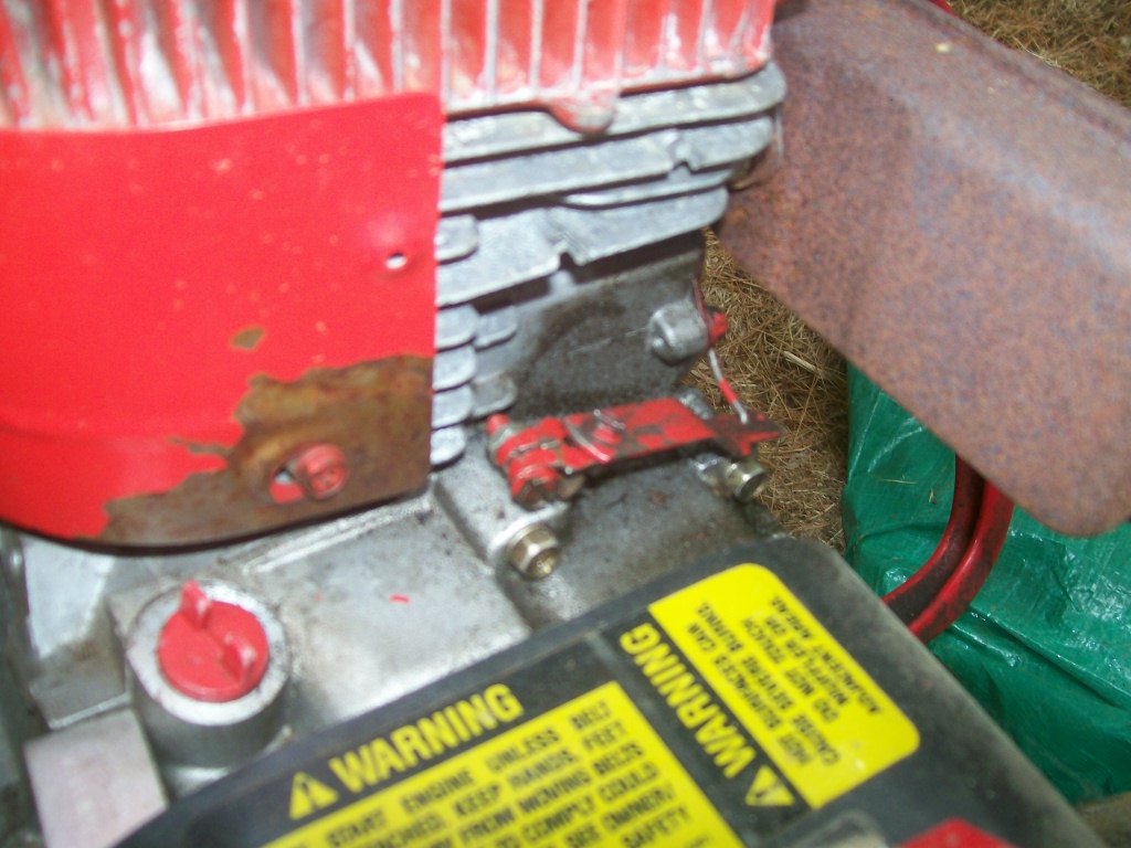

:D I went through the same thing when I put a short block on an old troy built econo horse. Eventually, I tried it upside down from the way I thought it should be, and it has worked fine since. Look at it closely, and see if it will go on the other way. If you need pics I can take some of mine, but it's out under a tarp by the far garden right now.

   / Troy built tiller with Tecumseh 6hp #4
Hope these photos help:

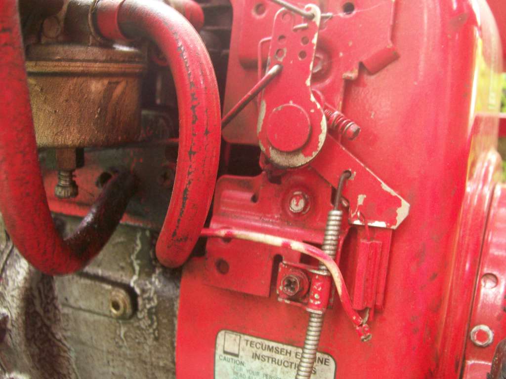

Well, I am aware that this is a possible issue, mine came without the carb and the linkage from that to the horse shoe shaped linkage on the motor was missing, I first observed that the motor came from a Ariens snow blower complete but missing the carb and the throttle rod. So I've compared it with some pictures and bent some hard wire to what I think is close. I've also tried to adjust the govener but have observed no difference is function/performance! I'm not exactly new to small engines and a horse power junkie, I figured this would be a no brainer but has tested my fortitude! The carburetor is nos and borrowed an air cleaner from an old mini bike I rode as a kid until I get another, it runs great just isn't governed.
   / Troy built tiller with Tecumseh 6hp #10
I have the Tecumseh 6hp HH60 engine, and had the same linkage problem. Turns out there needs to be a hard link between the carb throttle butterfly to the govener and a "soft" spring link to the throttle cable (for the governer to work, it has to be able to adjust and balance the throttle regardless of hard throttle position.) with a hard link all the way back to your throttle cable, the governer cannot control anything. in the attached picture, you can see the hard link that goes back to the governer at the top of the pic. right on top of that is the spring which attaches the throttle linkage to the butterfly valve on the carb. finding the right spring is the trick.tiller throttle linkage.jpg
