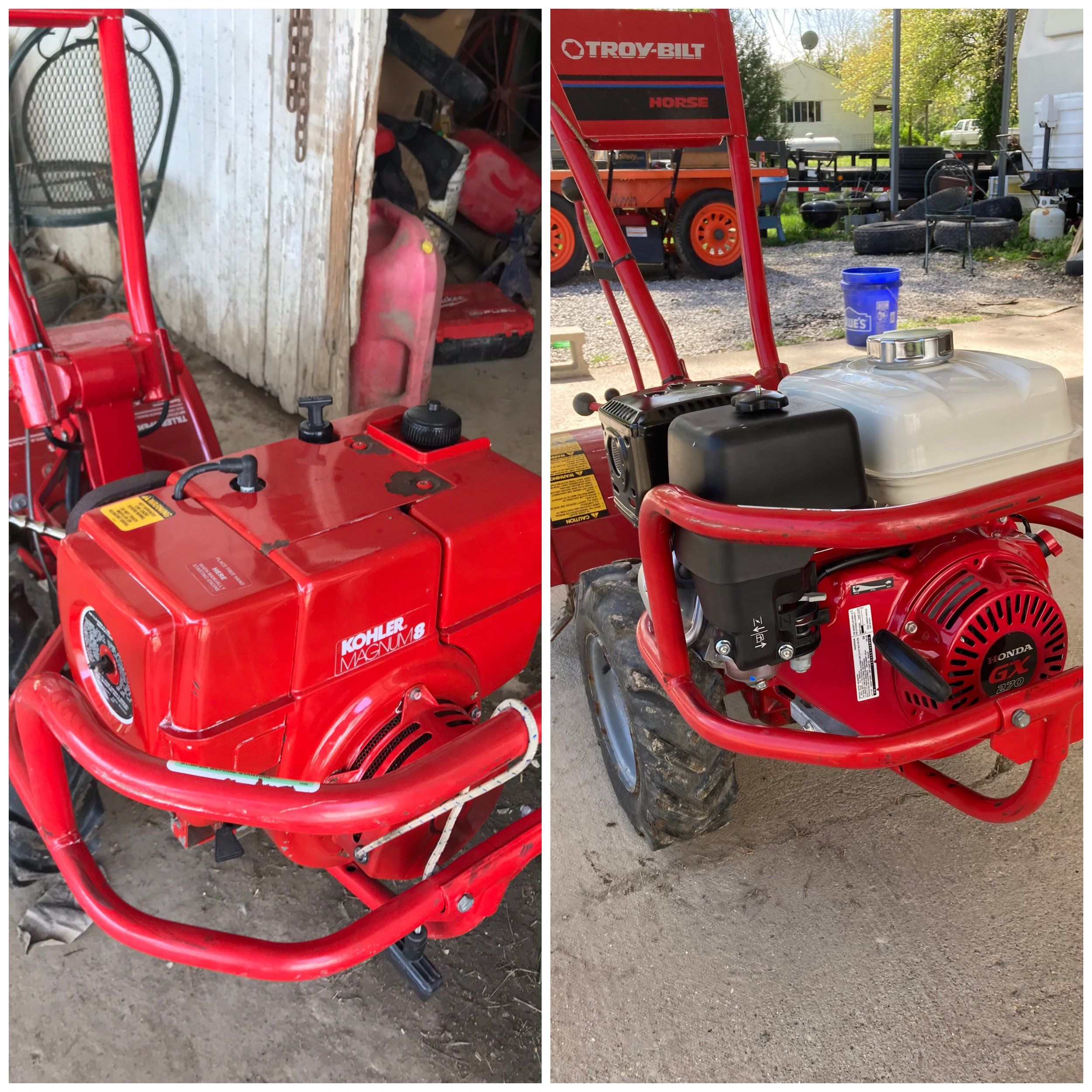

For sure. Just keep in mind not any Honda will work. Small Engine Warehouse makes a repower kit for the Horse. The crank is turned down to fit the top pulley. You might or might not need some shims to align both pulleys. Love those Honda engines
   / TroyBilt 8HP Horse Refurb
#52
For sure. Just keep in mind not any Honda will work. Small Engine Warehouse makes a repower kit for the Horse. The crank is turned down to fit the top pulley. You might or might not need some shims to align both pulleys. Love those Honda enginesView attachment 725141
Understood - but good to clarity for all. Nice comparison photos.
Looks like someone was yankin' on it...
Me, I'm a happy pooch with my electric starter working again.

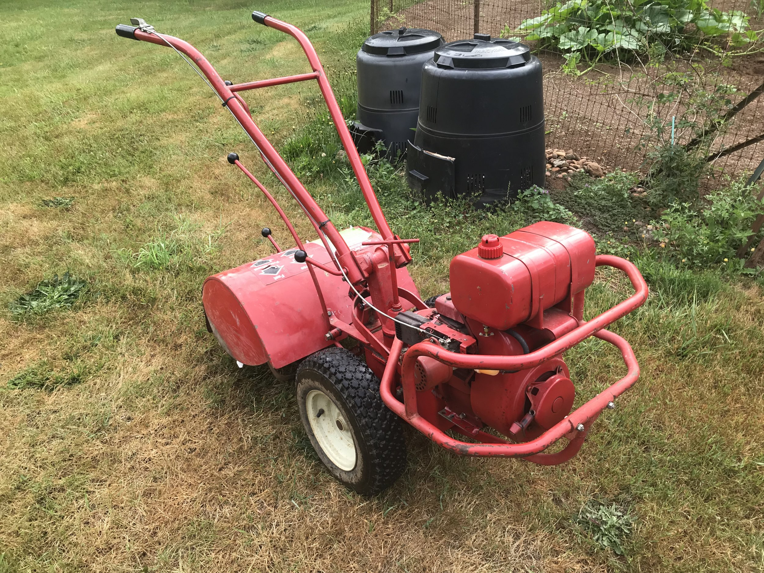

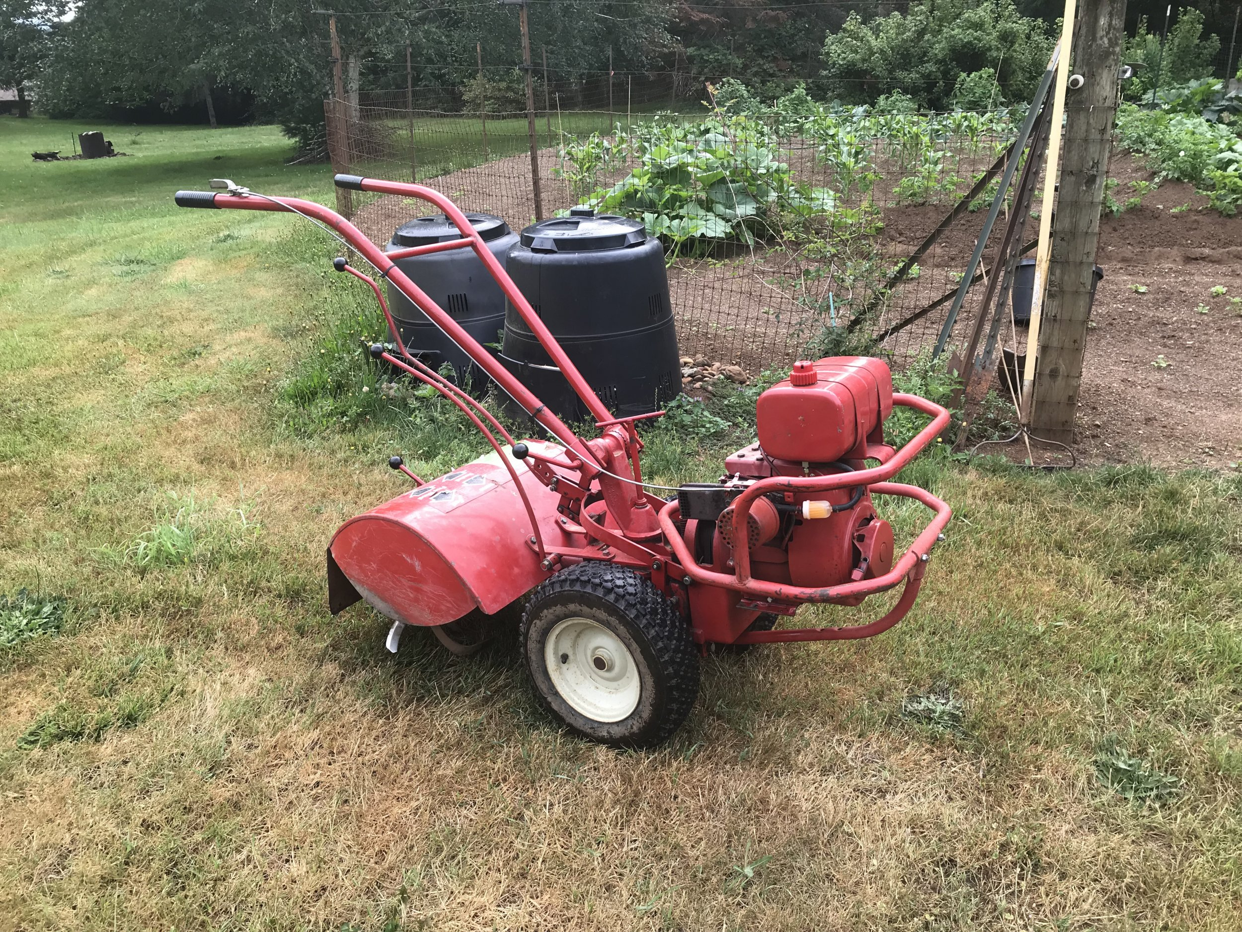

I bought this 1976 Horse with 6 hp Tecumseh little over two years ago for $200
Replaced a drive belt, wheel shaft & tine shaft oil seals, also added fuel shutoff valve & proper fuel filter and $10 carburetor from eBay, but other than that it's all original.
The engine starts easy and does not burn oil so the plan is to use it as is.
In other words:
The guy (math teacher) who sold it for $200 made the right decision to sell it because he was not interested (capable or willing who knows?) in doing the needed repairs and it would not have made sense to hire someone to do the work.
Cheers,

Same Tecumseh as mine with some very minor differences in 76 model and 78. In 78, Tecumseh changed the carb/intake to put a larger air filter on it with vertical orientation. The muffler on mine is quite different too. It's about half the size of a 1 lb coffee can and mounted with standard pipe fittings (the exhaust port is 3/4 NPT) instead of the little flat mufflers with a spark arrester. My folks paid $1000 for the Horse in '78, so you got a pretty good deal at $200, especially in that condition. IMHO, if folks don't want to take the time to learn how to fix their equipment, someone who does deserves a good deal. Just know when that Tecumseh gives up, you're not going to get parts from Tecumseh. It's a discontinued engine. I spent HOURS trying to find an alternate source. I didn't want to open it up and risk breaking something without recourse for replacements. But, as I said, the Predator 6HP engine from HF bolts right on. I like the nerf bars. That's about the only option my mother didn't get when she ordered it. Electric Start was available with the 8HP Kohler, but not the 6HP Tecumseh. I never considered anything under 10 HP to be worthy of an electric starter anyway. As I get older, though ....

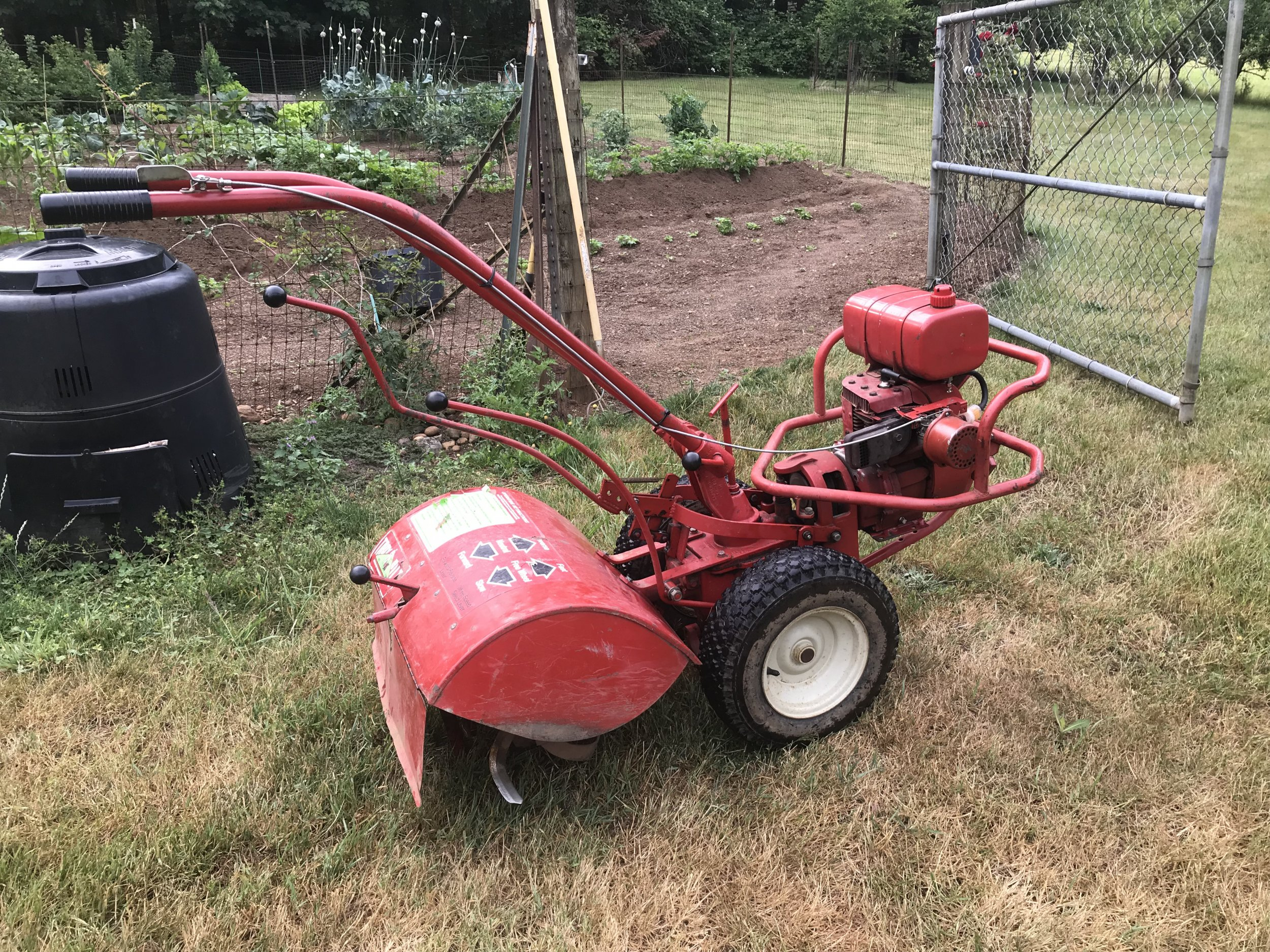

Enjoyed OldPaint's account of that machine's history, and his family's engrams imprinted on it, and now its future.
Recognize the '76 shown by art98607 as the model my Gramps had, and the first one I used.
