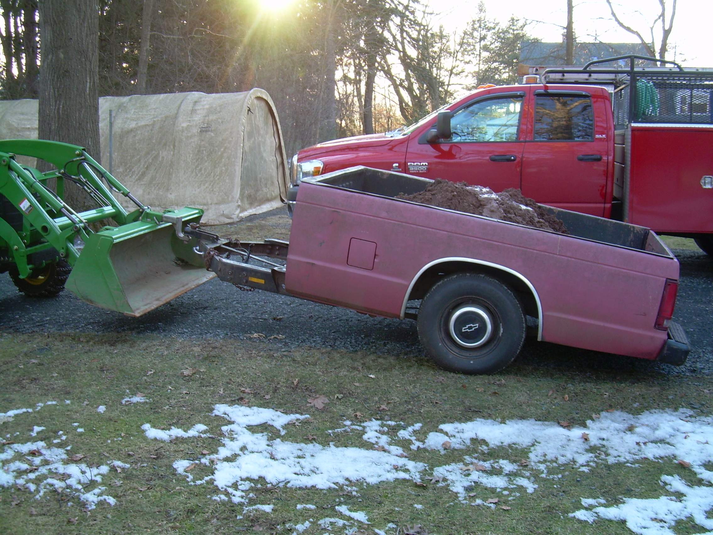

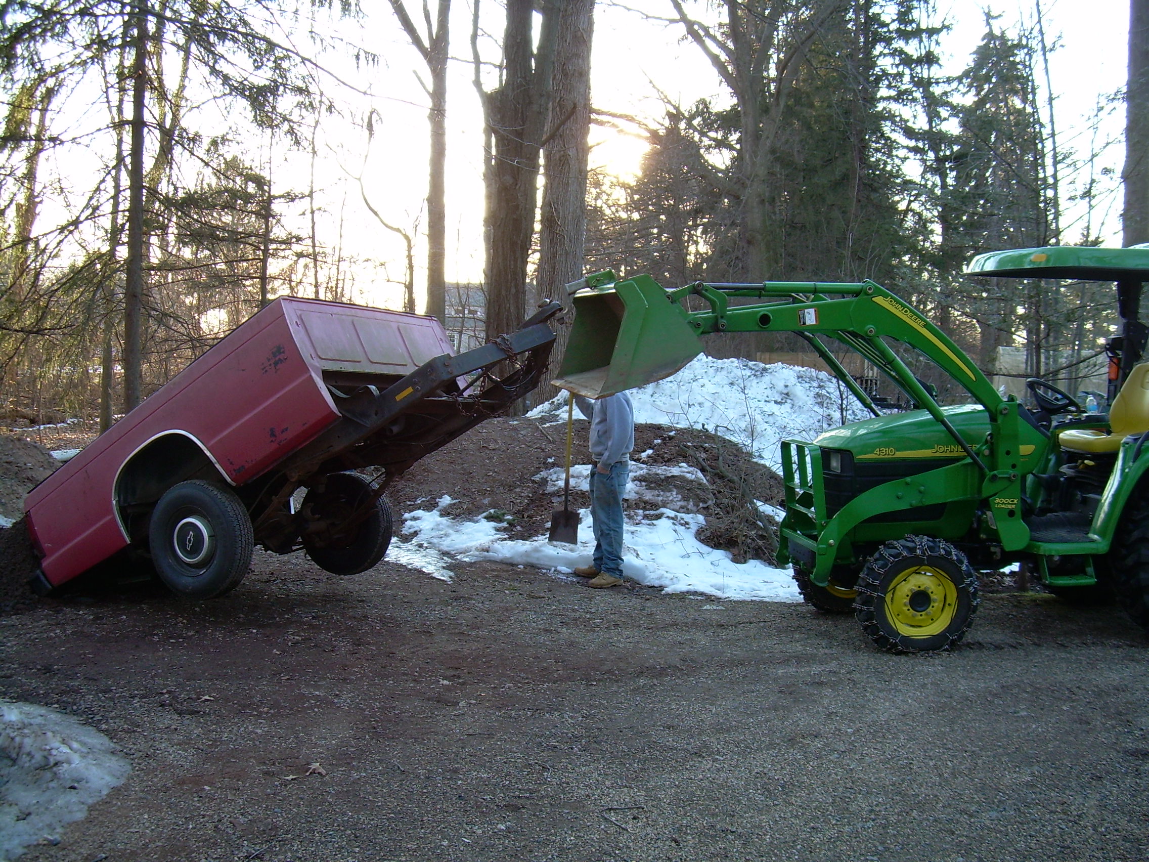

I made 2 of them over the years.
The first one out of a heavy duty 1+ ton DRW IH that was stuck/abandoned down in the woods. It was in a hard to get at spot, Took my torches in my old Power wagon and cut the frame as far forward as I could and dragged that thing out of there.
Bent the rails inward to make an A shape and fastened a coupler on. Just used it for utility work, dump runs etc. It was super HD, never saw the thick stack of springs squat, even with the heaviest loads I could put on it.
That was 30+ years ago and up til a few years ago I still saw it in the contractors yard I sold it to.
The second was an S-10 Chevy, that was 20 years ago and I still have it, it works great, I've overloaded that poor thing to where it was dragging on the ground, but it's still light enough to move around with garden tractor for yard work.
I use that little trailer more than my 5 ton dumper and get more comments on it every time I take it out. It was the perfect compliment to the K-5 blazer I had where I had the trailer painted the same color, even the reverse lights hooked up.
I never did anything with the rears, I never did any long distance towing and very little highway towing but for around town they work fine, a Poor man's solution for sure.

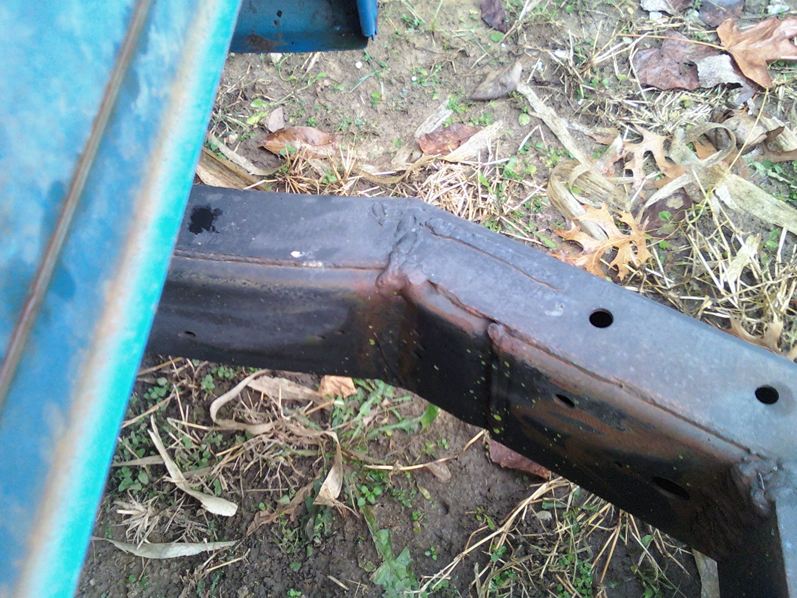

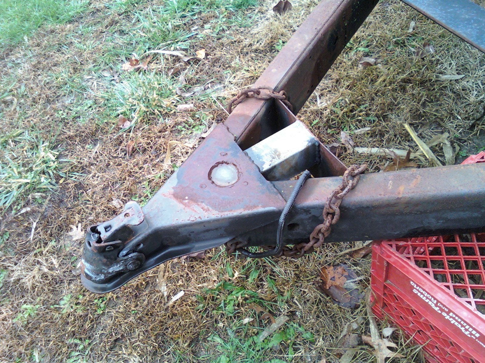

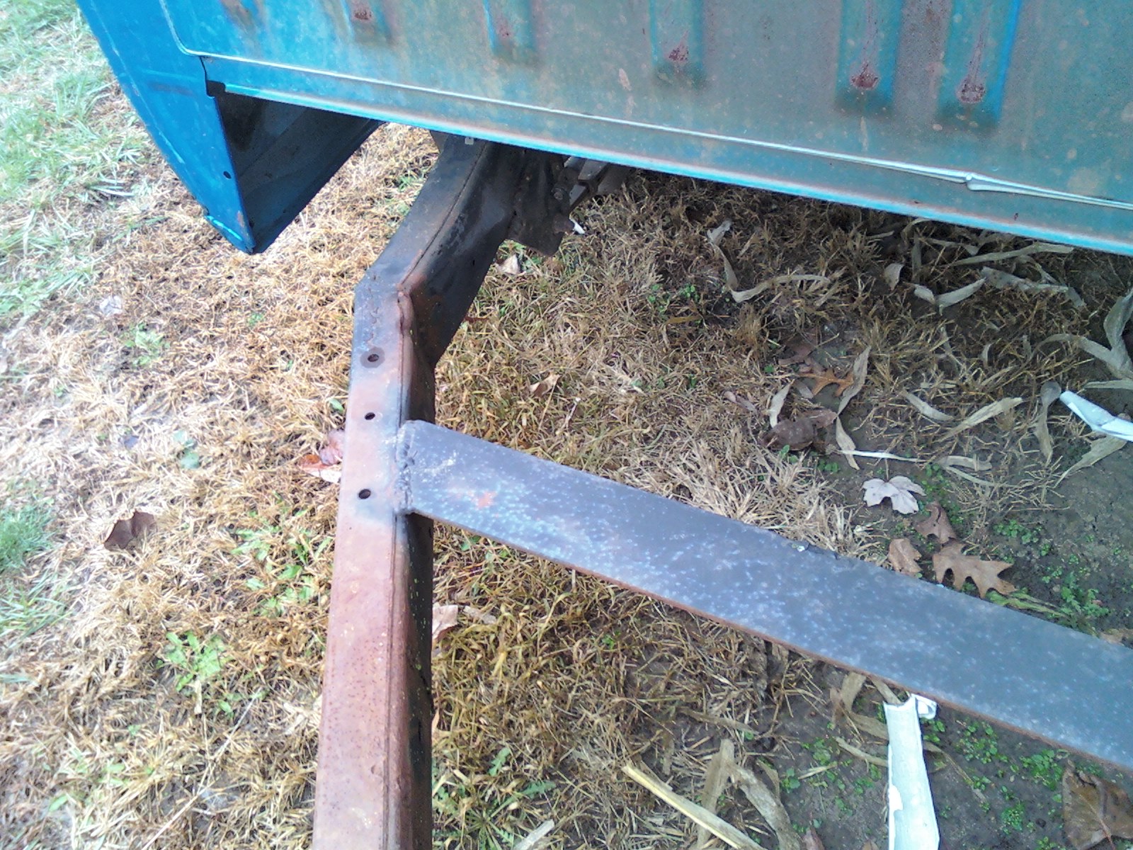

Here Are 3 pics of the tounge that i made on an old 70 somthing toyota.
I have pulled it at highway speeds with a load in it, and didn't have any problems with swaying. I now use it with a 200 gallon water tank init to pull around and water trees during the summer.
Frame was notched at the front of the bed, then bent in to center, I welded a hitch from TSC on it and a couple of braces in place and have beeen yanking it around for 10 years without a problem, other than needing to paint the frame again as it is starting to get some surface rust.
